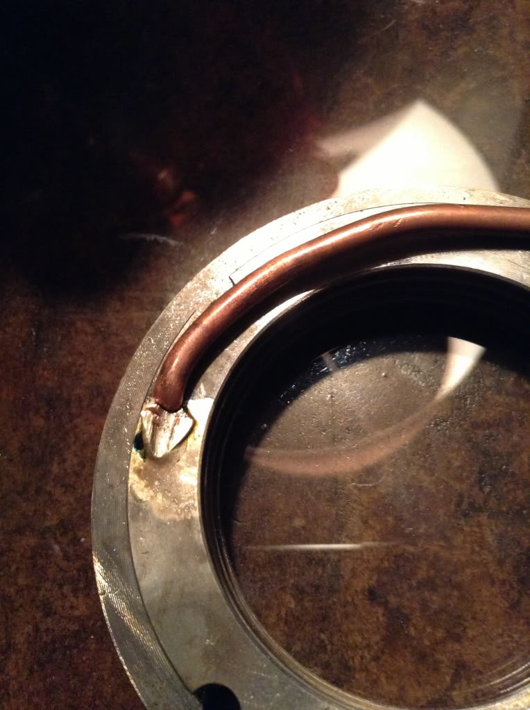

    Had a Front ARB locker and gears professionally installed about 4 months ago. After first using it I noticed a gear oil smell. After testing and using for a while I realized the diff was puking oil out the breather tube when engaged. I ran a bigger breather line and tested it and had a large amount of air leak when engaged.
    So the shop just took it apart and found it was the copper line leaking (out of the seal housing), there is a slight break near the top around one of the bends. The shop told me they had to bend the line in order for it to fit and lead out of the housing. They are a supplier of ARB products and talked them but ARB has no knowledge of these problems. The copper line is very weak and can easily break when bent, but has to be bent to fit out the housing.
    Because I bought the ARB on sale and gave them the parts to install they cant warranty the parts, cutting me a deal for the re/re and I also have to cover the replacement line/seal, about $120.
    Ive heard of other guys with leaks out of that copper tubing. Has anybody else had problems? Im def going to bring this up with ARB and try to get at least the part cost reimbursed.

    I have installed several ARBs, and in Tacoma's as well. Never had any issues with oil leaking, or a broken copper line. You have to take the time, and the care, to bend this line so that it doesn't cause any issues. The Tacoma front diff is one of the EASIEST front diffs to get the copper line properly bent and installed. Personally I would be telling the installer that if it has only been 4 months since they installed it, they should take care of it. Workmanship issue there. I am thinking the installer probably got into a hurry and didn't use the correct bending tool, or kinked it and hoped that it would not break. Pictures of the line would be nice.

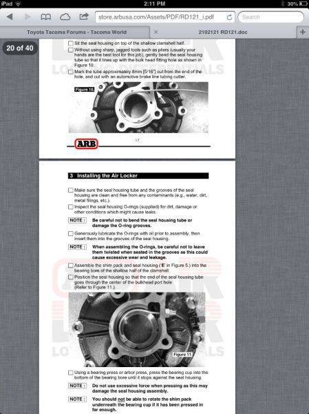

    Cool, thanks man. Ya it doesn't make sence that it would have to be bent very much after I read the install manual. I'm very interested to see what the line looks like on Friday.

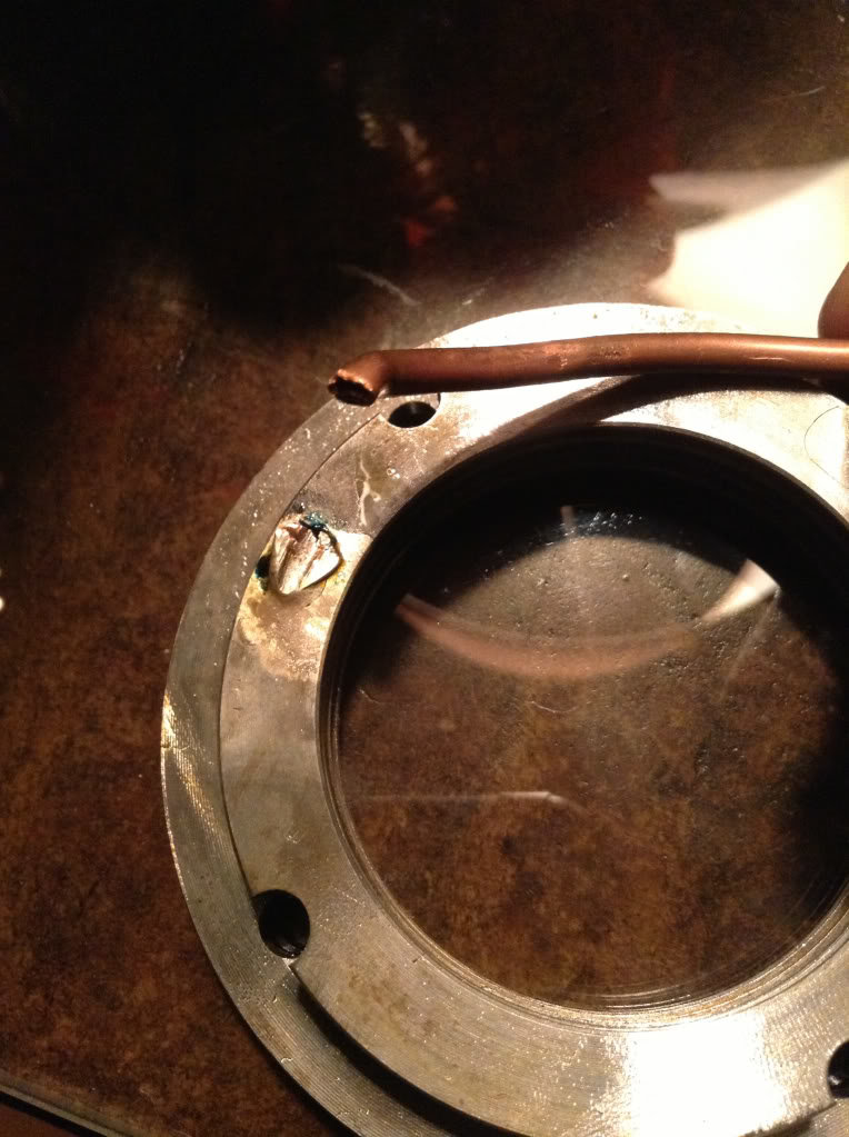

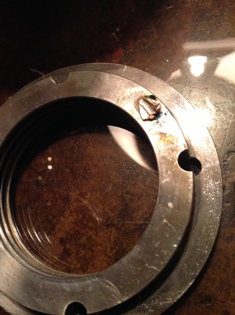

    So with the air line, it fractured right at the connection to the seal. They broke it taking it apart cause its pretty tight in there but the line had a tiny fracture in it where it is broken either from install or factory. They were very confident it was from factory. If you engage your air locker and you have air leaking or gear oil puking from the breather it is most likley the line is fractured like mine was. It's not common but it still does happen and just proves that any parts you buy no matter how good, isnt guaranteed to work perfect.
    I ended up paying for the part and some labour cause they didn't install the diff the first time but they did this time. Because I gave them the air locker to install, they didn't supply it, they couldn't cover the part which I understand. They did cover the large, rush freight charge, materials and all the labour fixing it. Its all good tho cause it works perfect now
