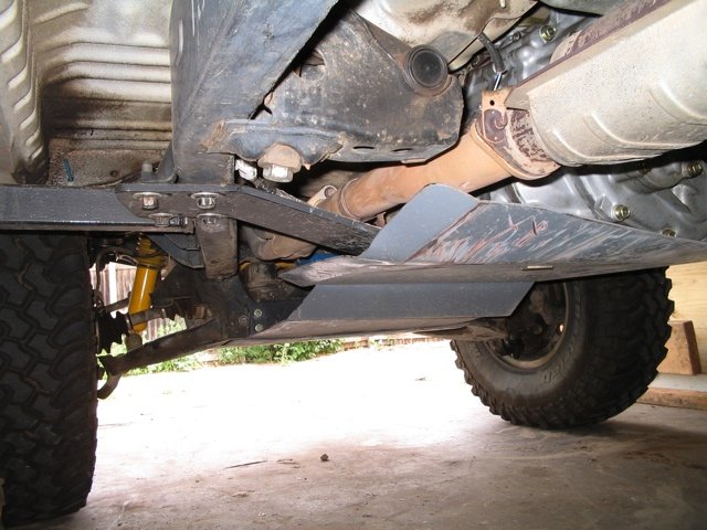

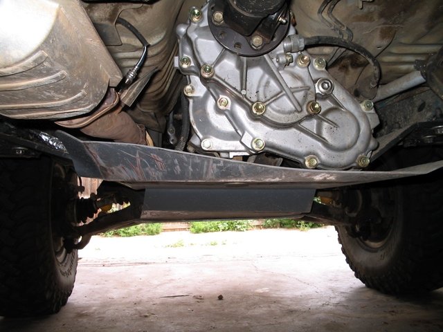

    This photo shows the original horse collar cross member for the transmission on my old 1991. I had the low profile Budbuilt but before I sold the truck I returned it more to stock.
    But I still have the supplemental cross member that ran approximately under the carrier bearing that I made at the last minute before Rubithon in 2008. And you are 100% right about the long rear driveline. That one piece of steel took more punishment than the front skids and sliders combined. Totally crucial.
    More photos of it.

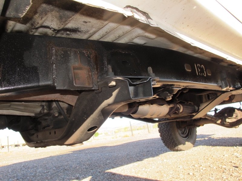

    This is what my skids looked like after the Rubicon.
    I ended up straightening and reinforcing the main skid with extra steel where it seemed most susceptible.
