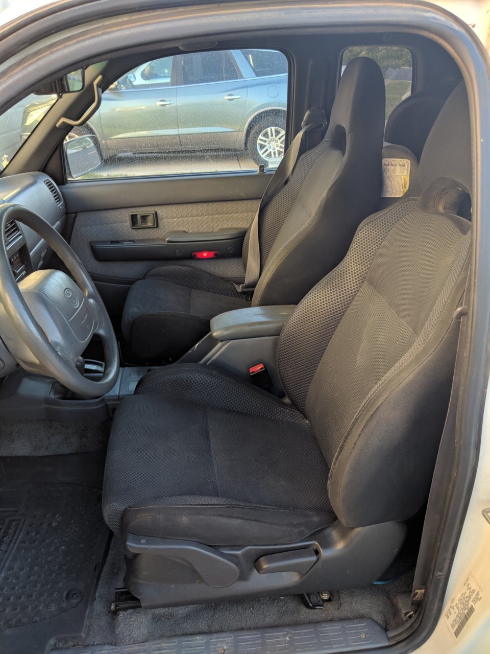

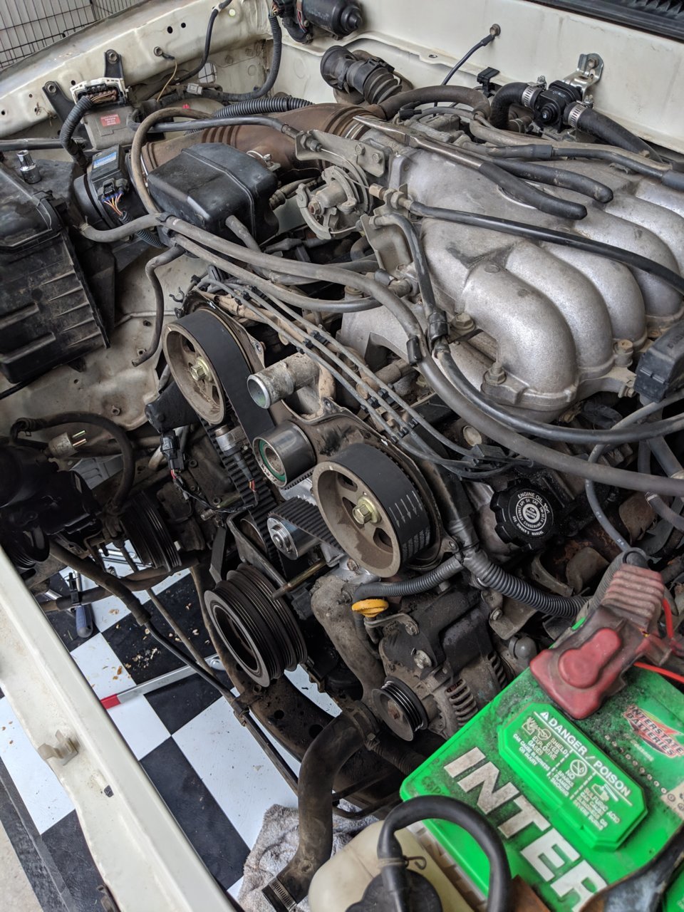

    Swapped out the tired old seat with seats out of an 07 WRX

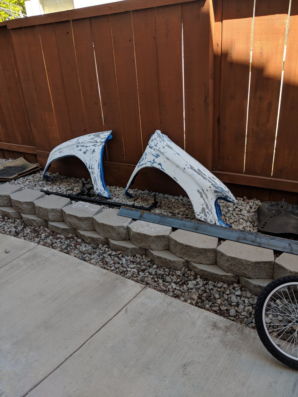

    Picked up some fenders off CL
    Did the timing belt et al:

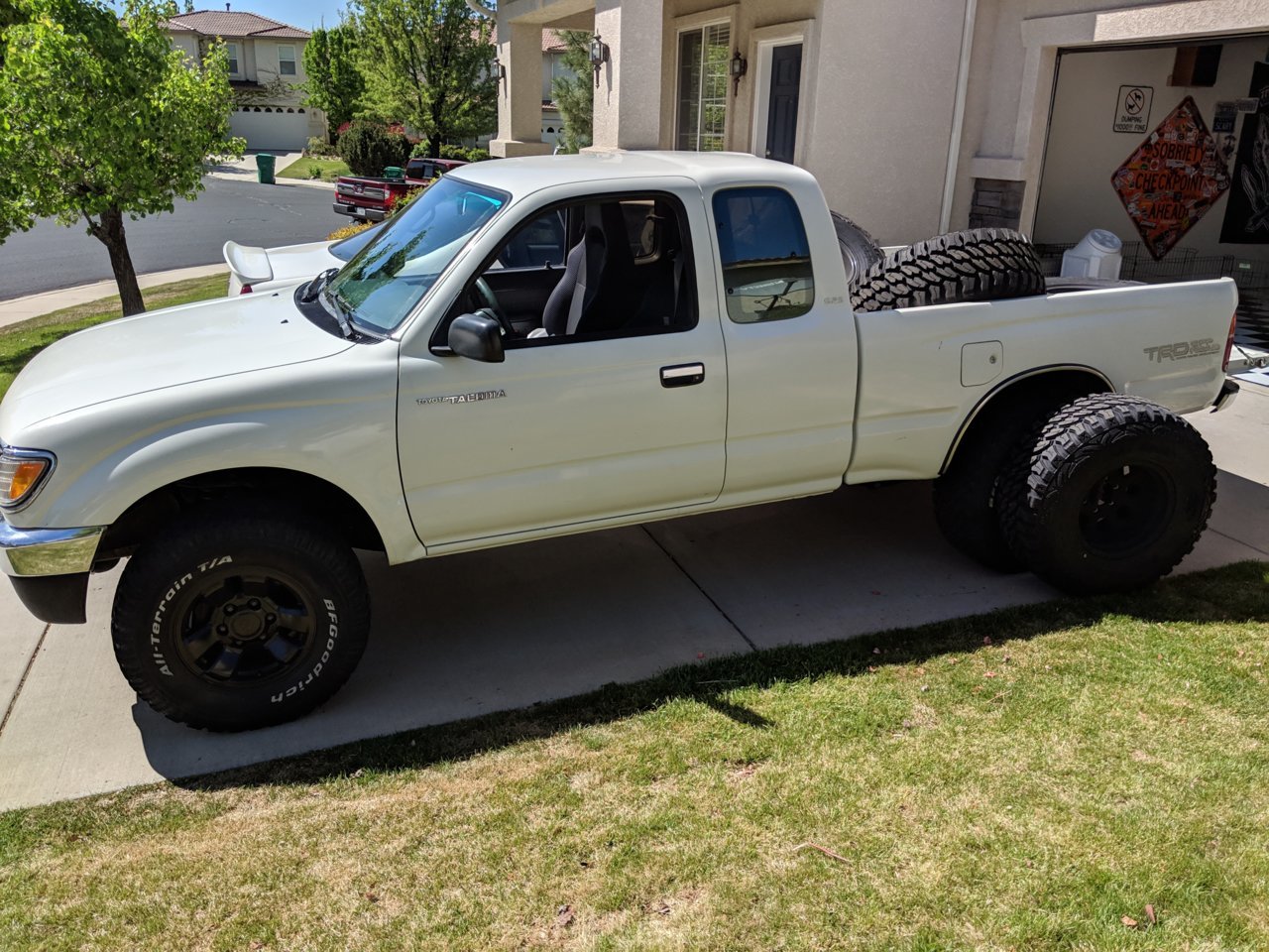

    NEW MEATS (OME 3 in not pictured yet):

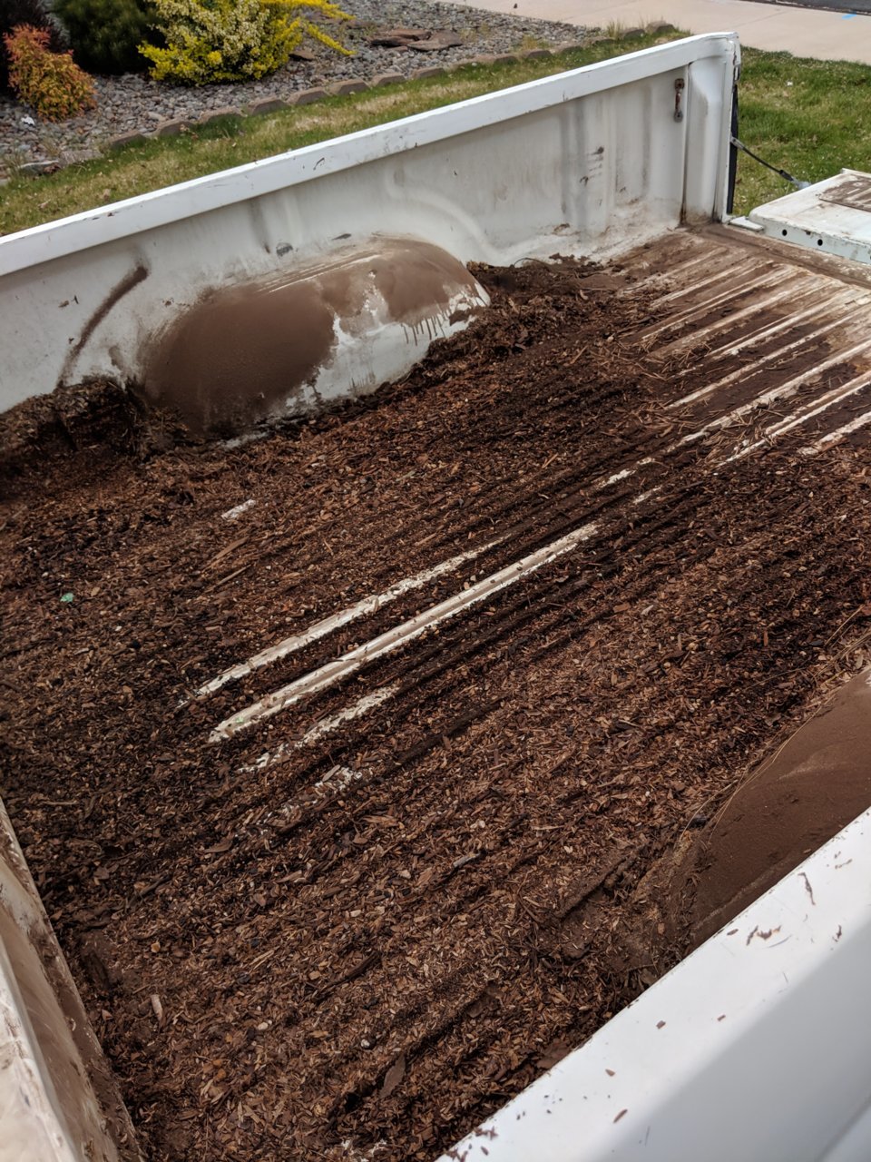

    Damn, there was a lot of crap under that plastic bedliner! Hopefully the bed is still in decent shape?

    Yeah, a little surface rust where the liner rubbed. After the OME install tomorrow, the fenders, trimming and other little crap, I'll hit it with rust prevention primer, then do the roll on bed liner and forget about it until I decide what I want to do with the bed.
    I like the bedsides option, but not sure if it's worth the trouble.

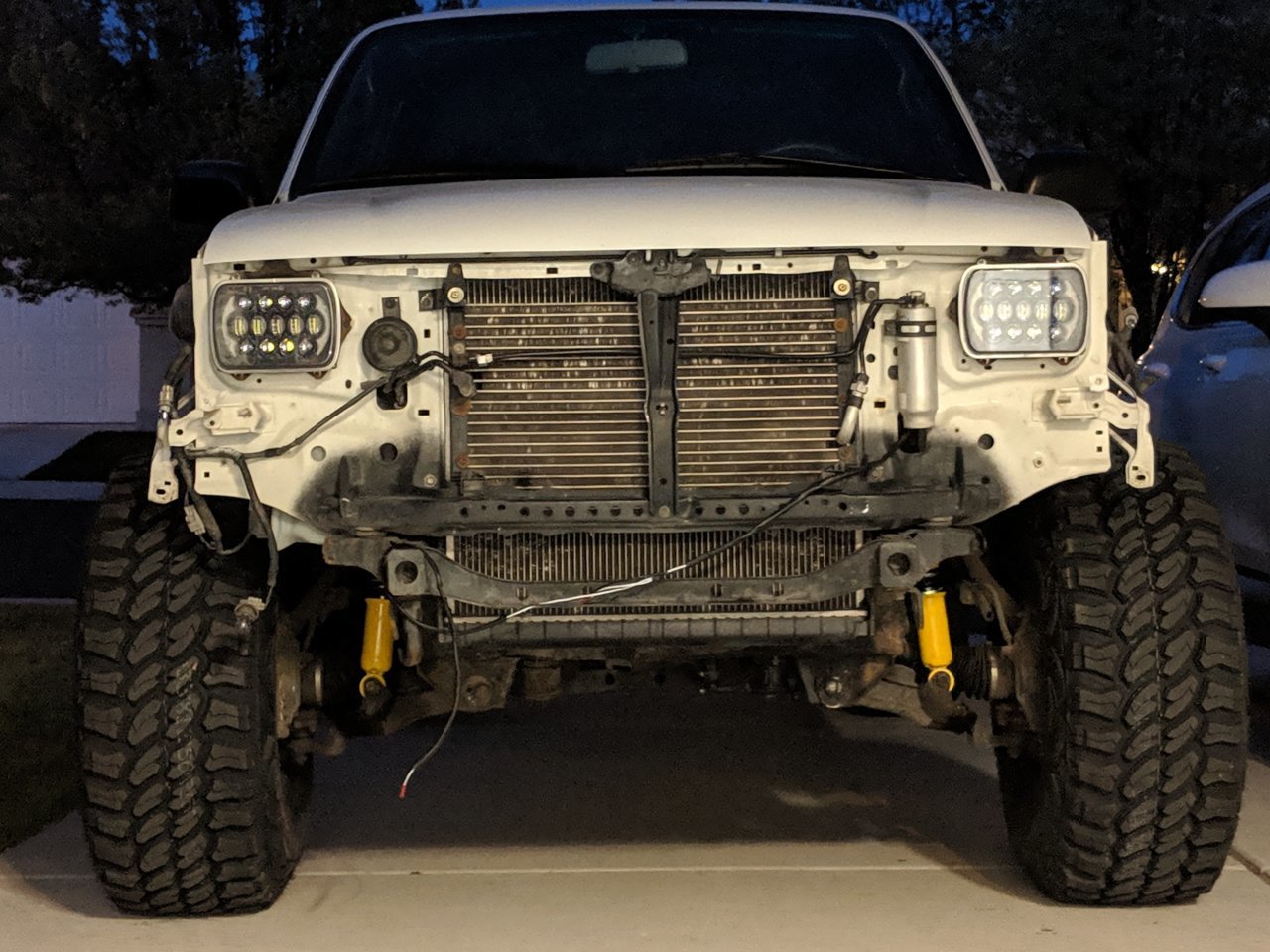

    Got the suspension in place... I'll get pics tomorrow, but these could very well be the stock shocks from 1997.
    Tomorrow, sanding and priming fenders. Then if I get lucky and nothing goes wrong, I'll hook up the sprayer and shoot some coats of white and a few coats of clear.
    Regardless, the labor intensive part is complete... Had to borrow the neighbor to get the damn lower coilover bolts slid into place. Nothing too bad, honestly, would been done earlier, but the golf course was calling my name.
    BTW, eff trying to get those poly shock bushings in. That sucked.

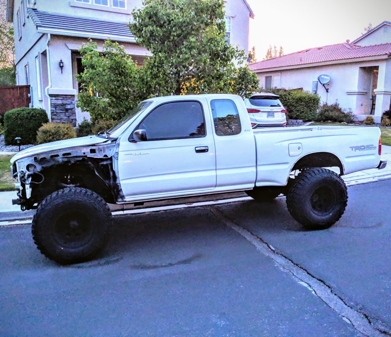

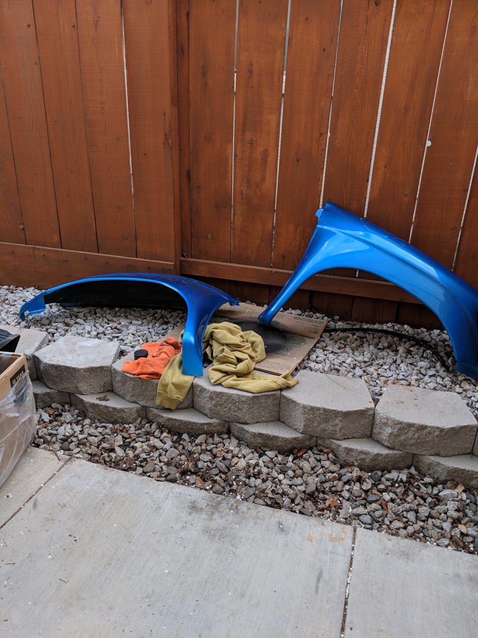

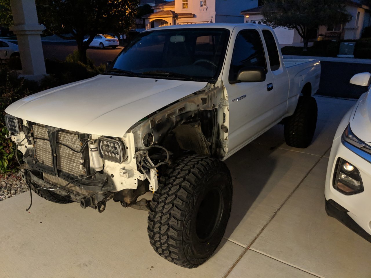

    Fiberglass fenders need more filler and sanding, so I just trimmed the stock fenders until glass is ready.
    It's back together again for now.
    Sooooooo much rubbing at full turn, but nothing on the frame, all inner fender. Yay, no spacers needed.
    However, won't shift into 4x4. T-case engaged, but no front power. Time to go look for an actuator or fork I suppose.

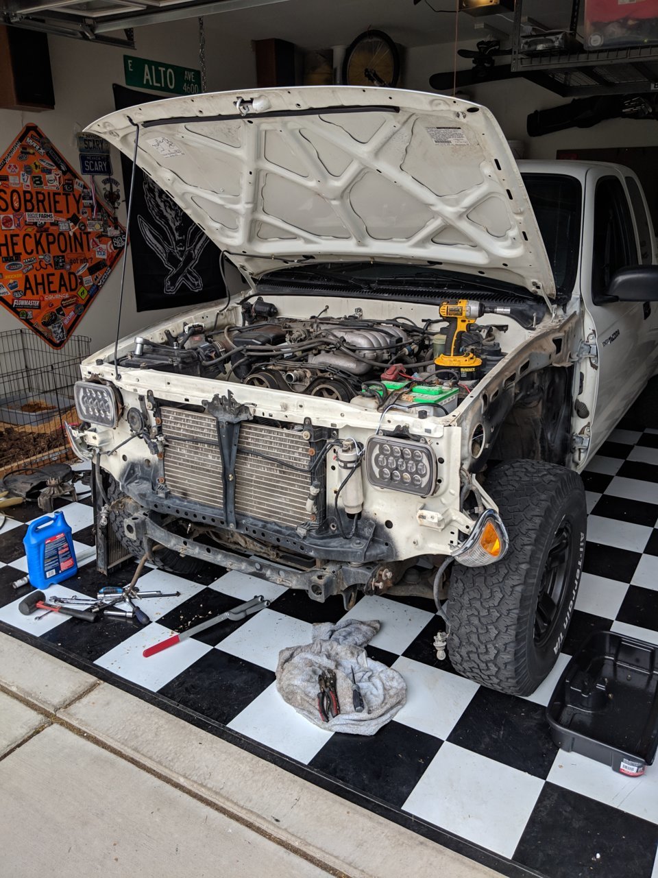

    Whelp, I'm an idiot.
    When I pulled the ADD to check for functionality, I didn't get it back on the shift collar obviously, because 4x4 isn't giving power to the front.
    Gawdammit!
    Ordered wheel bearings, upper control arms, lower ball joints and CV shafts, and a used actuator off ebay, so I'll just let it sit for awhile until I can drop the diff and do everything properly.

    What size tire and rim are you using? Those are sticking out pretty far.
  9. May 11, 2019 at 6:42 AM
    esxcli
    esxcli [OP] Keyboard Warrior
    Jun 25, 2018
    #257452
    1,040
    Sean
    Reno NV

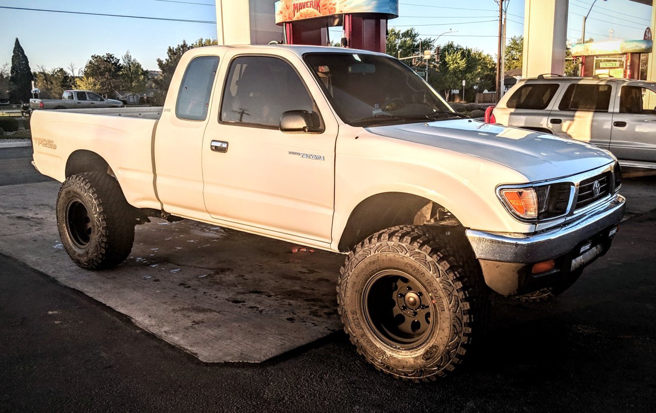

    Yeah, did that to match the outside of the fiber fender. Which... BTW, I finally stuck back on today, gonna look to have them sprayed soon as well.
    As far as the wheels:
    • Wheel Size: 15x10
    • Bolt Pattern: 6 on 5.5
    • Backspace: 3.625
    • Offset: -47
    chrslefty[QUOTED] likes this.

    33 12.5 ProComp MTs. They're beefy as hell. I've done some light cutting, and popped the inner fender with the sledge a bit. As soon as I get zero rubbing I'll line the inside and consider that bit done.
    These were a Craigslist find. 6" Hannemann fenders from guy I ended up knowing from running the Rubicon in my Jeep crawler days. He never even ended up drilling them for mount.

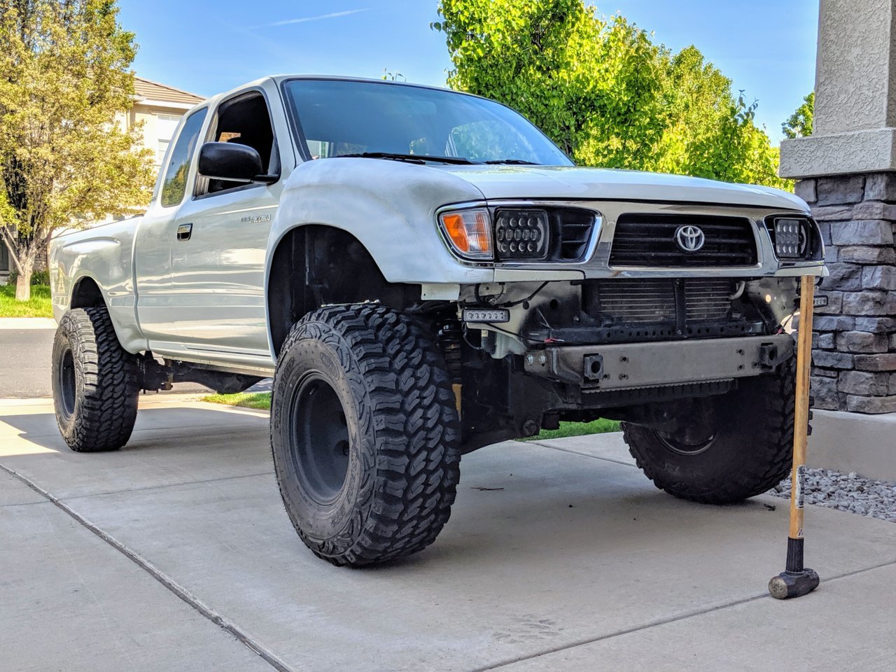

    Until paint, this is how it sits. I am using the rock guard bumper mount to fab my front bumper. Also got some square stock to do the rear.
    Still waiting for parts to come in to drop the differential and fix the ADD while doing control arms, lower ball joints, bearings and half shafts. Wooooooo!IMG_20190510_161431.jpg

    I am waiting on the damn half shafts, but everything else is here. I was going to reuse the hubs and just take them to buddy at machine shop for the new ones to press in... However, I live so close to Summit Racing and saw they had hubs in stock for 20% mother's day discount, I went and got them with inner and outer oil seals.
    As soon as these damn axles are here, I can make this front end like effin new again and worry more about welding up the rest of my bumper.

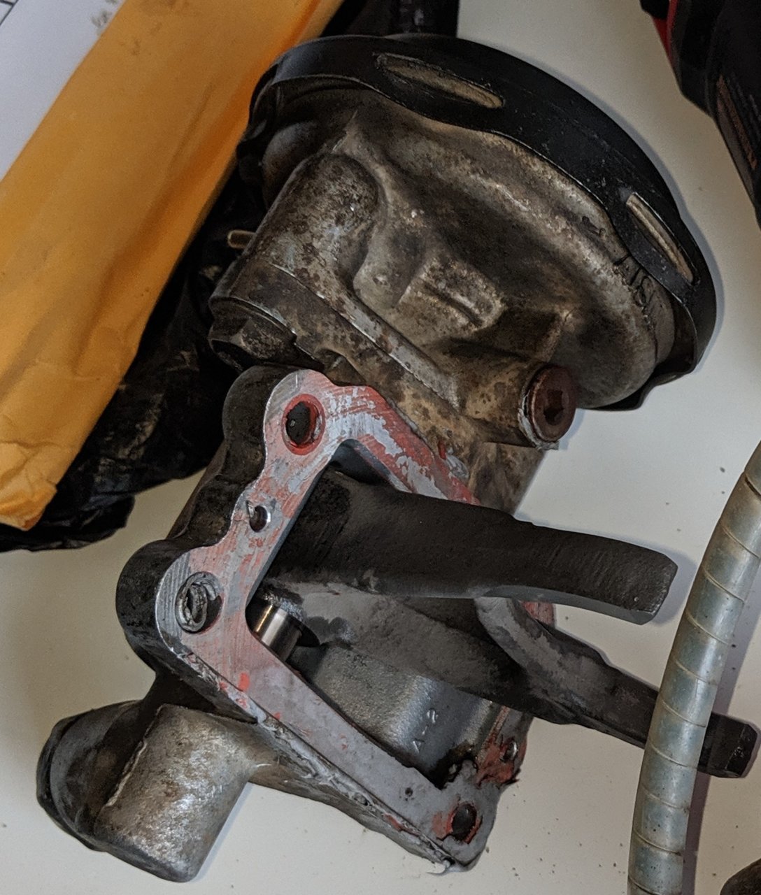

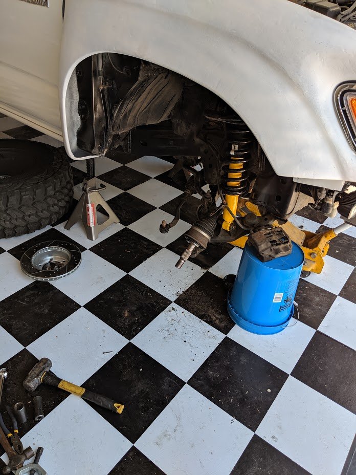

    I had a bit of time for lunch.... orrrrrrr, run home and remove the knuckles and everything that requires a press to get in.
    Mission accomplished.

    Thanks to @Reh5108 for leading me down the right path of "fuck this part"
    I enjoy removing complexity from things... This allows me to do so. :)
    Seriously, fuck that vacuum actuator.

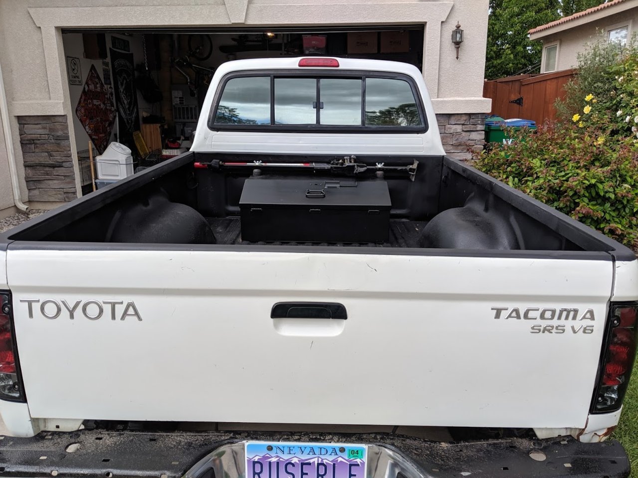

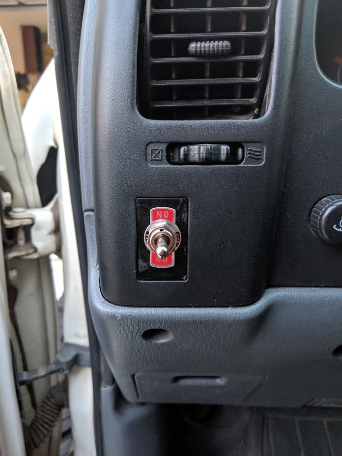

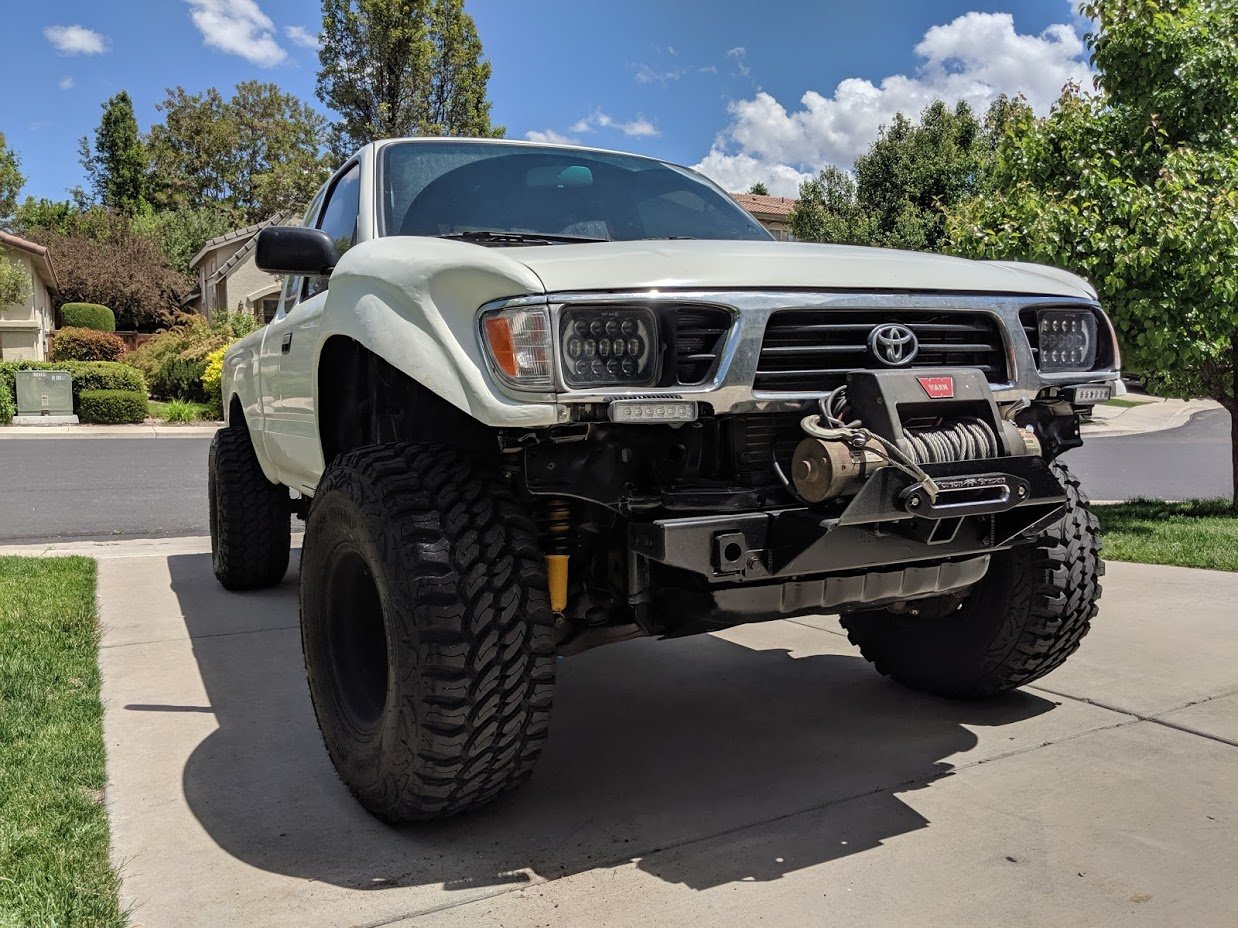

    Added a tool box from a repurposed security deposit box:

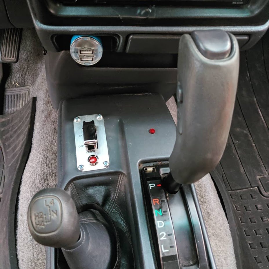

    Added a x8000i with in cab control:

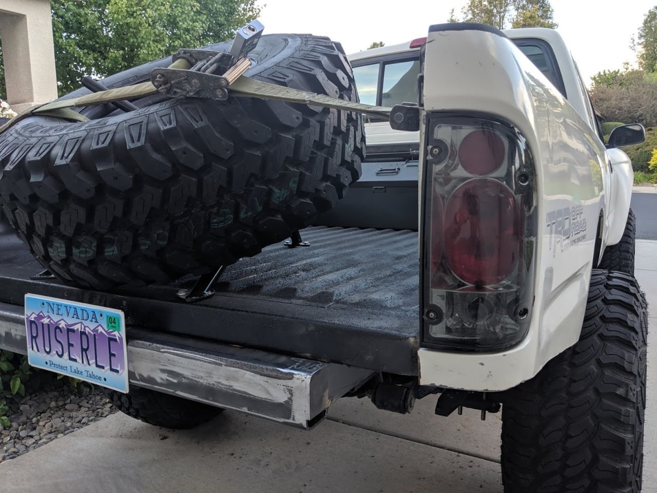

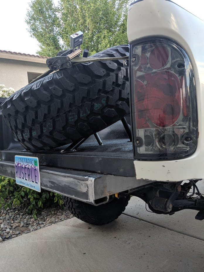

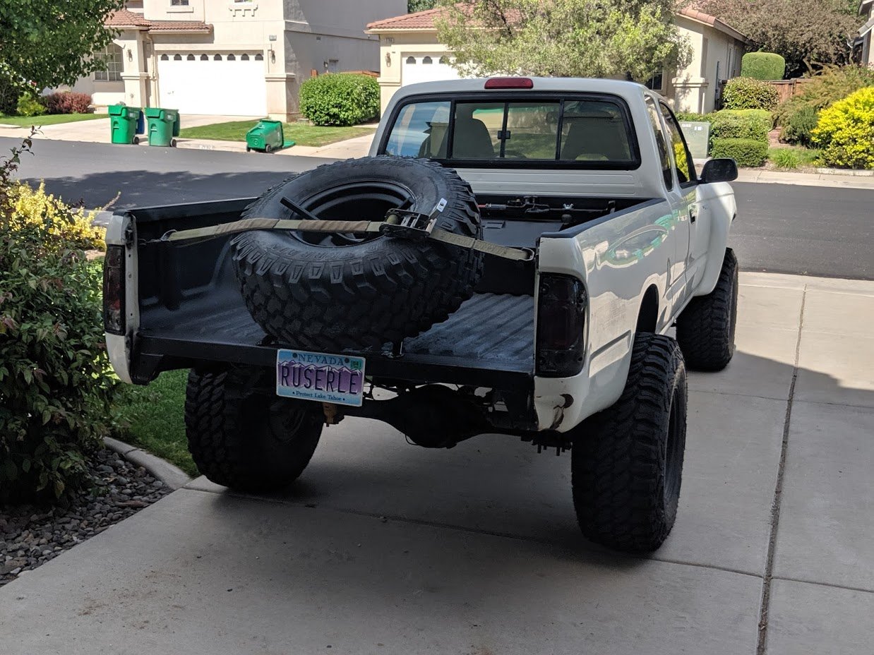

    Added a spare tire carrier and gutted the rear of the bed for bumper fab:
    Took the boys wheelin and watched them run around to find rocks at the crystal mine:
