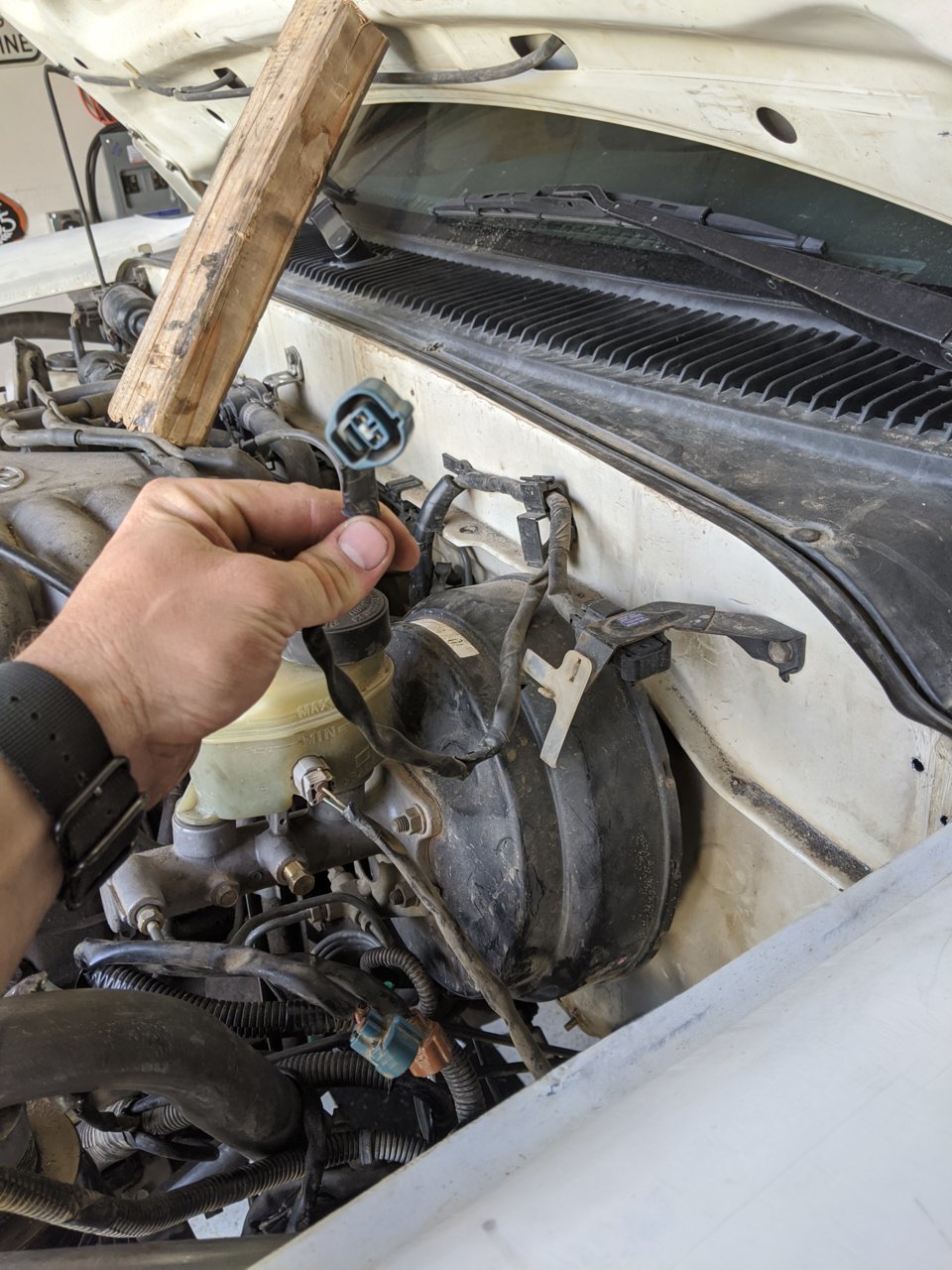

  3. May 9, 2020 at 6:39 PM
    #203
    esxcli
    esxcli [OP] Keyboard Warrior
    Jun 25, 2018
    #257452
    1,040
    Sean
    Reno NV
    Added fluids, put gas in. Turns over and runs for half a second then bleh.
    I think I got the wrong pump. My pump is 45psi and 80lph. While this translates to the 10gph per 100whp, but I think that translation is for carb. Maybe not enough volume for the 3.4 EFI...
    Also, anyone know what this connector is? Maybe that's the problem? I'm lost right now.

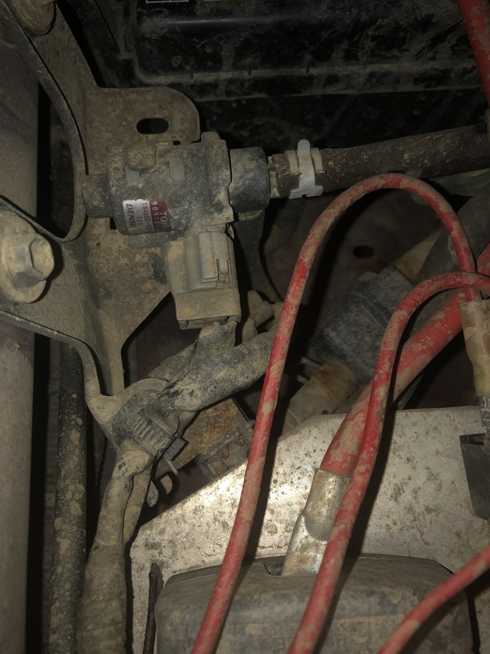

  4. May 9, 2020 at 7:45 PM
    #204
    avw4x4
    avw4x4 Well-Hung Member
    Oct 20, 2013
    #114886
    2,414
    (M)Andrew
    Rochester, NY
    2003 Yota
    ...loading....
    Mine plugs into something made by Denso that has a tube running to it to the air box. Honestly not sure what it is, some sort of air/fuel mixture thing maybe?
  5. May 9, 2020 at 9:09 PM
    #205
    esxcli
    Jun 25, 2018
    #257452
    1,040
    Sean
    Reno NV
    Hah, tyty! I found out. Had a buddy just swing by and I traced all of it. Just goes to the smog canister. Good to go now.
    I mean, still won't start, but I have more ideas.

  6. May 10, 2020 at 12:47 PM
    #206
    Running Board Man
    Running Board Man Well-Known Member
    Feb 19, 2017
    #211024
    8,802
    Looks like you have the newer charcoal canister setup and its in the area so it could be for that
    Thats a plug for a vsv
    esxcli[QUOTED][OP] likes this.

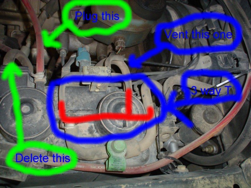

  10. May 10, 2020 at 4:47 PM
    #210
    esxcli
    Jun 25, 2018
    #257452
    1,040
    Sean
    Reno NV
    I kept everything for registration renewal smog check. Found this on pirate4x4. How to get around the stupid shit.
    slander, POOLGUY and avw4x4 like this.

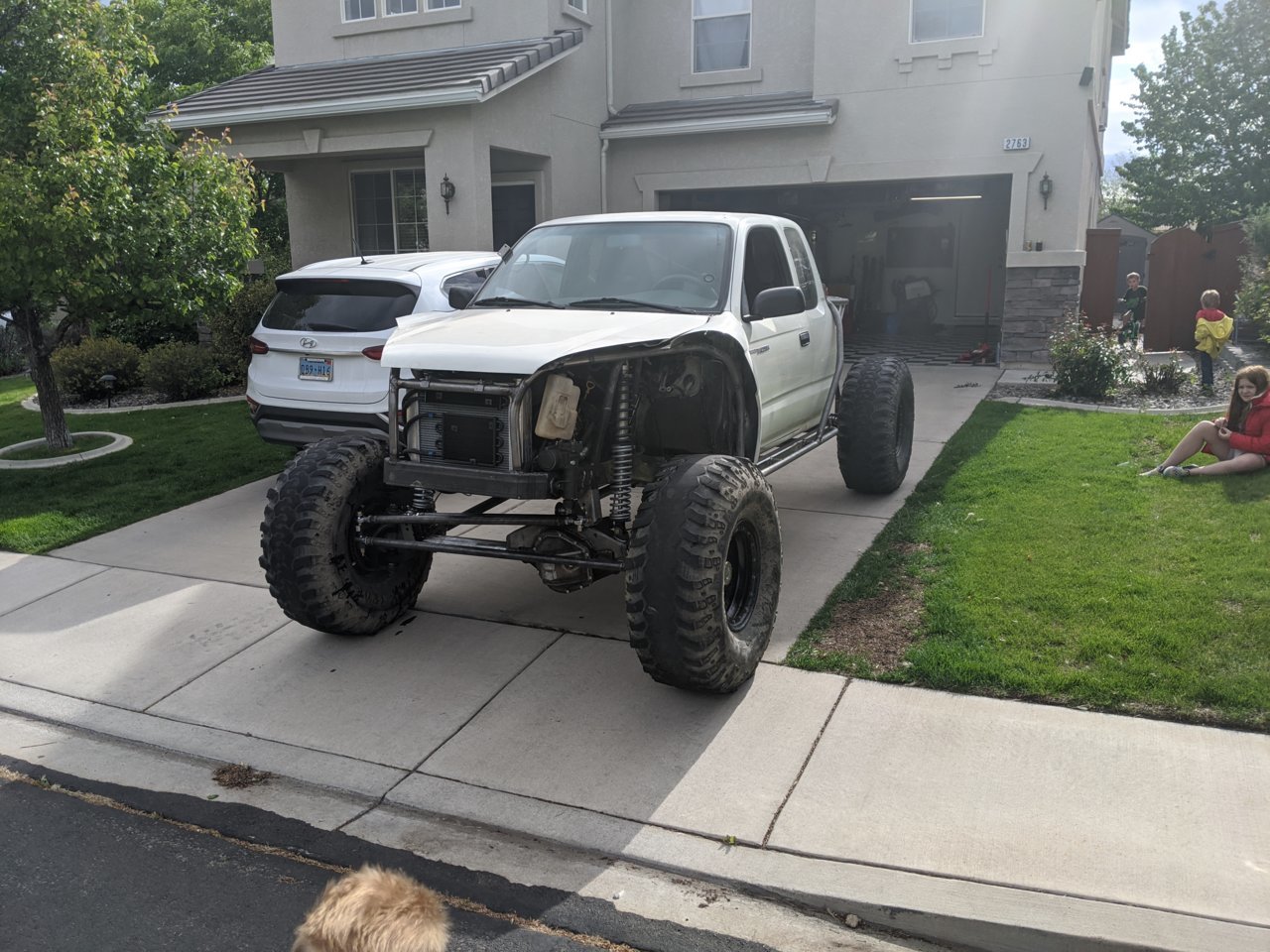

  13. May 11, 2020 at 9:07 PM
    #213
    esxcli
    Jun 25, 2018
    #257452
    1,040
    Sean
    Reno NV

  15. May 12, 2020 at 9:24 PM
    #215
    esxcli
    Jun 25, 2018
    #257452
    1,040
    Sean
    Reno NV
    Lol had 20 min today, fuck this shit.

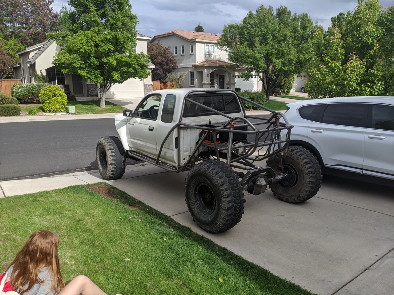

  16. May 13, 2020 at 8:33 PM
    #216
    esxcli
    Jun 25, 2018
    #257452
    1,040
    Sean
    Reno NV

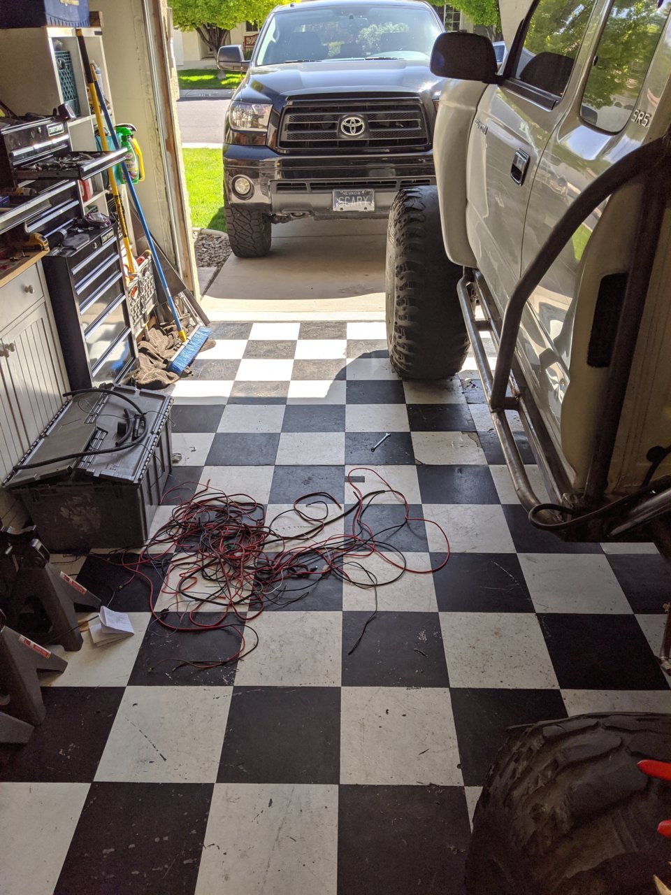

  17. May 14, 2020 at 7:24 AM
    #217
    Snowy
    Snowy Is neither here nor there
    Feb 5, 2014
    #122349
    3,465
    Connor
    Winnebago, IL
    3 linked 98 Xtra cab
    Stock-ish
    Not much is better than rolling something out of the garage for the first time. Doesn't matter if it runs, but just seeing it out is always a bunch of motivation for me.
    Nice build
    esxcli[OP] likes this.
  18. May 14, 2020 at 7:53 AM
    #218
    esxcli
    Jun 25, 2018
    #257452
    1,040
    Sean
    Reno NV
    Dude, driving it out of the garage was one of the best feelings I've ever had. I half expect it to just blow up in a ball of flames.
