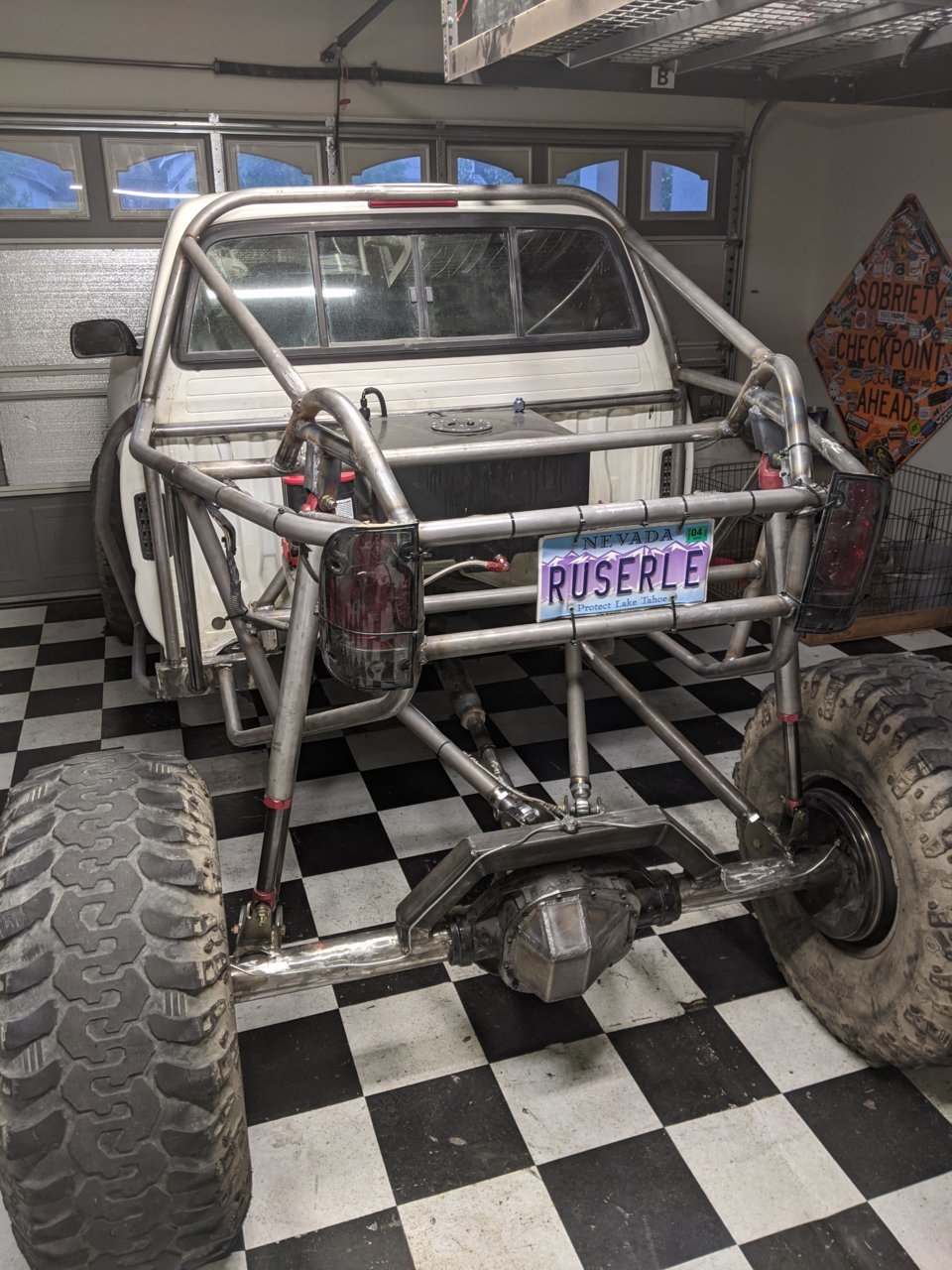

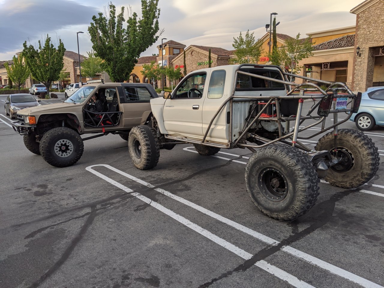

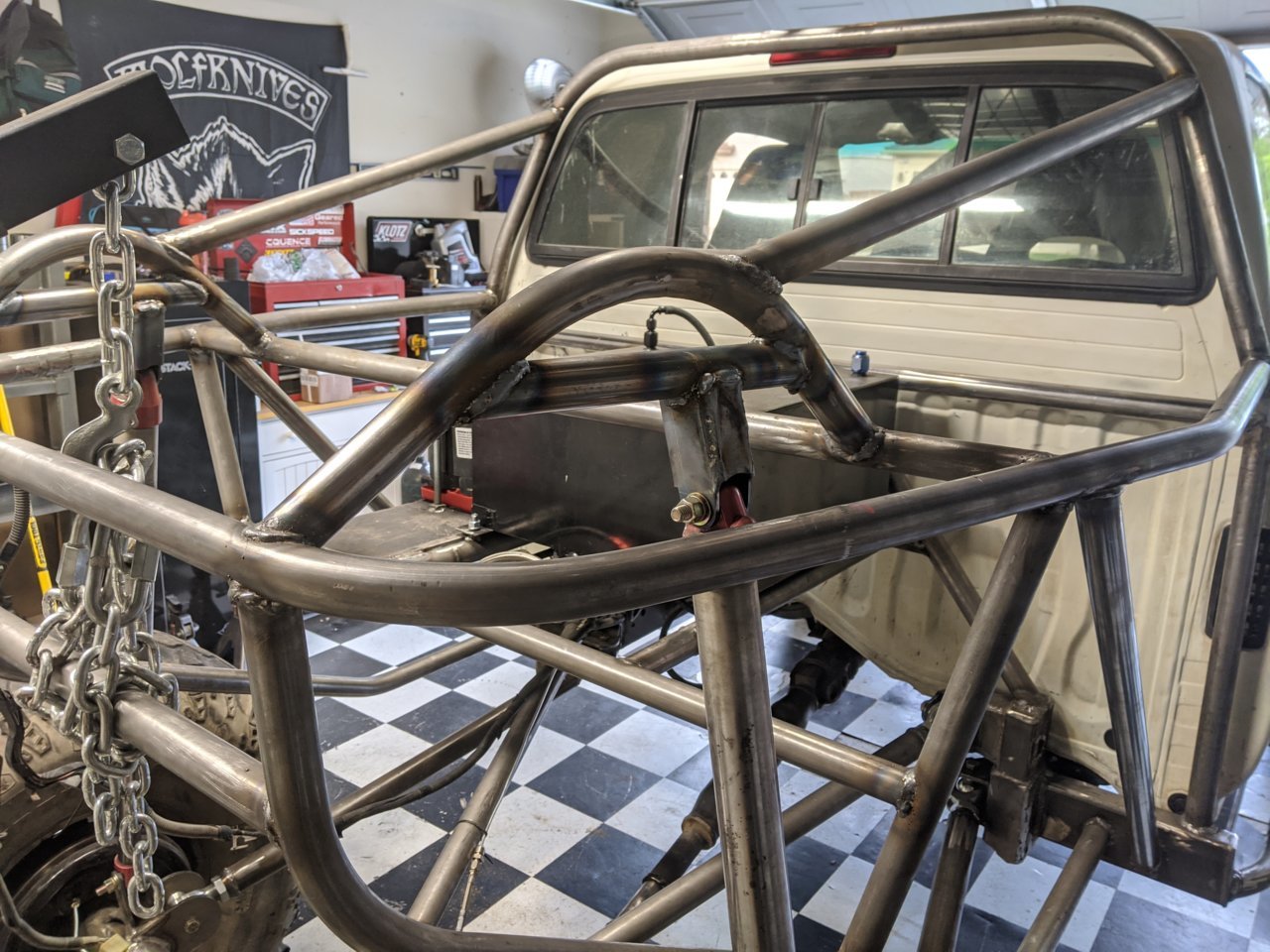

    Leveled out the rear because 5th time. Started front shaft, needs 6 more inches (twss). Hung out with my garage pet, "Penny"

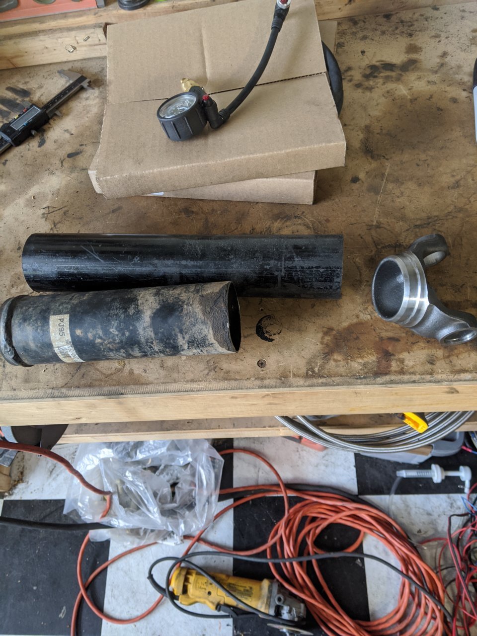

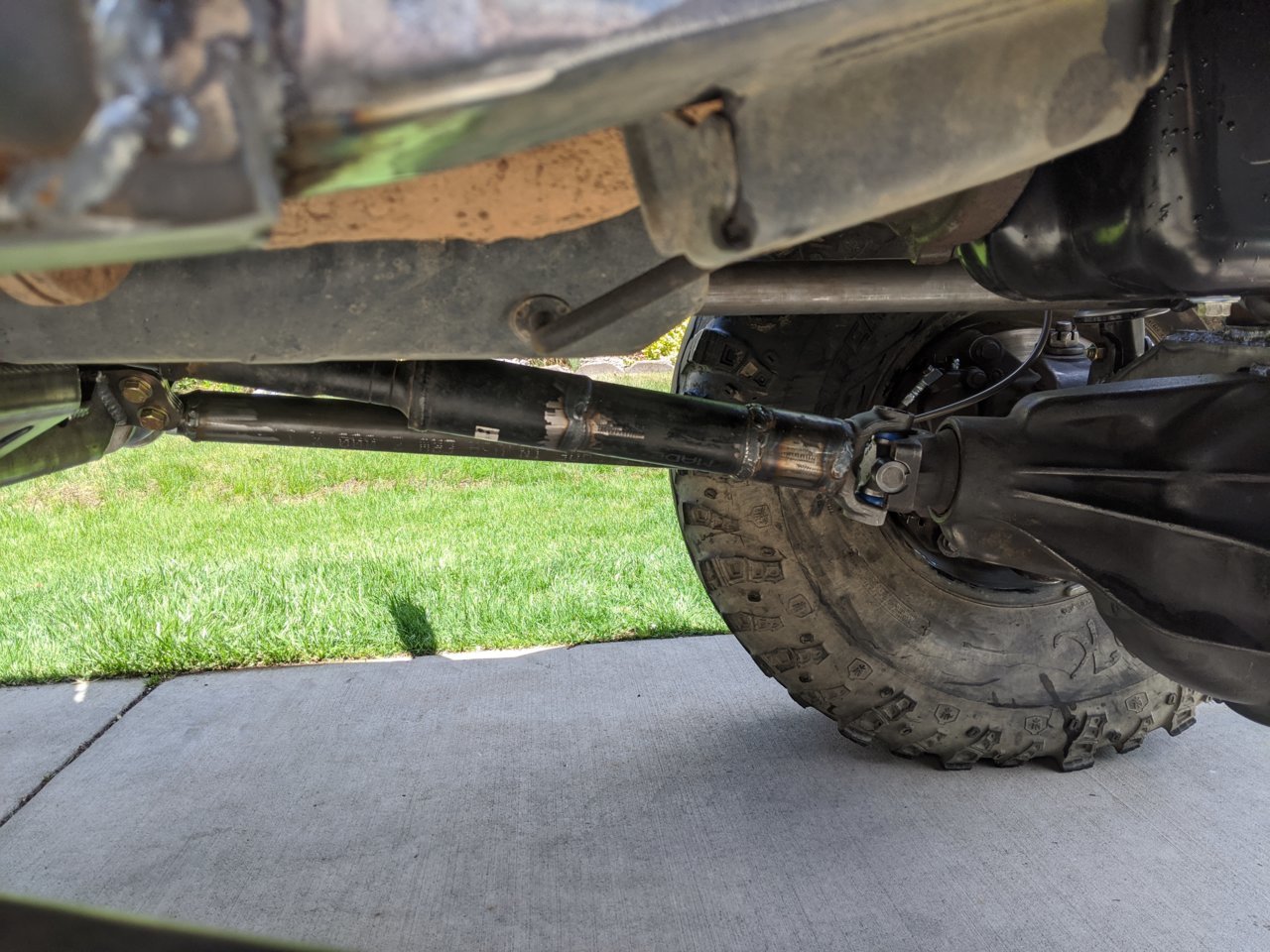

    Built front driveshaft, wired up electric fan, tightened down all the things. Found some clanks and leaks, tightened more shit. Zip tied my old wiring harness to the rear, slapped some lights on it, put my license plate on. Drove to get gas around the corner.
    Tons of body roll in corners, need heavier springs. Whatever, it goes, and not undergeared. :p

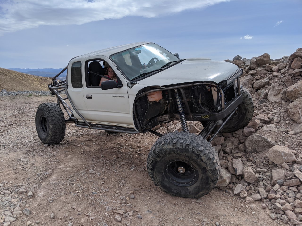

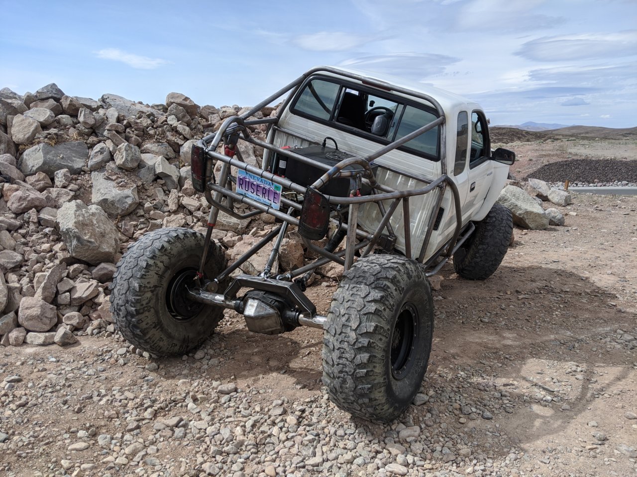

    Neighborhood crawling, just curious to see how it articulates.

    Curious if you notice the homemade DS rolling around the streets? Masked by everything else or hit it close enough not to get ridiculous vibrations?

    Meh, function over form right now. I'll sort out the cosmetic shit later, no bedsides, but I'll do something about fenders soon.
    So, I can't tell. There's a ton of tire noise, so my guess is there's a small vibration somewhere in there, under all the other shit. As soon as I get new tires and align my links, align the tires, then adjust my coilovers, I'll probably notice the vibration.
    Learned a cool trick though. If you add a hose clamp to the shaft, it acts like a balance weight. Drive, feel, then rotate until vibration goes away. When you get the spot where vibration lessens, that's where you add the weight.

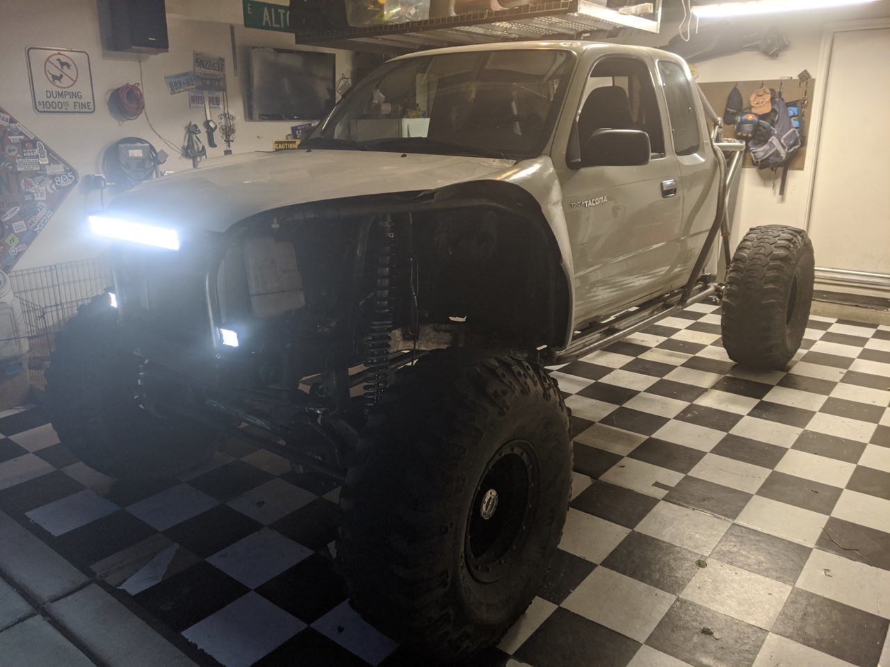

    Jerry rigged some lights. Pods are parking lights and bar is headlights. Gotta love free shit. Won these last year at 4WP parking lot party.
