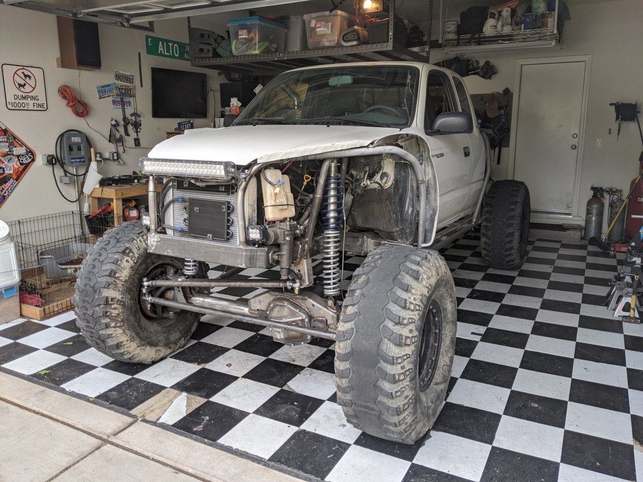

    I didn't like how low the bottom bedcage bit was, so I cut it out and relocated a little higher.

    Not a whole lot today. Removed a shit ton of spatter, cut the fenders back on a better line and folded the hood down. I'll go along with a strip of steel and even it up so it looks pretty.
    Also, fuck fiberglass.

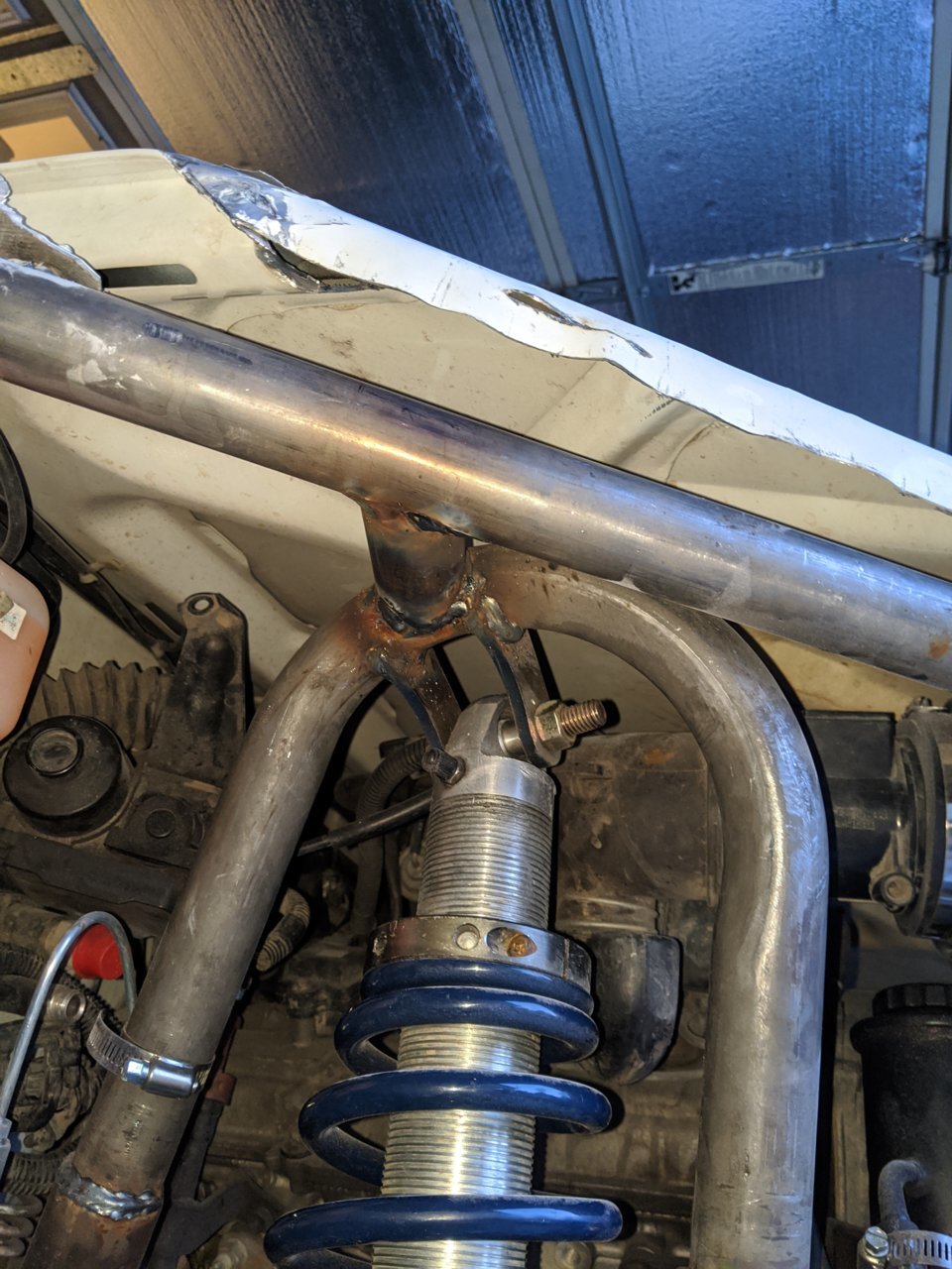

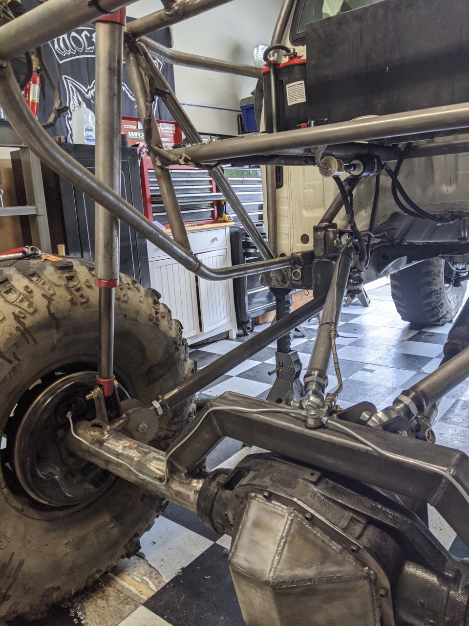

    Tightened all the things, fixed a slow leak in brake line, then welded up gusset bracing for coilover hoops. Only took one picture because it was a dirty, somewhat boring day. Tie rod clamp for hydro arrives tomorrow.

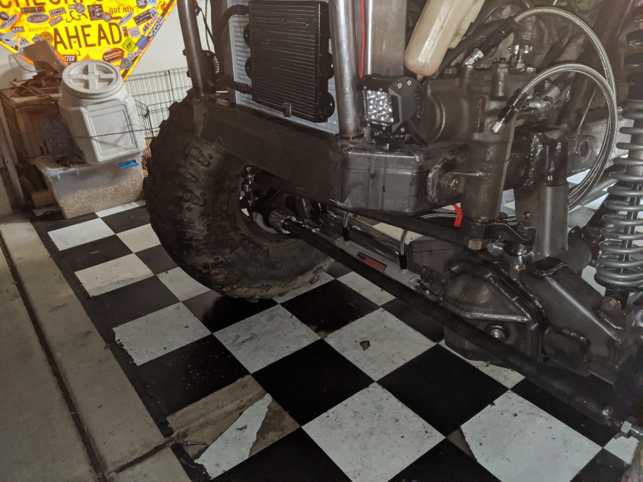

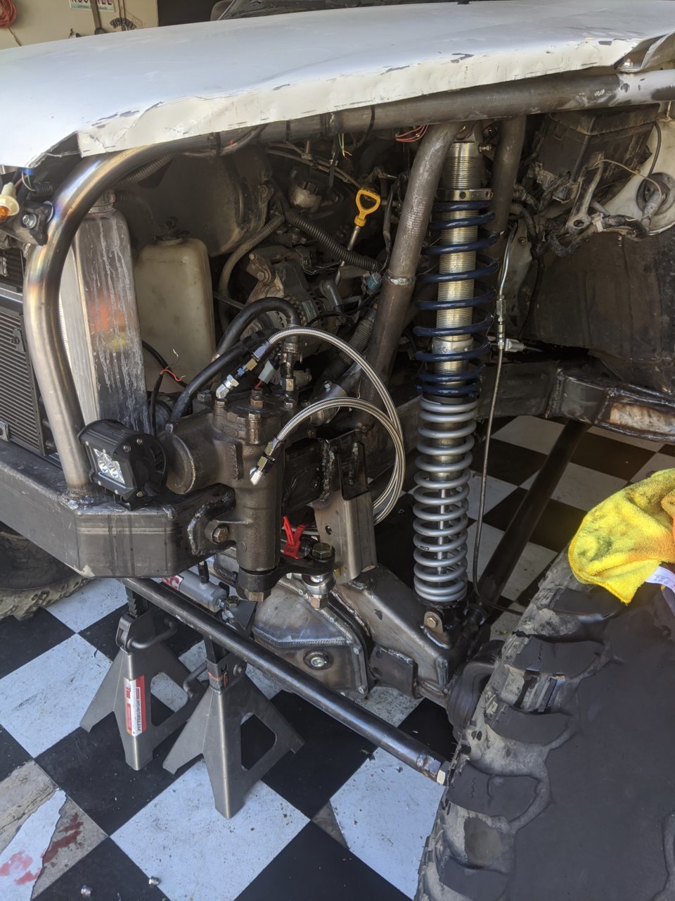

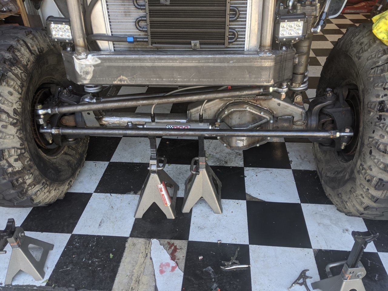

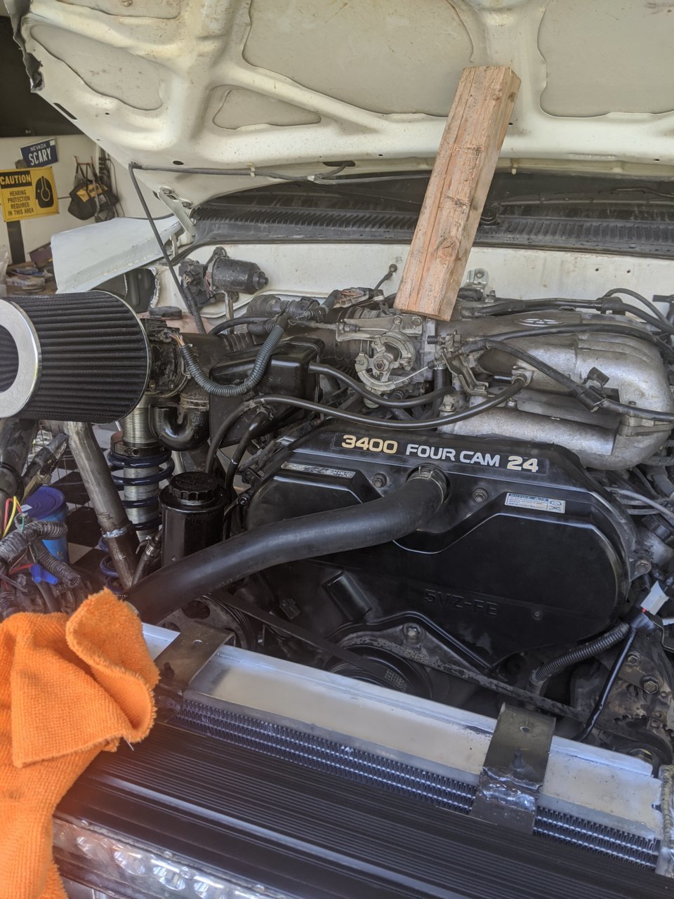

    Hydraulic assist in!
    Also, ATF exploded from overfill and sprayed the engine bay. Apparently it's also the best way to clean your engine...

    The volcano of foamy ATF seems to be a passage of rights when you try to bleed a pretty empty assist ram...been there, more than once lol

    Haha, so, I couldn't figure out where it popped. Went over all the lines, but because it was everywhere, it looked like it came from the sky.
    Only clue being the pump reservoir has that saddle area at the top under the cap. That had puddles. My main concern was not letting it go dry.

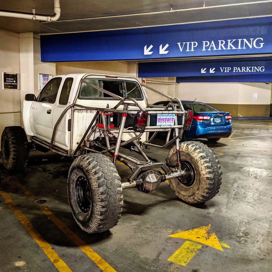

    Dats fuckin right bishes! VIP, lololol.

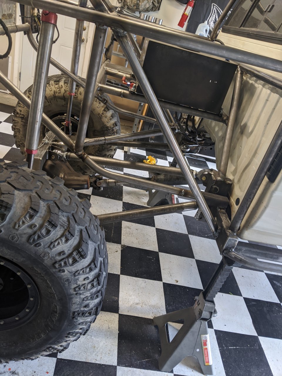

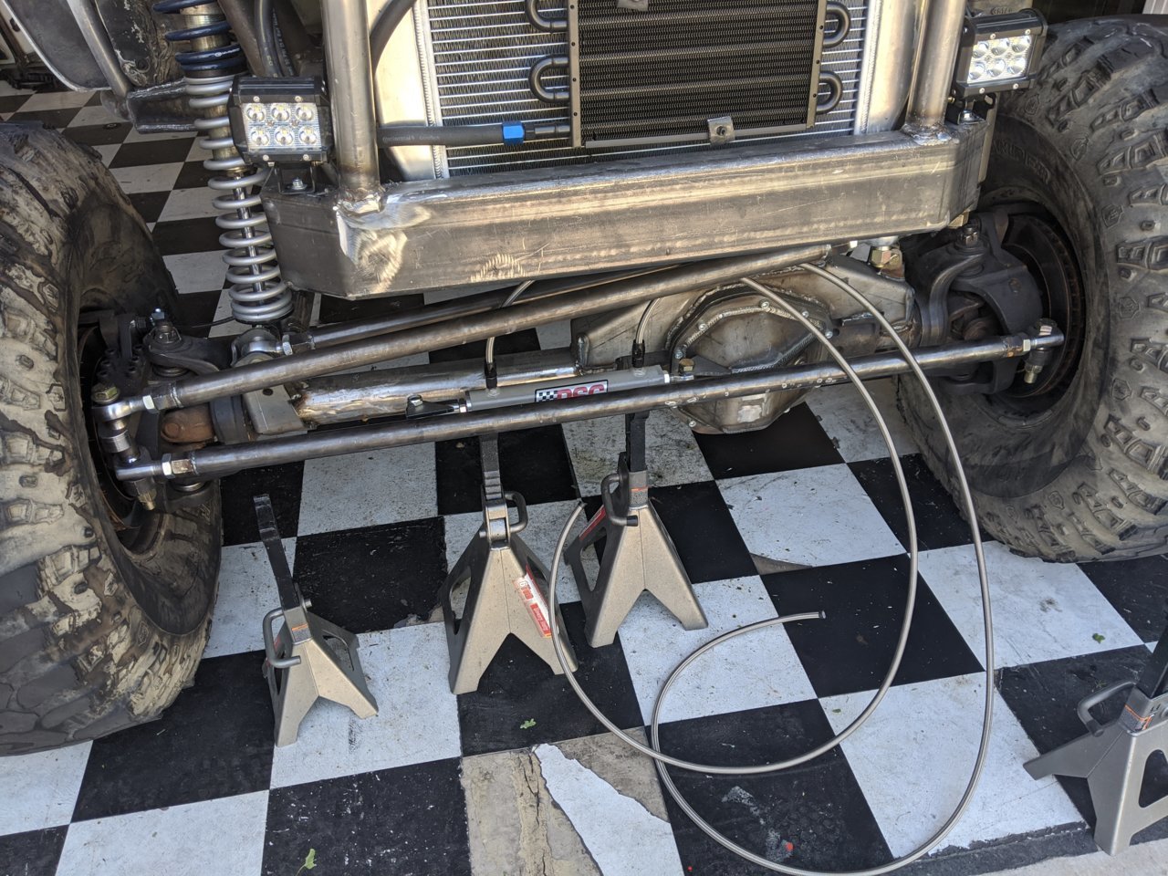

    Found my limit strap lengths and found a binding issue on the rear cage... Right where it looks like I'll hit, sho'nuff, I can only squeak out 10.25" of droop, which is more than traction can handle, so it shall stay like that and I'll just limit at 10".
    Front clears like a champ. It's almost like I know what I'm doing... Hint: I don't.
    24 inch from tube to able rear
    15 inches from frame to axle front passenger
    12 inches frame to truss front driver
