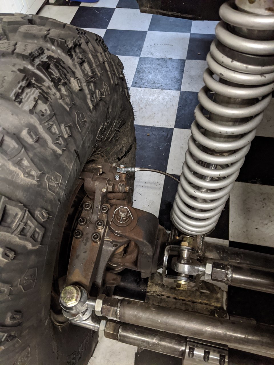

    It's not bad, I wish there bend radius was tighter, but, meh, only for a couple things that ended up looking better when I did them different anyway.

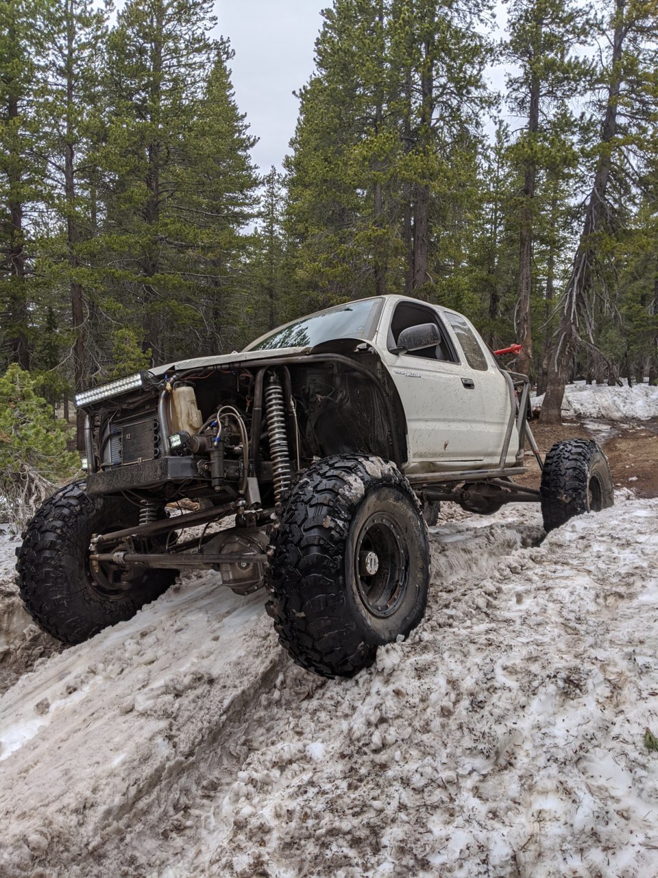

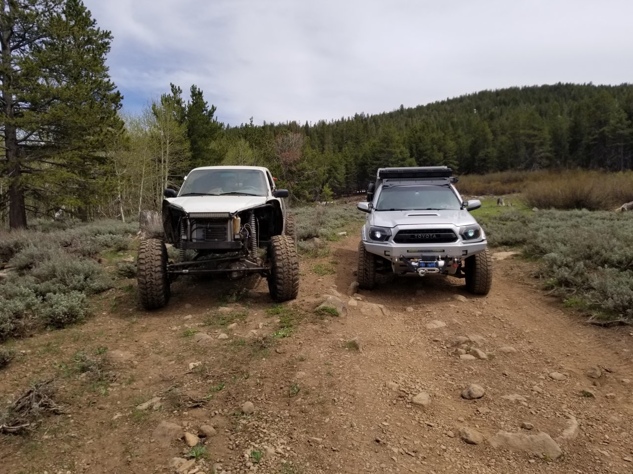

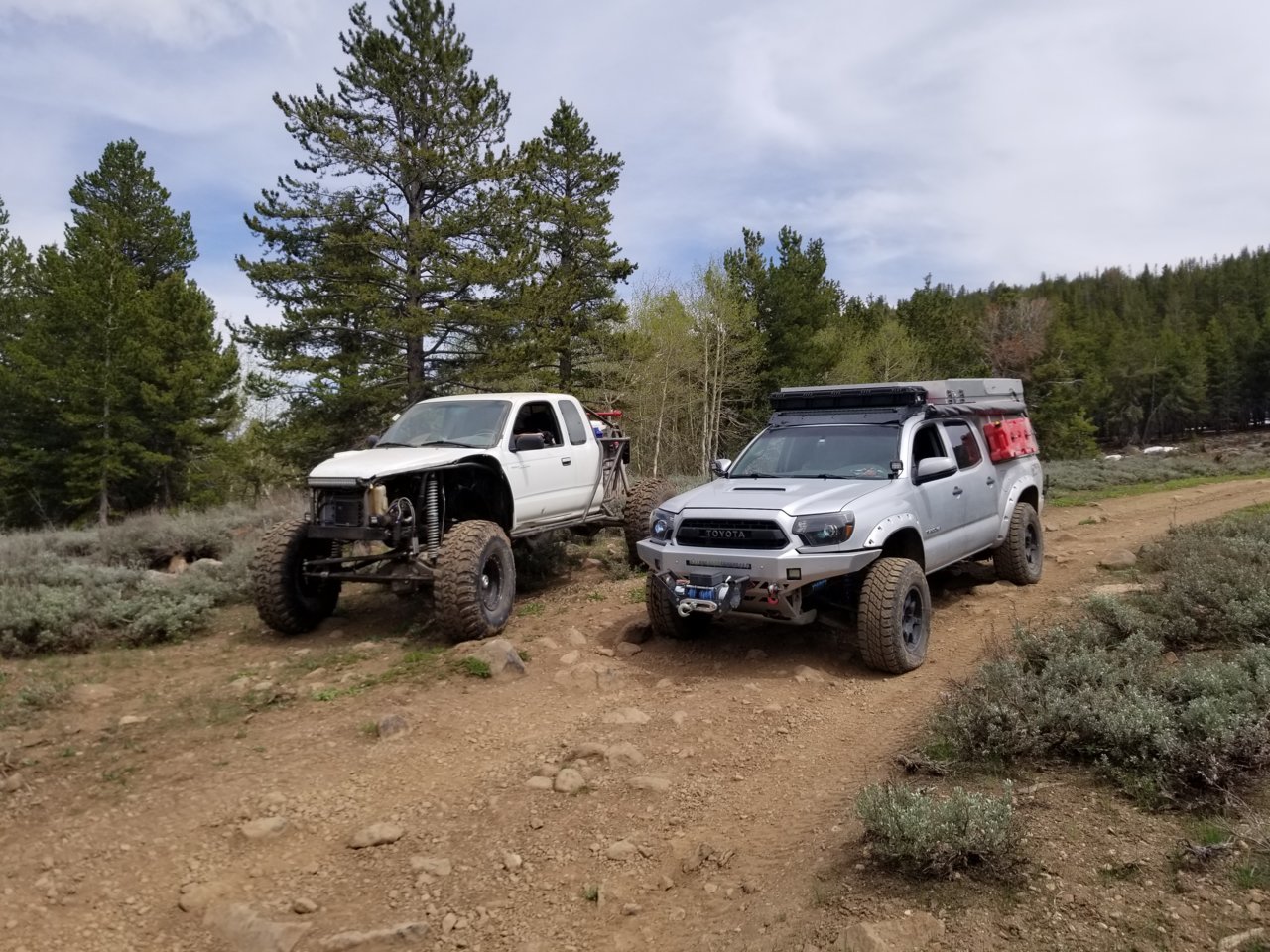

    Some shots from today, shakedown was a success. I eased into the day, but by the end of the day, I was steady mobbin.

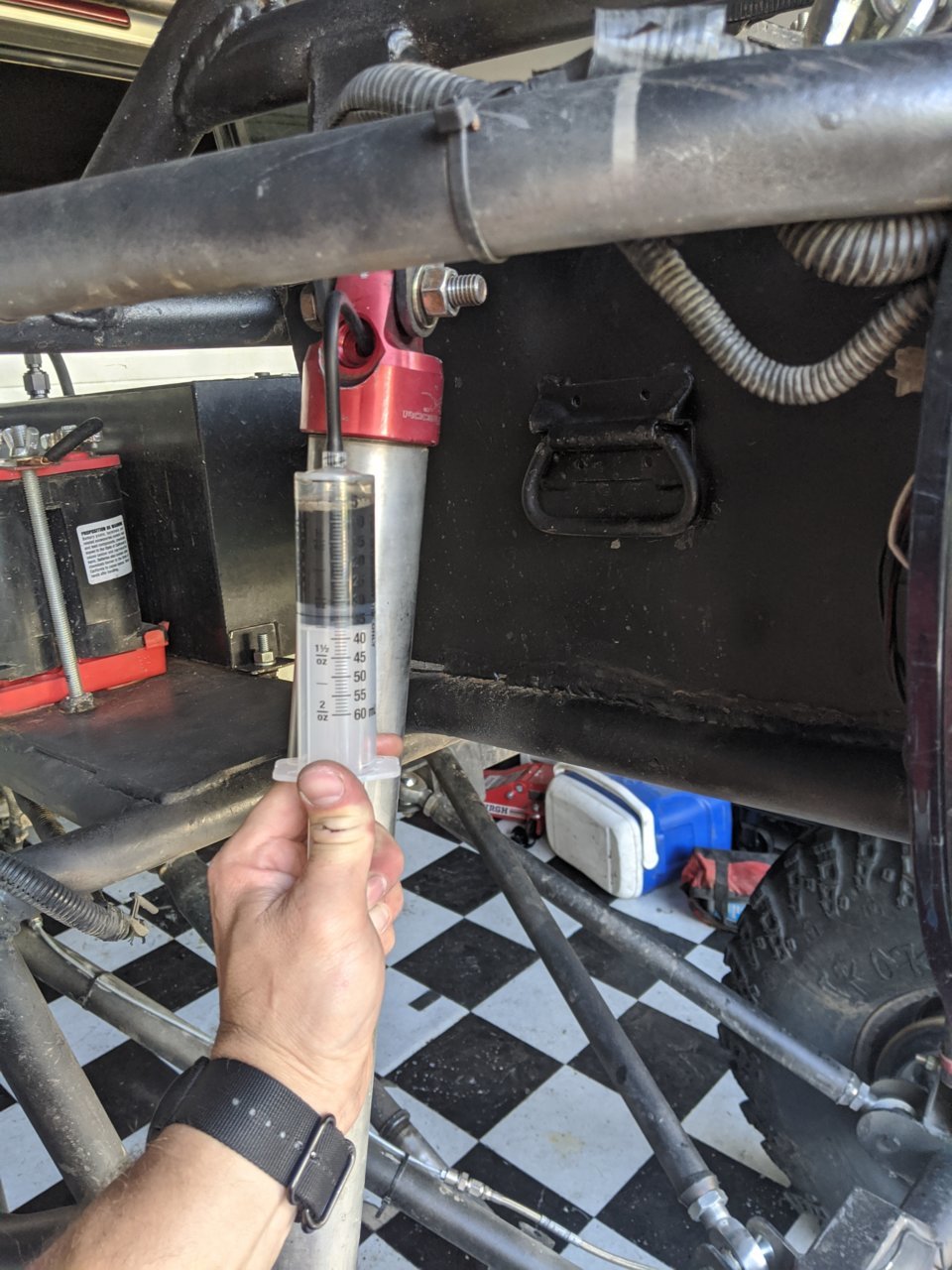

    Forgot about spare, so maybe I'll just cut off my legs to get under 5k total.

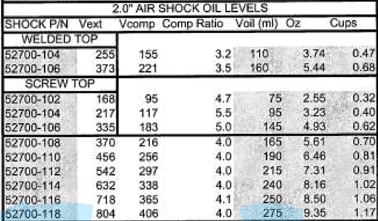

    Also did air shock things.
    212mL from DR
    217mL from PR
    Put 275mL in each and 200psi N2. Body roll significant decreased. I'll add 20mL to each tomorrow then test. Rougher ride but I'd rather that than unloading on a side hill.

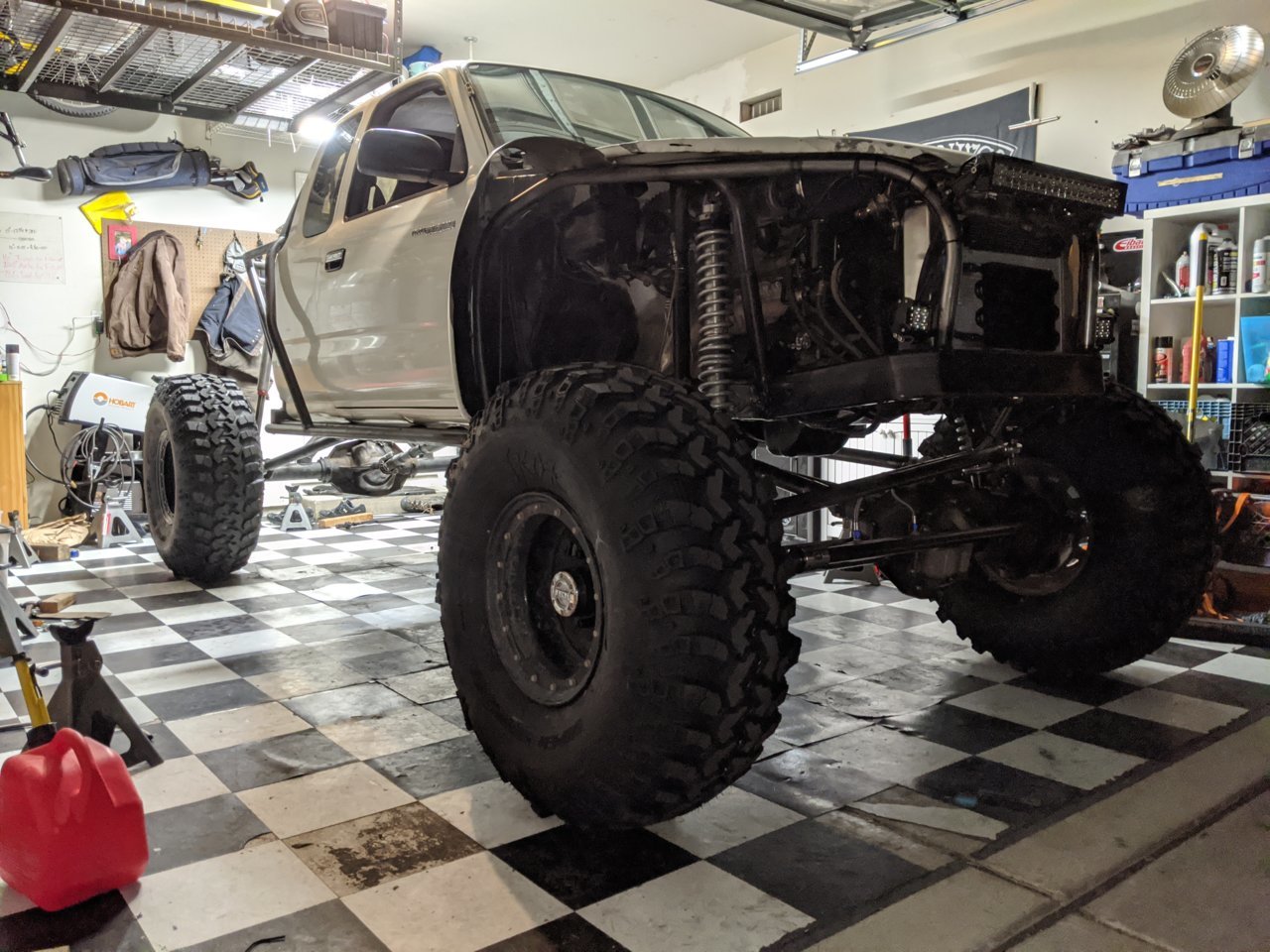

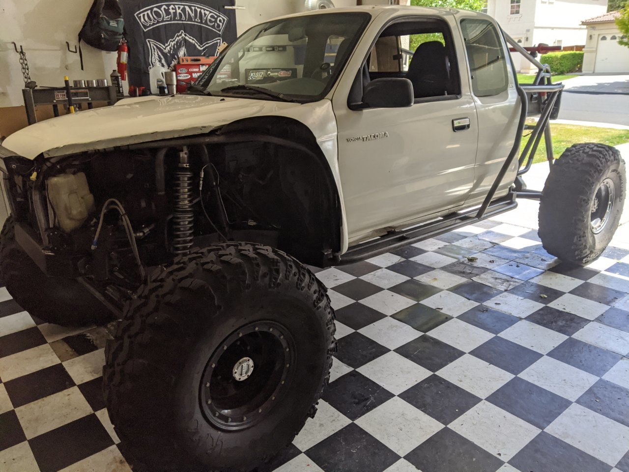

    Also swapped springs again. My middle was 14" 300 lbs. Now I have a 10 inch 200 lbs spring. Rides a couple inches lower. 5 inches travel front 7 rear now. And fuckin body roll is not as ridiculous. I can get it to kick over but I have to try.
    After:
    Not super noticeable from pictures at different angles, but stability and sidehill unload is improved by a non-trivial amount

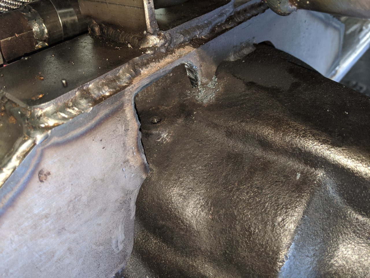

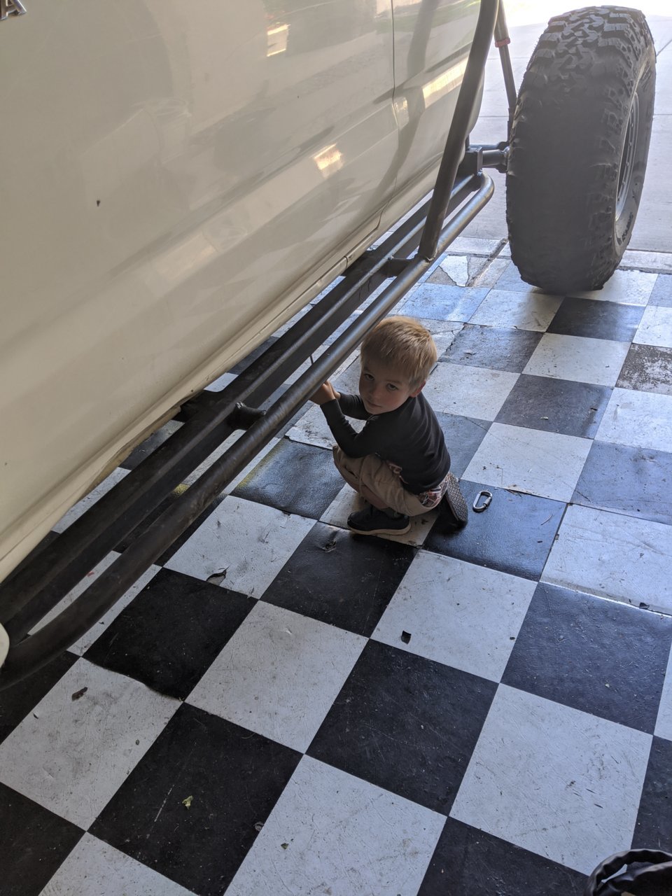

    Had a helper today. He used the screwdriver on the sliders... So they're good to go now.
    Boxed out rear lower link frame brackets and rear shock axle mounts. Filled some holes, fucked with ride height on PF. Have 5 inches up 10 inches down in front and 8 inches up 10 down rear.
    Then I went and found the breather I ignored when welding the truss. I'll run to the hydraulic place that made my brake lines and see if they have a 90° fitting that will work for the breather. If not, dunno.
