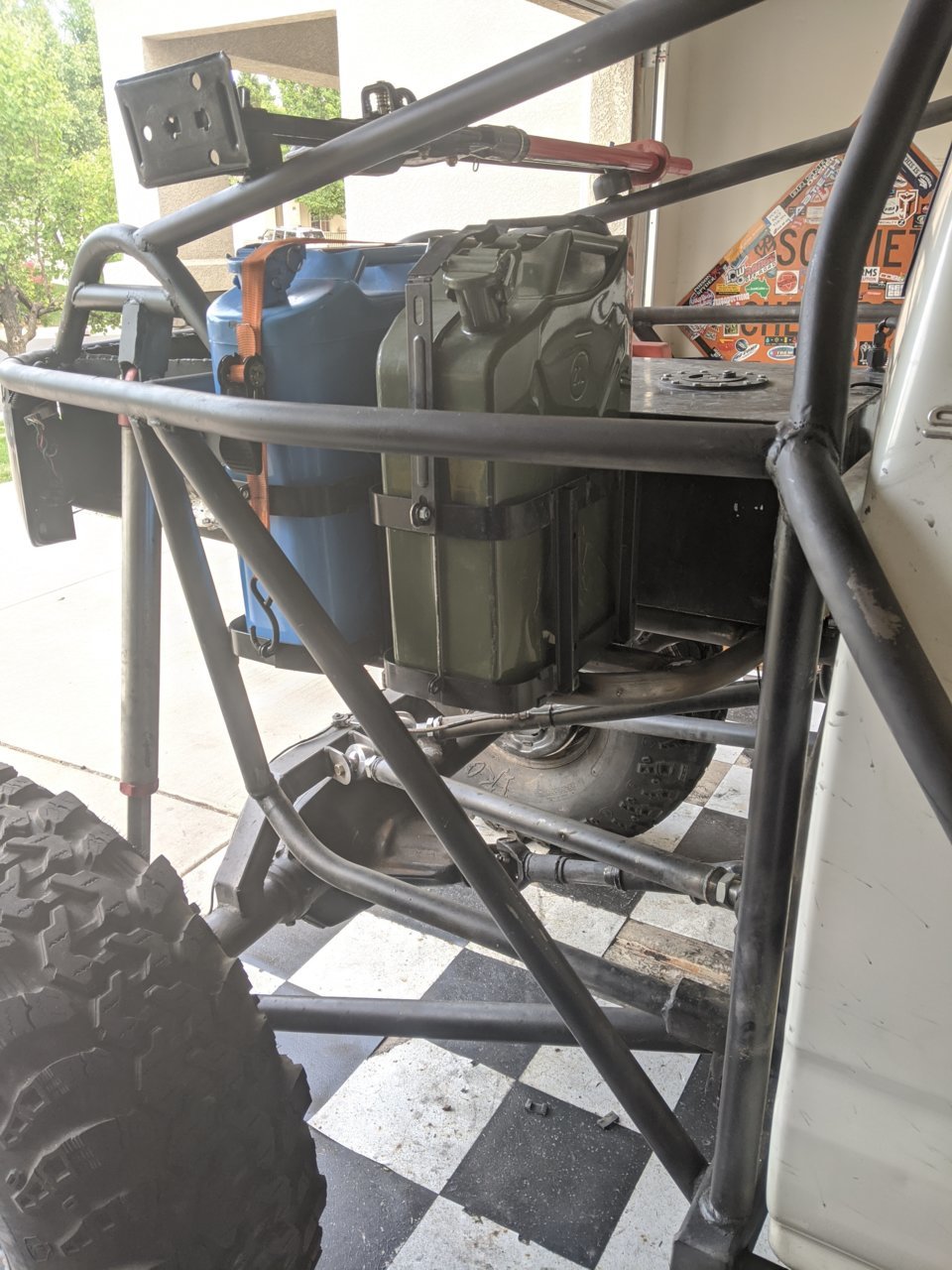

    Adjusted my front links to push the axle back about 1/2 inch. Tightened shit down in steering. I figure I need to come up with a bracket to double shear the drag link on the steering arm. Not overly concerned, but I stared at it until I was sure I couldn't make it appear by simply wishing it into existence.
    Jerry cans mounted. I broke the top bit and didn't want to get fancy. So I shoved it further back and cut the top bracing off so I can just slide it in instead of wrestling it. Now I just have to mount the co2 bottle on the driver's side and start wheeling to see what breaks.

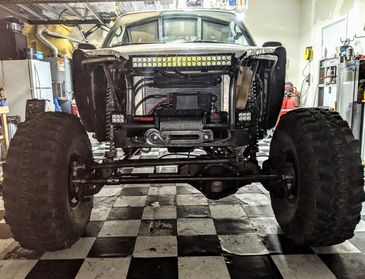

    Mounted a winch with scrap. Buddy said he knows a guy, so picked up 9.5k RC for $195. Weighed in at 4590 with me in the truck

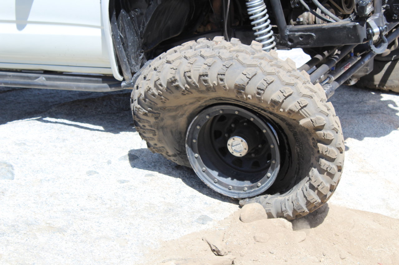

    Haven't went through all the bullshit yet, but yeah, need to get rid of the fake beadlocks and weld up some proper rings.

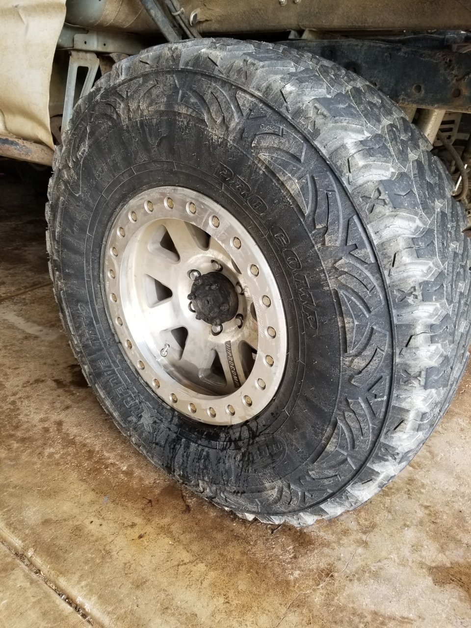

    Hahahaha yeah, stupid. I bought them because price and I didn't look at them hard. Had my mom go pick them up, pictures were meh, and she didn't know the difference.
    Since I have 16s, beadlocks are a bitch to find. Raceline makes some. what I may do is just strip off all the bullshit on these, have some rings built, and weld them up.

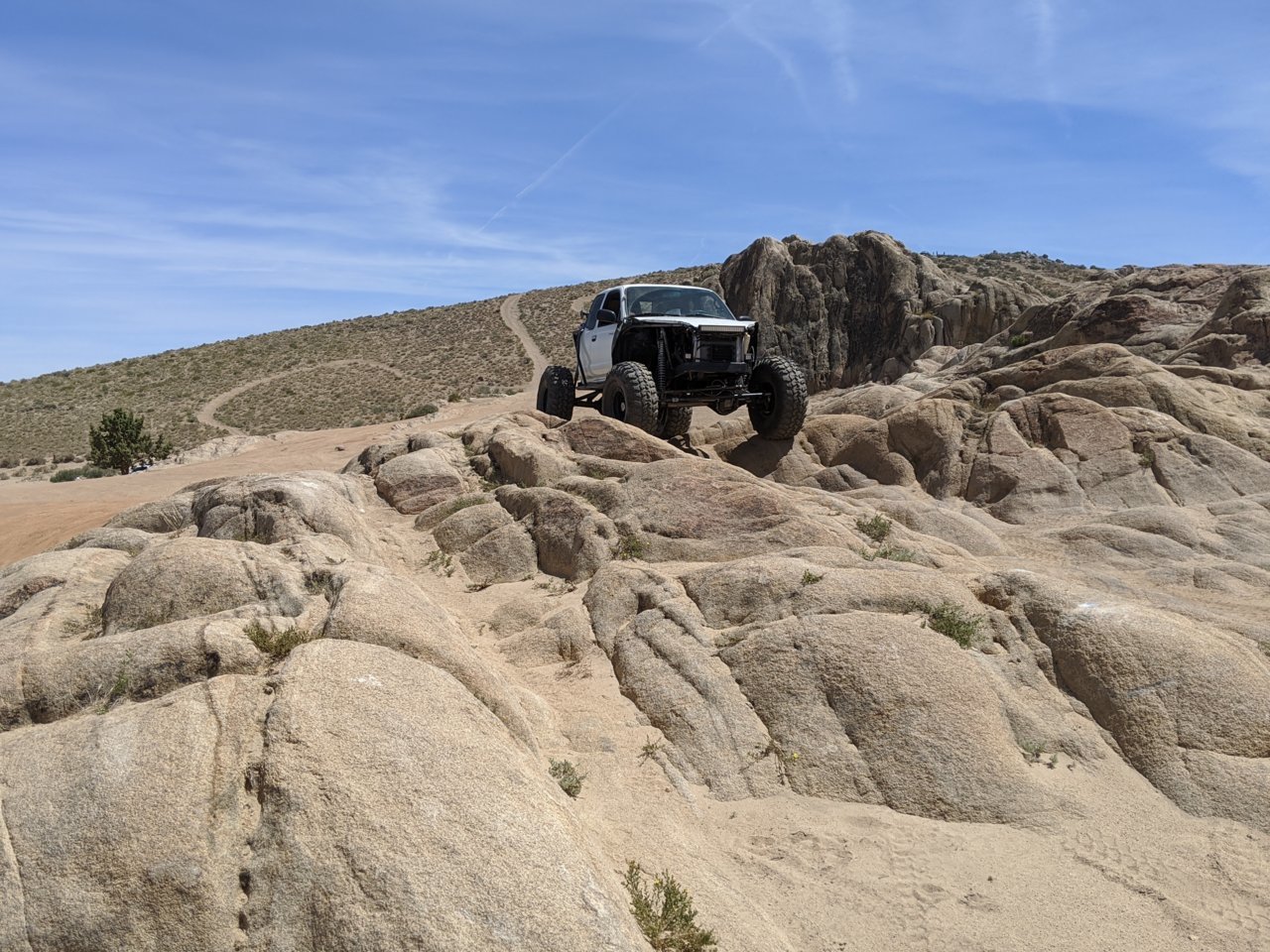

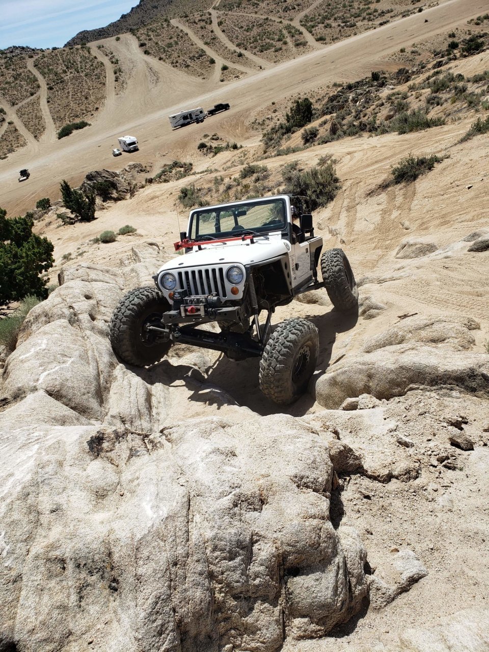

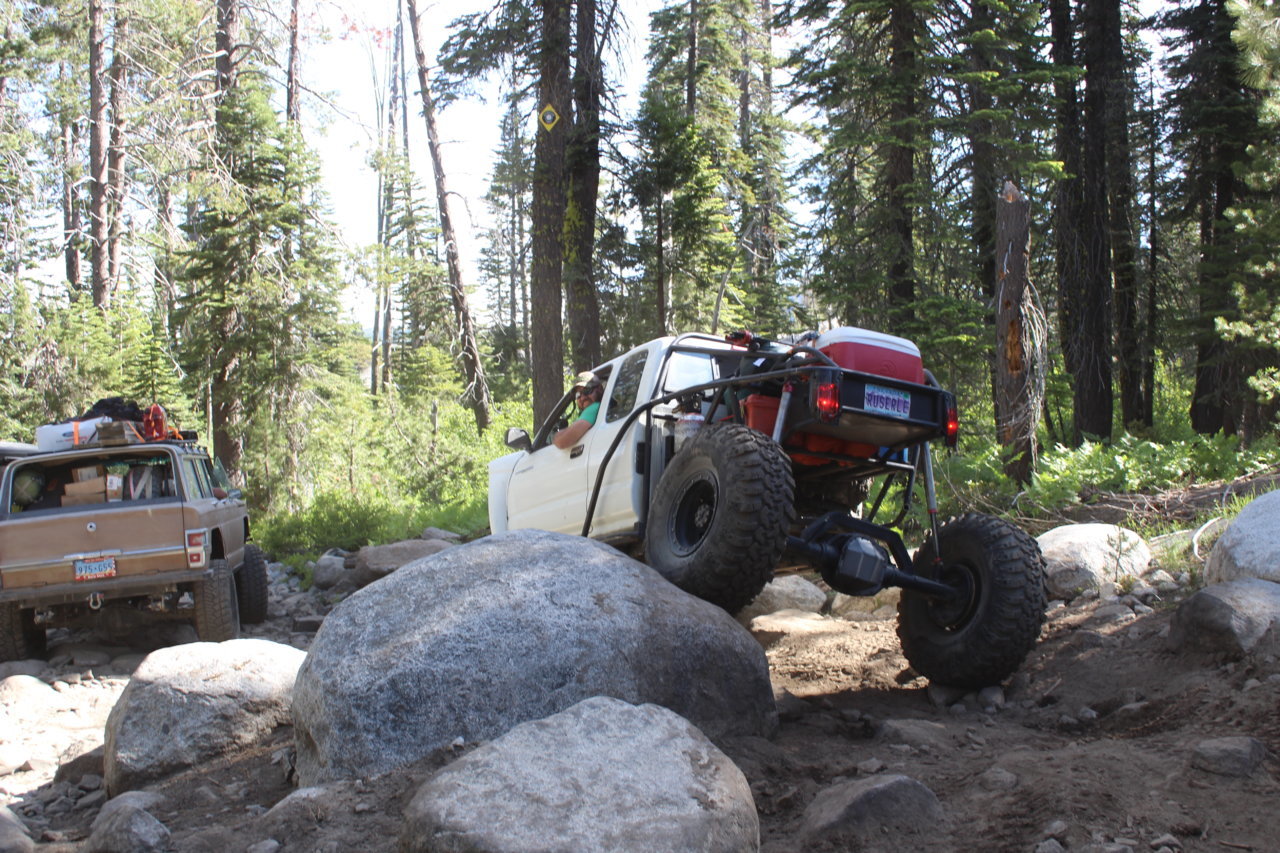

    Also, some pictures from this weekend's Rubicon trip:
