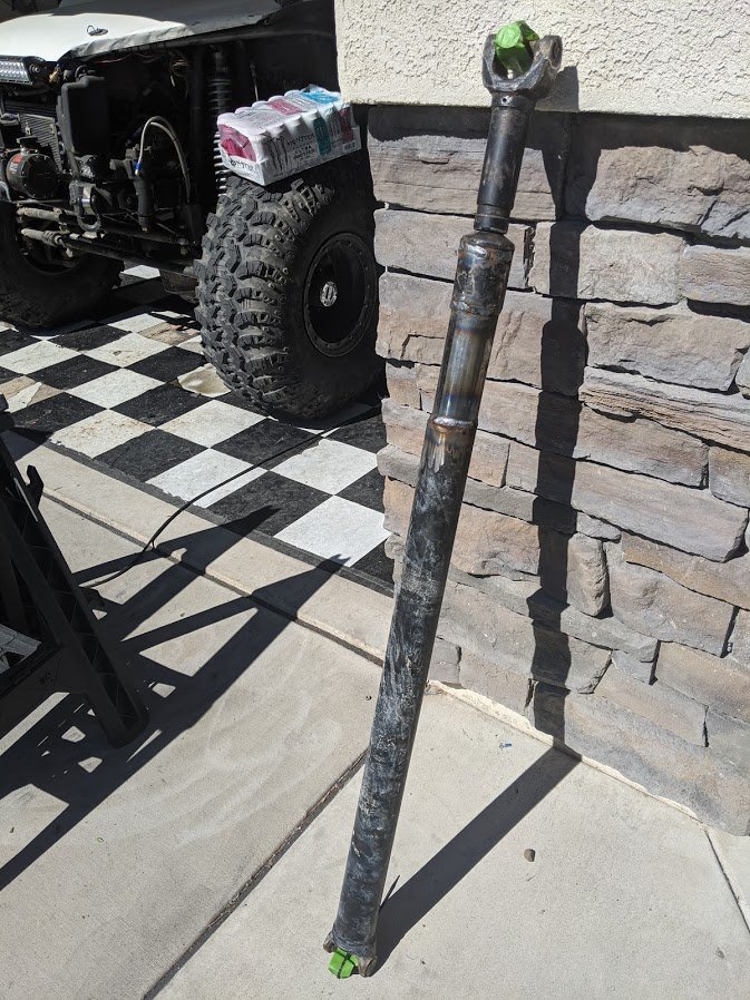

    LOL, that rig is still in there. We had a SNAFU. Here is my custom drive shaft to get it out. Unfortunately, it's at Buck Island Lake, driver sprained his knee and can't use the clutch. Going back in this weekend, I am going to have to take it through Big Sluice and Cadillac to get out Tahoma side, or gatekeeper and the slabs and 3 hour drive on the Loon side.
    After I went through Big Sluice and Cadillac in mine, I think Loon is the way to get him out.

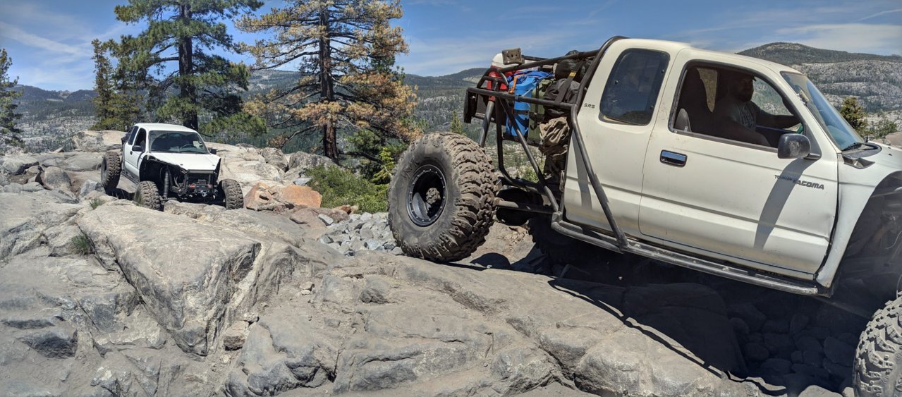

    So, that was the beginning of the misadventures. All the guys I went in were on 33s except on on 35s in an otherwise stock JK 4door.
    There was plenty of warning about how brutal it gets, but I don't think people get a real sense of how sideways shit can go until they are in it. In his case, he took a bad line, cased a large wide rock coming out of the damn through "the eggs"
    We then sat for a moment. Since I had the most capable rig, I bugged out at warp speed to avoid solo on Cadillac in the dark. Problem is, at the roots I hammered out and bent the frame a touch (enough that the tight tolerances I had for the panhard became binding on the diff cover. So, I limped home, pieced together his driveshaft and welded it up with some HREW, we got a quad, and delivered the driveshaft. During his time in the dark, he apparently tweaked his knee trying to break camp and crawl into his Waggy to sleep. So, upon delivery, they loaded him on the quad and booked back to Loon.
    We were way behind schedule due to a traffic jam in soup can and a late start after some of our group stayed up drinking the night before. Saw Tooth fucked up a bunch of the other rigs in our group on their way out. I had fun, but I guess there was drama and bullshit after I left... Glad I wasn't there for that.
    All I had to say to all of them was, "Welcome to the Rubicon, where you find out you don't know as much as you thought you knew." :p

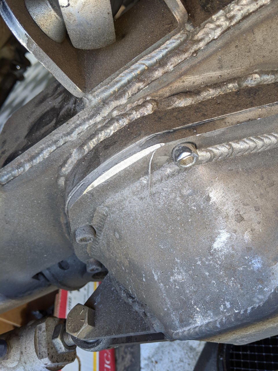

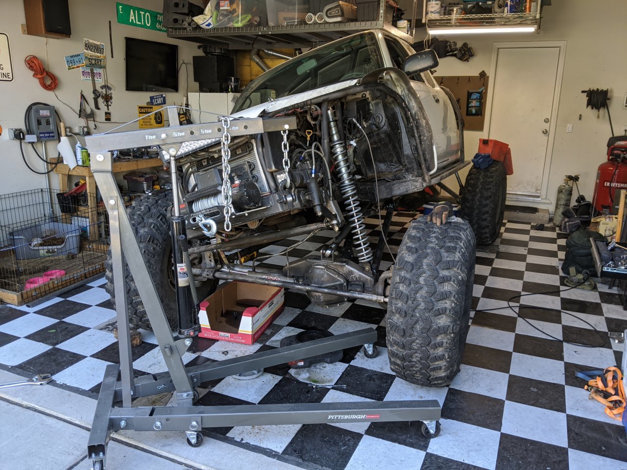

    First things first. I welded on some 1 inch clevis mounts. On the diagonal part next to the winch. Most people want "recovery points" but it made it easy to work on links using the hoist.
    Adjusted the links. Pulled the front axle back .5" and set the upper link at one half turn out of driveshaft bind. Caster appears to be more than 0 now, so that's good.
    The diff cover got beveled on top and there's a chunk out of the panhard from contact. 1/4" steel is fine with some burring.
    Whatevs, half fixed. Have a length of Dom to start the exo. That will stiffen up the front and fix any issues from lack of strength in the front.
    I jumped it fairly high, so I expected some damage.
