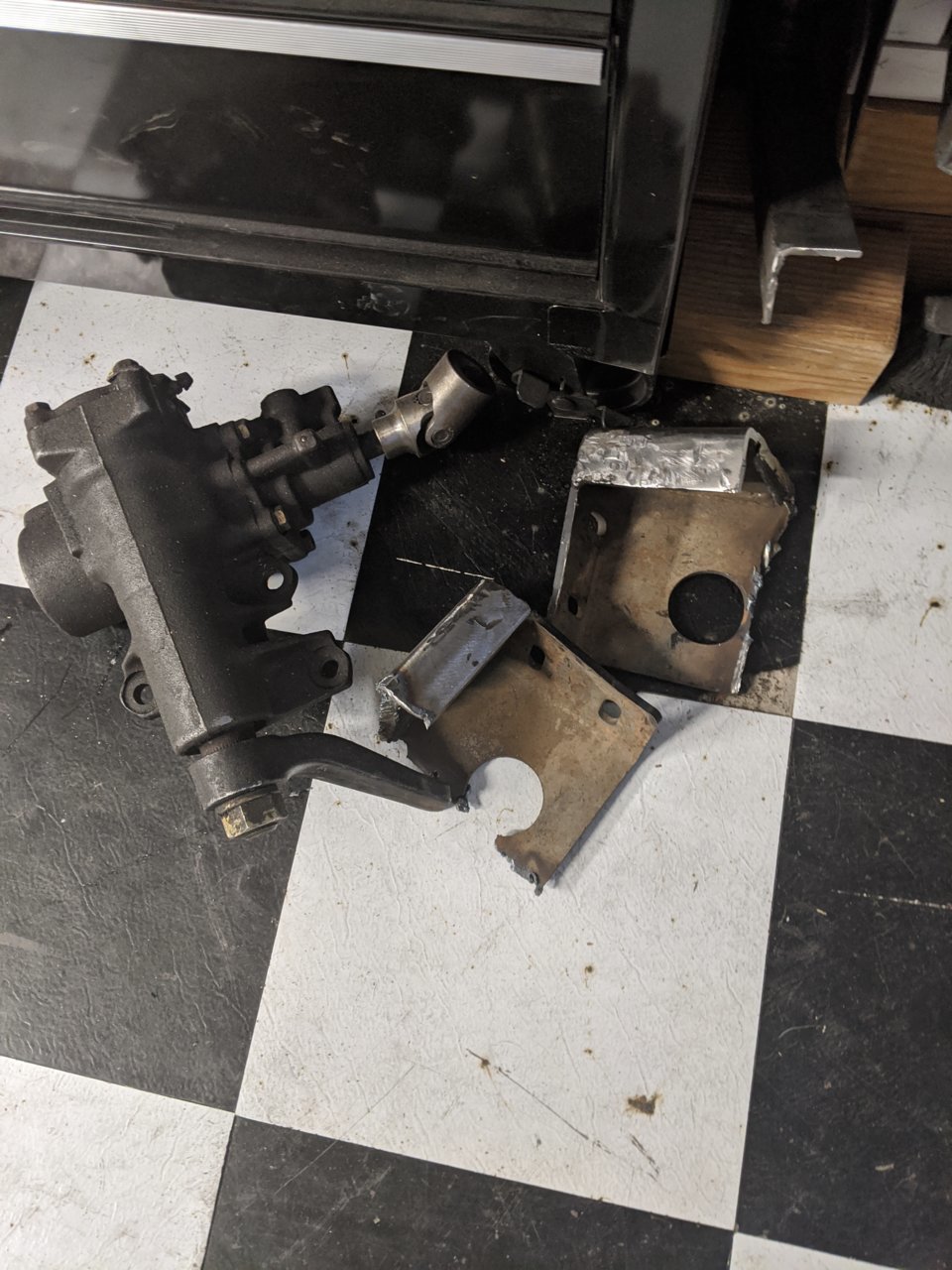

    I decided to skip working on the truck yesterday. I have stress fractures in L3 and L4 from a lackluster amateur career in kickboxing. My wife's yard work pretty much made me useless on Monday. That's the sacrifice I was talking about I suppose.
    Wanted to get the steering box mounted up today, but I can't get it far enough forward without hitting that repurposed front cross member. So, off with their heads!
    A little bit day by day. My daughter needed her bike water bottle holder fixed, so that ended the day.

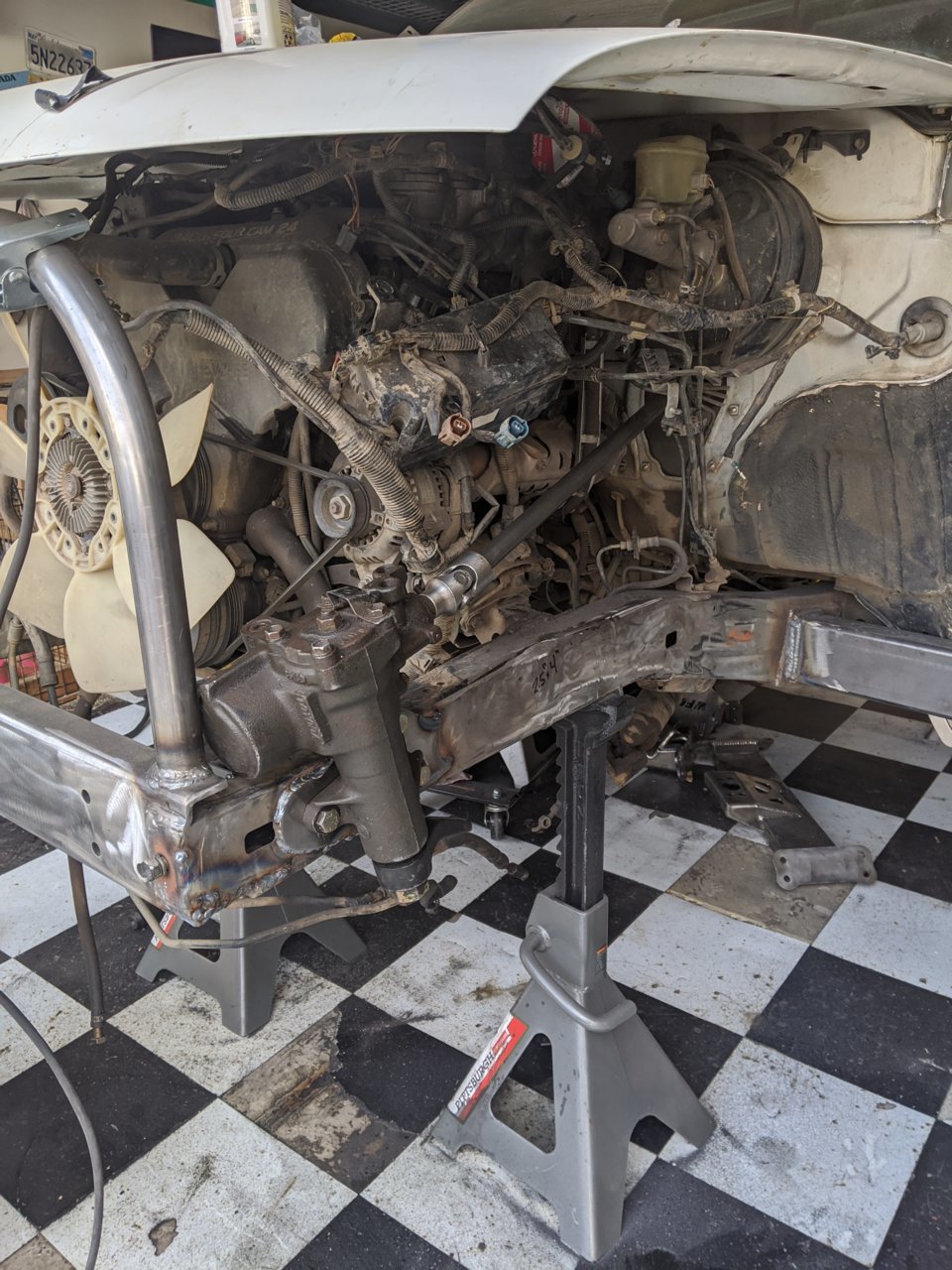

    So, after much deliberation, I think I have placement of the box where I need it. Got everything tightened up, going to tack, shave the sleeves and get the box mounted to get it off the floor.
    I need another set of hands but daughter is sick and not strong enough to hold the gearbox in place. Hate how slow going this is. Tomorrow should be more productive.
    Go straight axle, they said.

    Quick update. Steering box in! Now comes the truss work for the front, WFO crossmember, and sorting out 3 link geometry.

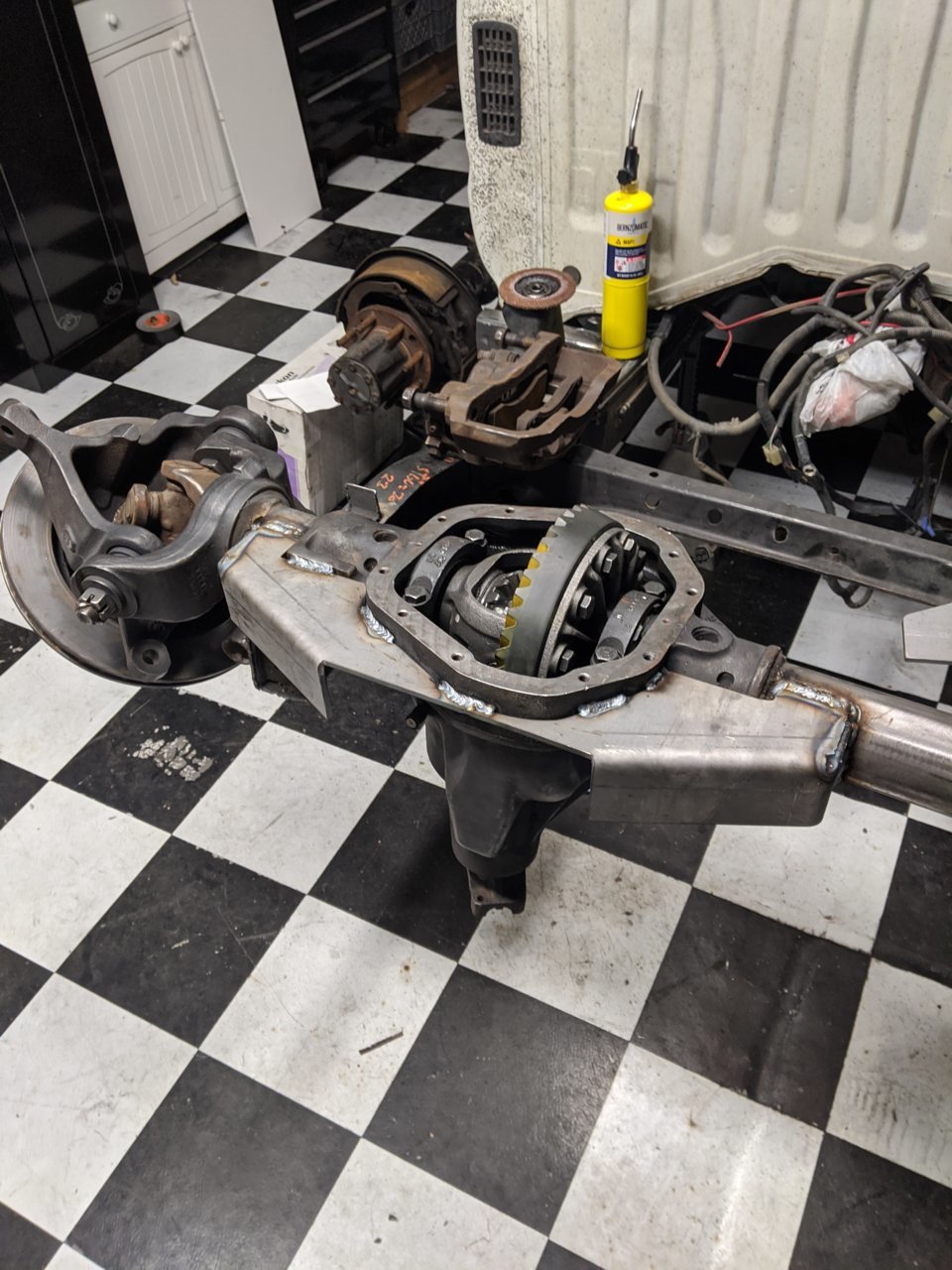

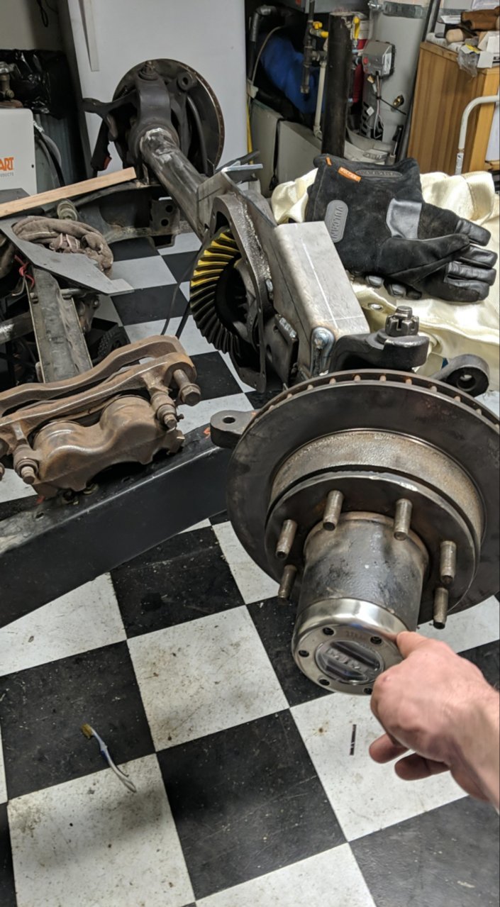

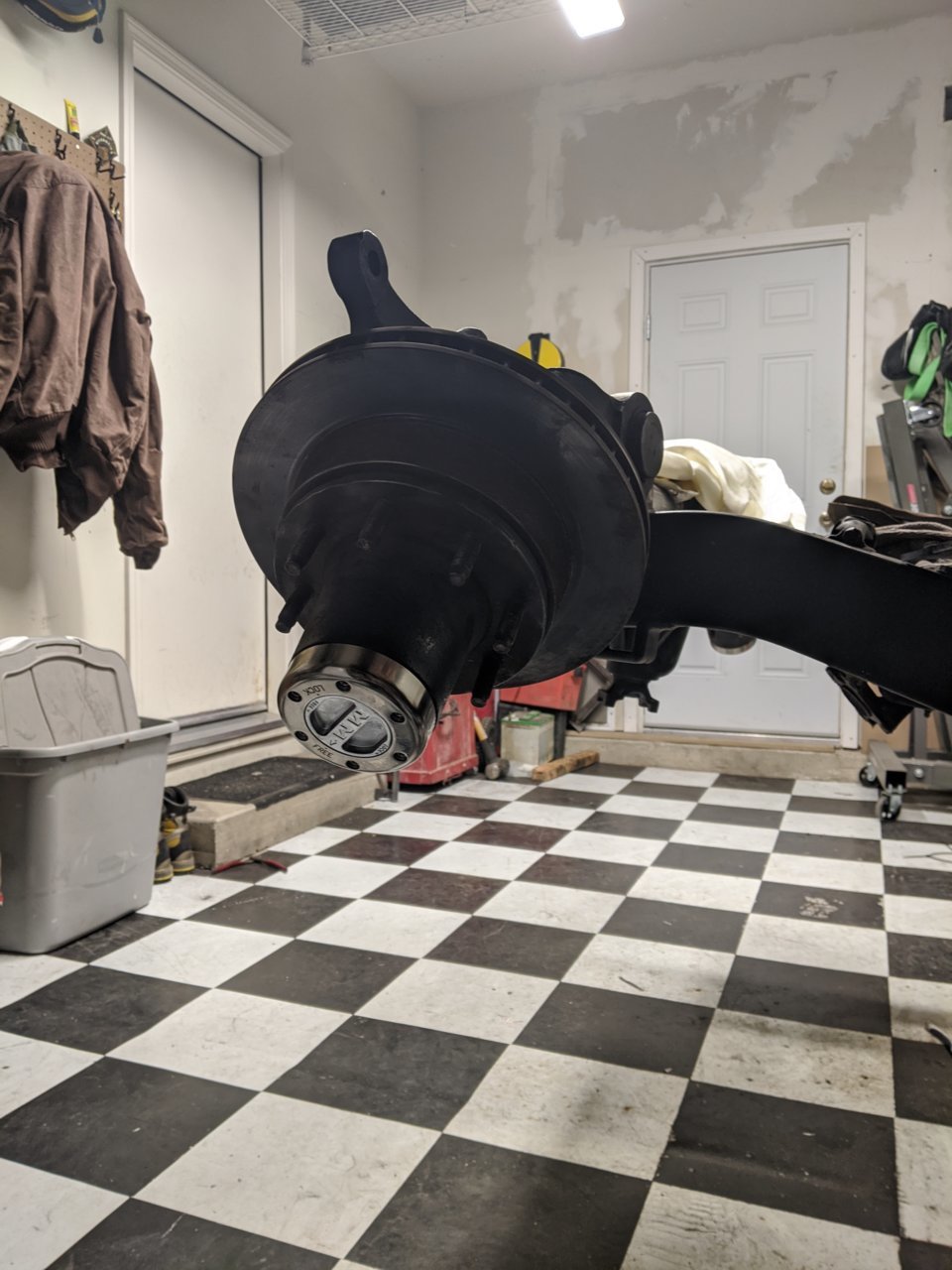

    Mile Marker hubs in
    Truss half welded in
    Tubes burnt to pumpkin (I hate cast)
    WFO crossmember shit staring at me.
    Ric Flair Wooooooooooooo! Done for the day.

    I lied, got ancy and banged out some more like an addict. The cast is hard to run a nice bead on, so I'll flap disc and take it in smaller sections.

    I'm surprised you didnt stick weld that cast. Did you preheat?
    Disclaimer- I am not a cast welding expert.
    esxcli[OP] likes this.
  14. Mar 4, 2020 at 8:12 AM
    #54
    esxcli
    esxcli [OP] Keyboard Warrior
    Jun 25, 2018
    #257452
    1,040
    Sean
    Reno NV

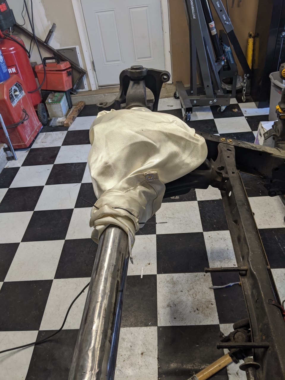

    I watched a shit ton about welding cast from other people just doing shit, but I was still leery. So I hit up a few buddies who are pro welders, and asked their advice. Here is the synopsis of the responses.
    If it is the only structural bit, use a 7018 rod and make at least 3 passes. However, it is really there for structural support as the main strength comes from the sections welded to the tube (which was 70-S6). The caveat to this is, preheat and allow to cool evenly. Cast steel will cool faster than the mild steel of the tube. Hence the fiberglass blanket. So here is what I did.
    Flap disk everything clean and shiney.
    Map gas for 10 min or so on the cast and tube, 2/3 of the time cast.
    Got everything to about 400 F
    Ran small beads
    Hit the cast with the torch again
    Covered it with blanket and wrapped to hold it
    Let it sit for an hour
    Repeated process
    Started welding, realized I didn't turn the gas back on
    Cussed
    Burnt my forearm turning on the gas
    Cussed more
    Started welding, but at this point I was getting impatient so ran connecting beads.
    Was at the wrong angle for the front, so it came out less than stellar.
    Threw the blanket back on and said "fuck it, I must be getting tired"
    Blew out the black boogers, cooked steak and asparagus, then went to sleep.
    Ultimately, I think I agree with you, stick welding that part might be the best idea.
    I think I might go back and run some 7018 rod tonight. I honestly think it's good to go, but I hate how ugly that front came out. :)

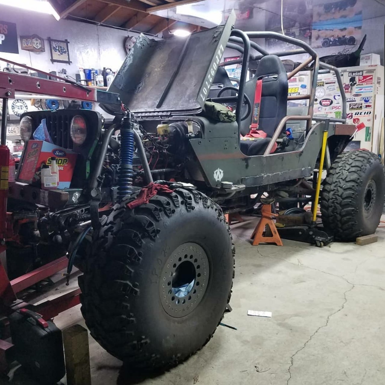

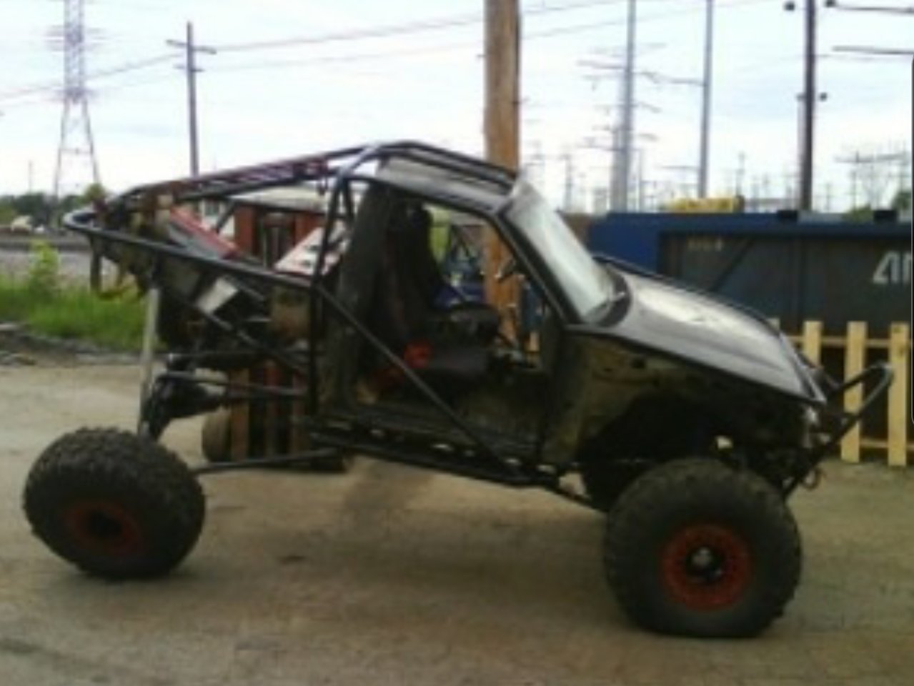

    awesome, here is my 1 ton taco i built 12 years ago (dang time flies) and now all the parts are going into my 48 willys.SmartSelect_20200304-104002_Instagram.jpgSmartSelect_20200304-103919_Instagram.jpg

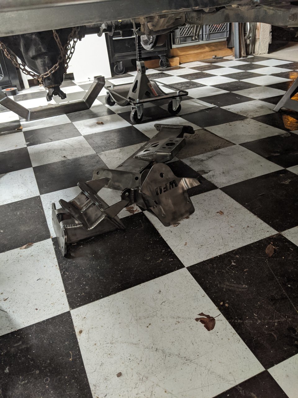

    So, I need to fabricate a link mount for the rear. Did you end up keeping the carrier bearing in? My thought is, I can go straight across under the carrier bearing and not worry about it coming in contact with the driveline. Since they will be equal length for top and bottom, there shouldn't be any binding... I hope.

    Kinda love the way this looks without the front panels.... very steam punk!
