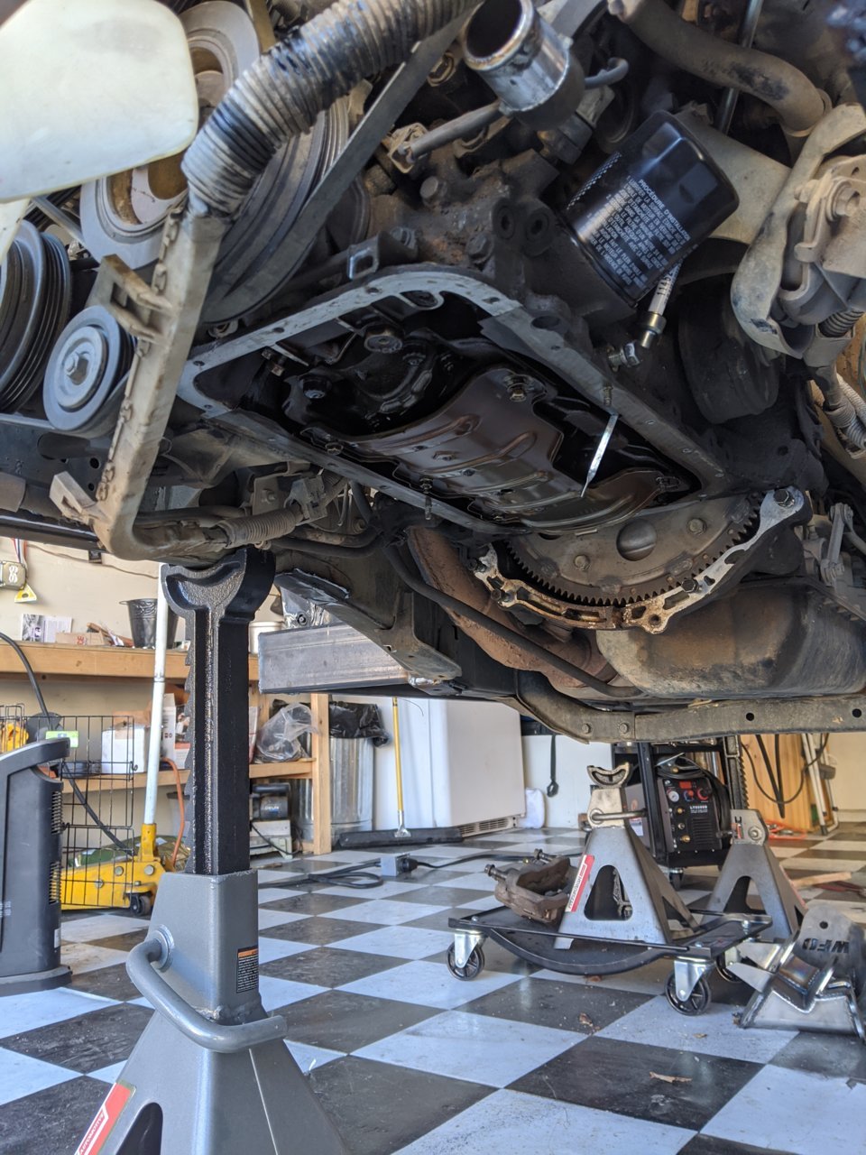

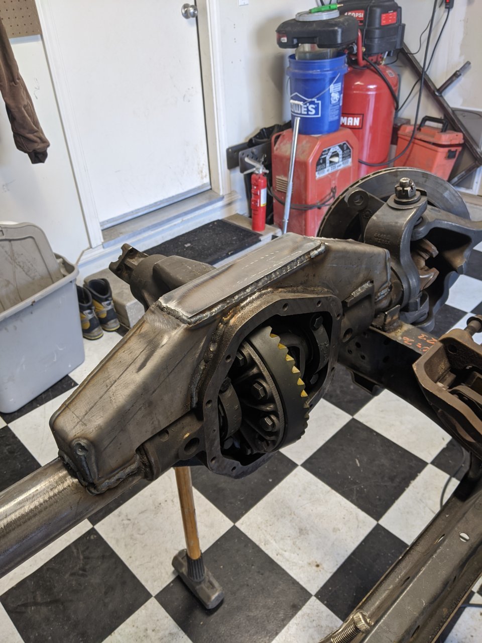

    Sad face, I ordered the wrong pickup tube. I originally ordered from Off Road Solutions, dealt with Mike, dude is awesome. If you need stuff for SAS, they're rad. So I'm gonna swap out the oil tube with the rear one and be good to go.
    Also, finished up the main part of the truss for the front, finished up the mechanical shit on the axle. Assembled the crossmember and then cleaned my pig sty.

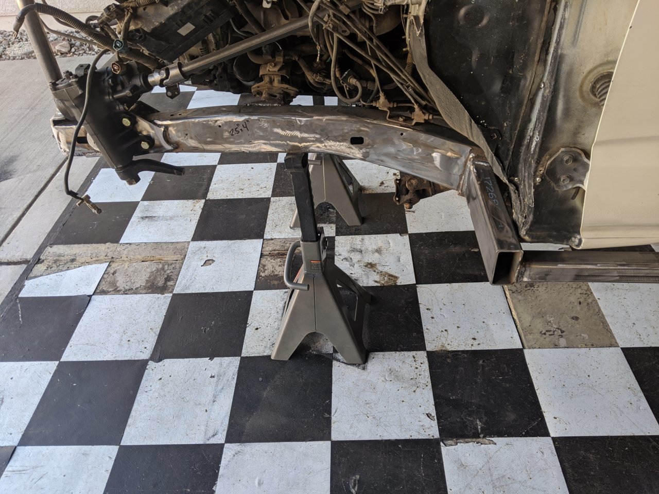

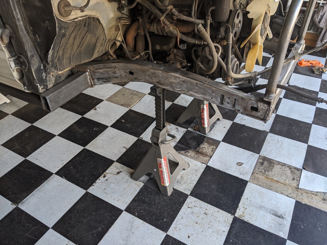

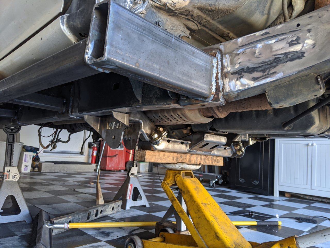

    Not a whole bunch. Got the Sterling shafts pulled, gear install this upcoming weekend.
    Cut out factory crossmember, WFO checked for clearance. Feels like cheating to use a prefabbed part, but I don't feel like messing with this section too much... Plus the crossmember has link mounts built in.

  17. Mar 10, 2020 at 6:37 PM
    #77
    Wishbone Runner
    Wishbone Runner Because 4R
    Sep 9, 2012
    #86546
    6,345
    James
    CO
    04 SR5 4Runner
    King/Dirt King
    Haha, cheating, I feel you but you saved yourself a ton of time. This guy took me probably 20 hours all said and done.

    Reno NV
    That was the exact idea I had, awesome! I got a good deal for KOTH sale so I can't bitch too much.
    One thing I noticed is how bad I suck at overhead welding. I glanced over and saw my work (first learning MIG) and thought, "WTF is this shit?!"
    That shit was me.
