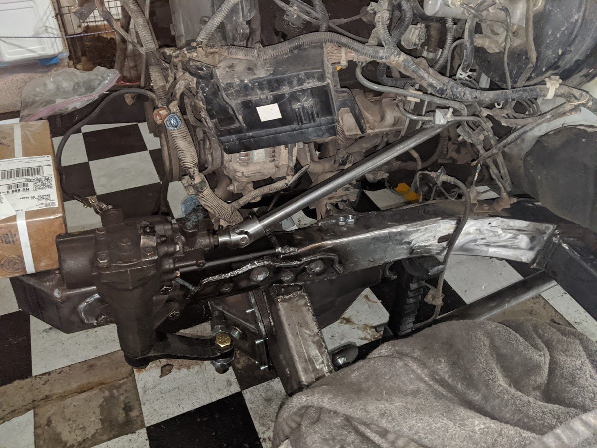

    So, question for all you guys who've been through all this wonton swap mess...
    Brakes.
    I originally cut the brake lines under the cab, going to reflare and route back. However, should I do a single rear line into a proportioning valve then T it at the axle and plug the other rear line?
    I can imagine a new master/booster will be needed at some point, but in theory, this should work yeah?

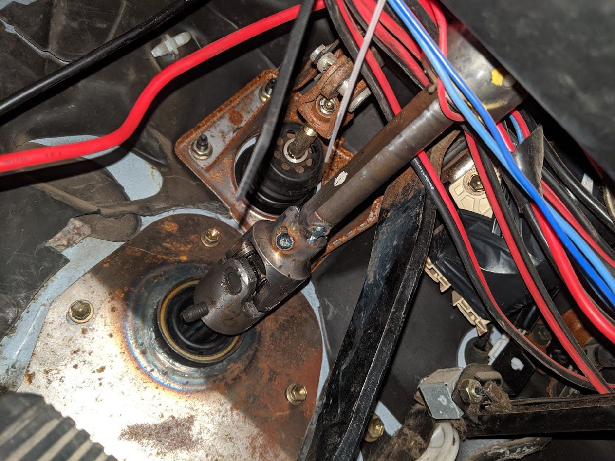

    Also, did some steering shit.

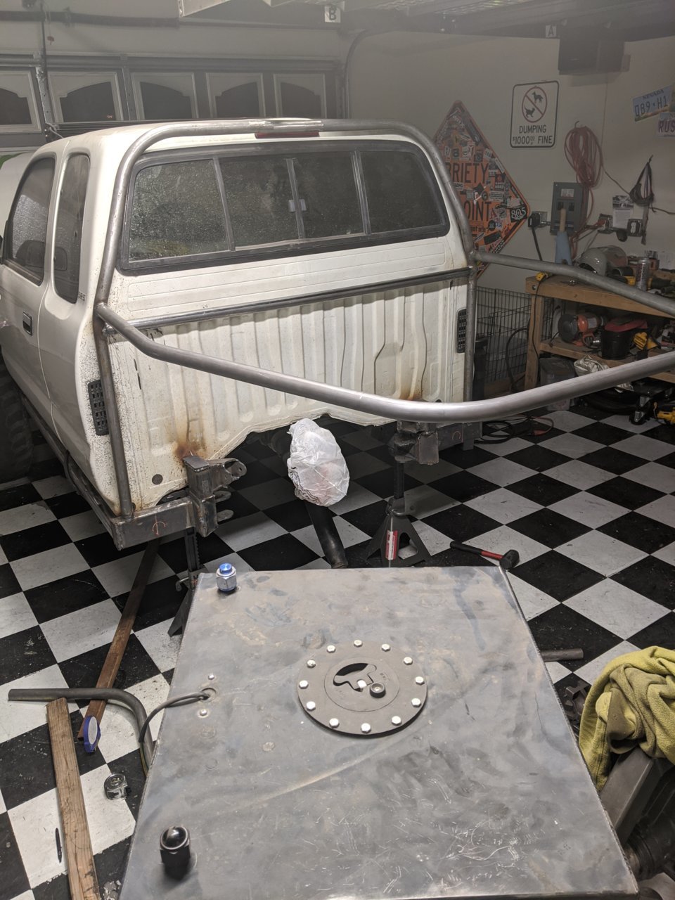

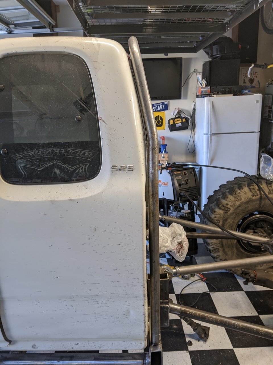

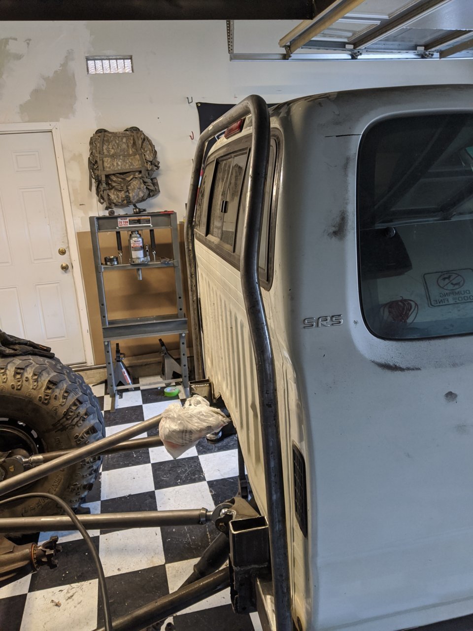

    Okay, round 3 with this god forsaken main hoop.
    Bent up another18' stick of 1.5" Dom. My OCD has me in knots but getting there. Need to bend it forward a touch and level out the feet, but I think the bends contour well enough. Fuck Toyota for the shape of this cab.
    03_taco_IN and slander like this.
  5. Apr 15, 2020 at 10:18 PM
    #125
    plurpimpin
    plurpimpin Well-Known Member
    Jul 31, 2011
    #60895
    2,971
    PDX
    2010 TRD Off Road 4x4
    That’s the best one yet! Looks pretty good to me, like you said a touch of forward bend and i think it’s pretty spot on.

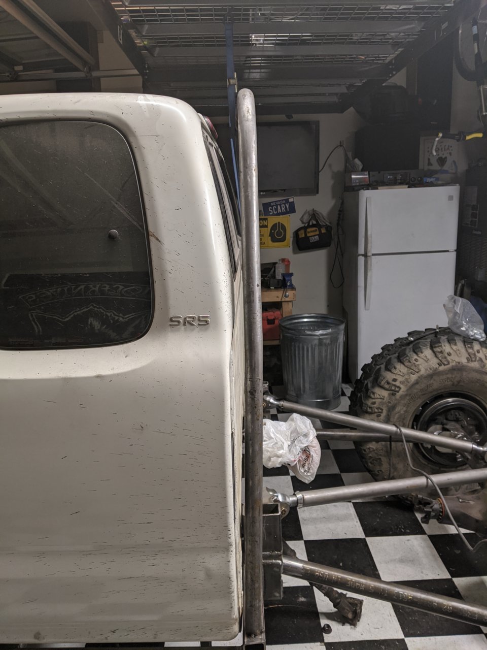

  6. Apr 16, 2020 at 6:44 PM

  8. Apr 16, 2020 at 8:00 PM
    #128
    Running Board Man
    Running Board Man Well-Known Member
    Feb 19, 2017
    #211024
    8,802

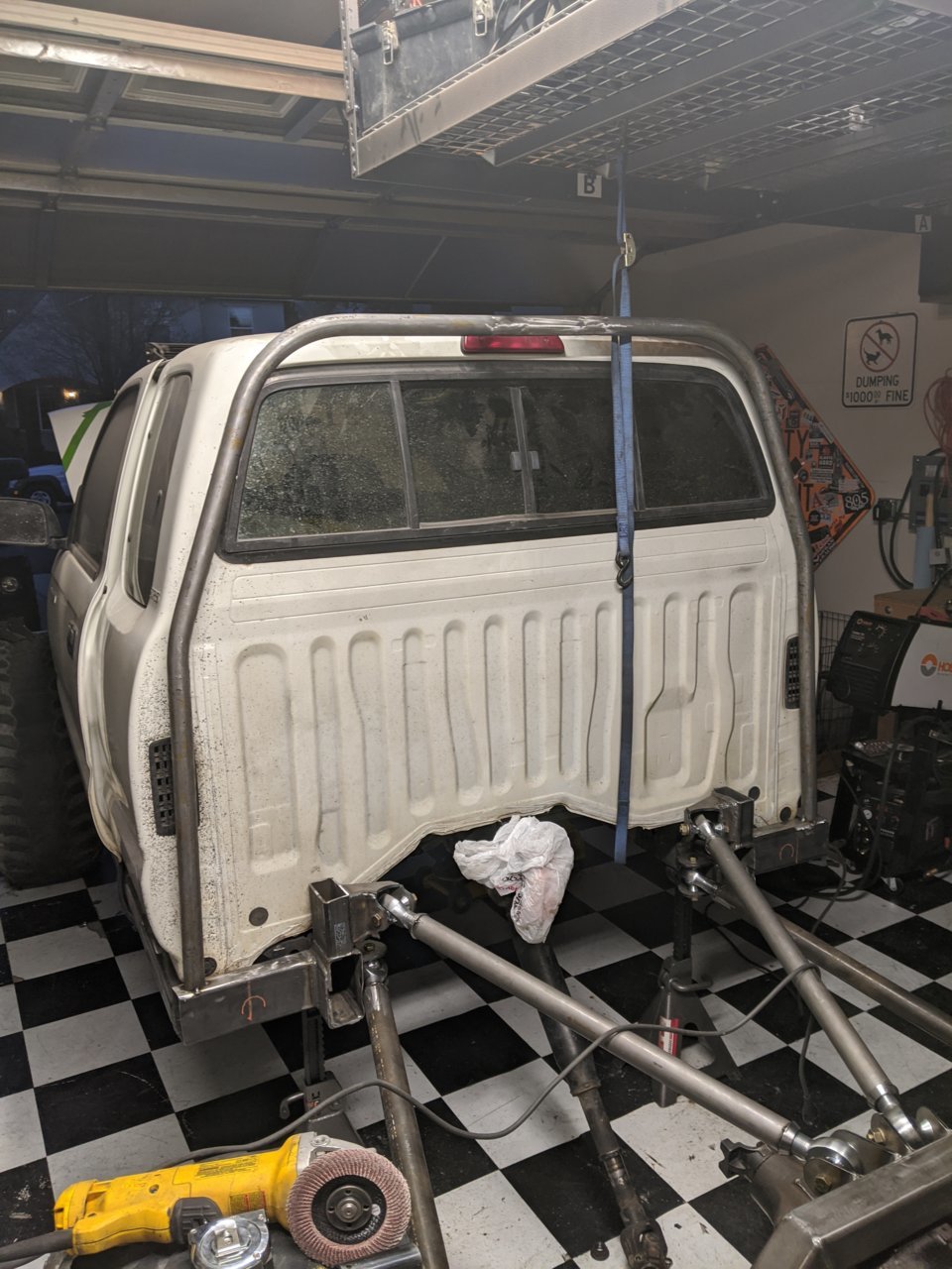

    Is the body hard mounted... i hope they dont come in contact
    esxcli[QUOTED][OP] likes this.

  10. Apr 16, 2020 at 8:24 PM
    #130
    esxcli
    esxcli [OP] Keyboard Warrior
    Jun 25, 2018
    #257452
    1,040
    Sean
    Reno NV
    No, but I'll pull this side forward a touch. Other side has a touch larger gap. ~3/4".
    Once base is burnt in, rachet straps and triangulation will have that and the other side even up.
  11. Apr 16, 2020 at 8:25 PM
    #131
    Running Board Man
    Feb 19, 2017
    #211024
    8,802
    That is very slick
    I never like clean trucks getting cut up and truggied but at least its getting done right
  12. Apr 16, 2020 at 10:27 PM
    #132
    esxcli
    Jun 25, 2018
    #257452
    1,040
    Sean
    Reno NV
    I figured it like this, the main hoop is where everything attaches to.
    Just like anything in life (learning mathematics comes to mind) if you have a solid foundation, everything else has the tendency to just fall into place with less effort.
    But I appreciate that comment. I'll gladly bend a few tubes incorrectly to finally get one right rather than go with something shitty then have to work harder later to make everything work. Plus, there's parts from the already bent tubes that I can use for gussets and triangulation.
    It's the small victories sometimes...

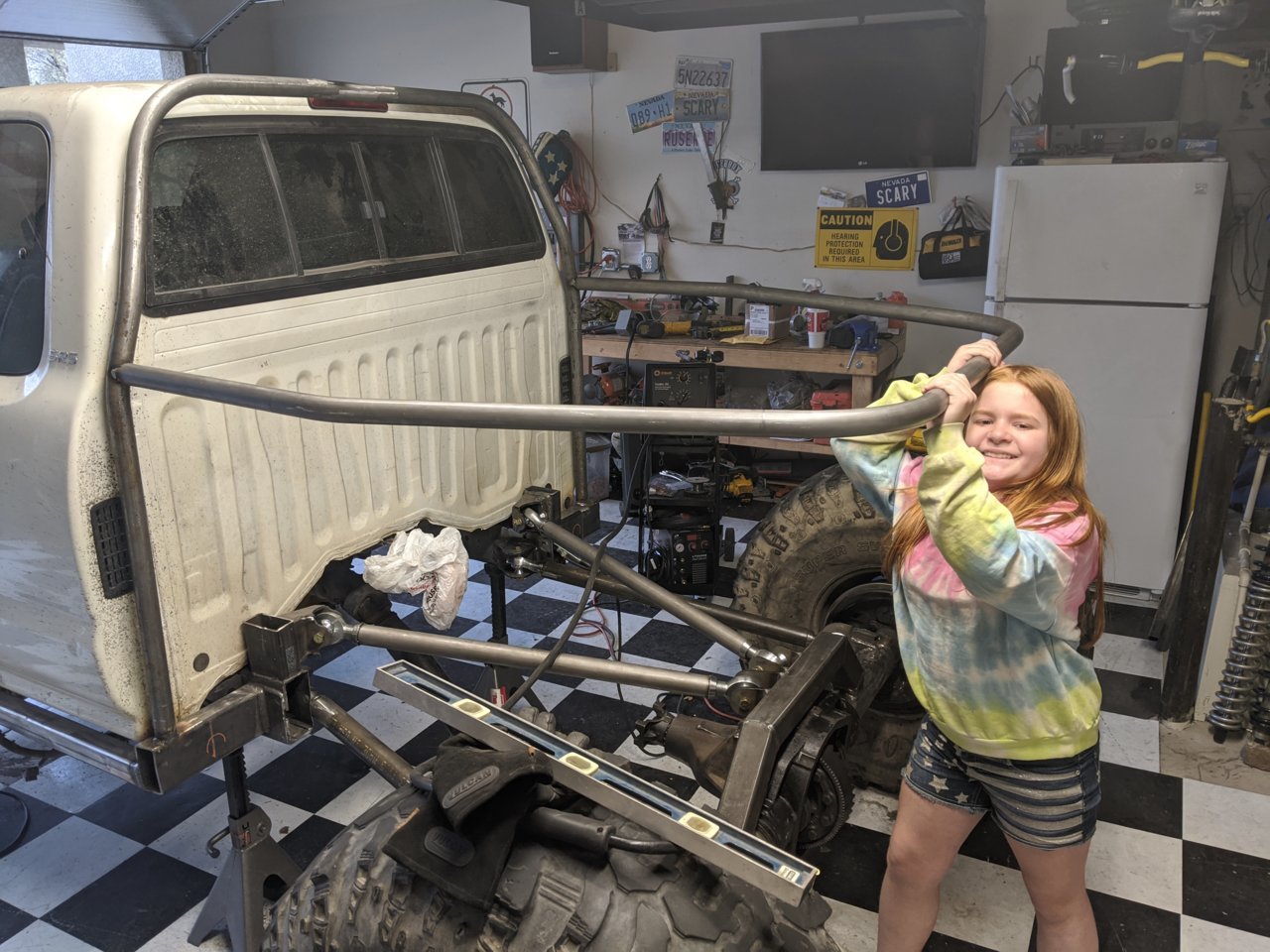

  13. Apr 17, 2020 at 8:31 PM
    #133
    esxcli
    Jun 25, 2018
    #257452
    1,040
    Sean
    Reno NV

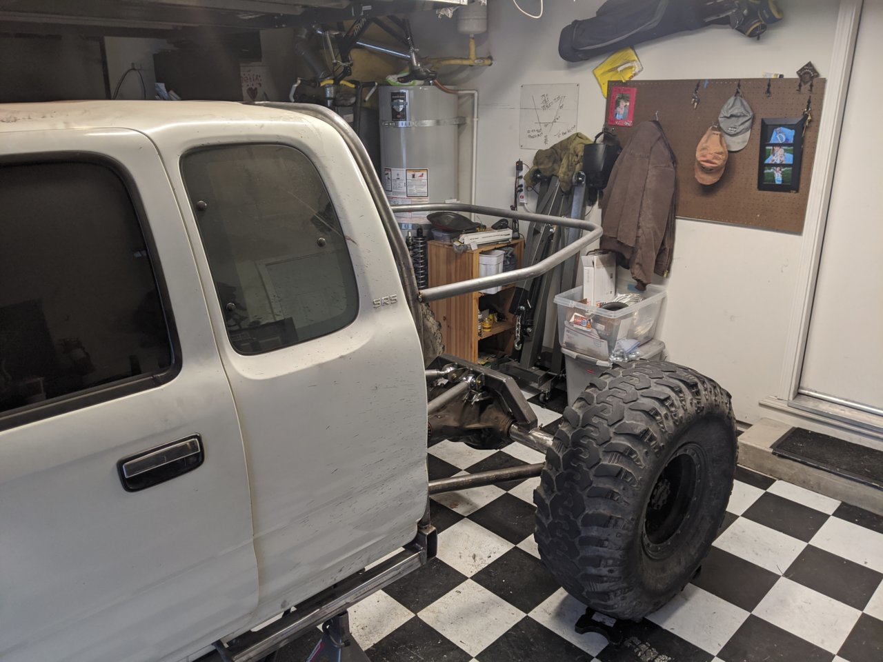

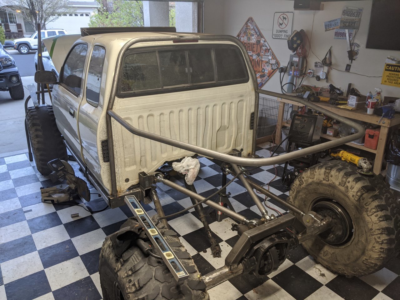

    Got some help from my 12 year old.
    Now that the difficult bends are done... It's time to start mounting shit.

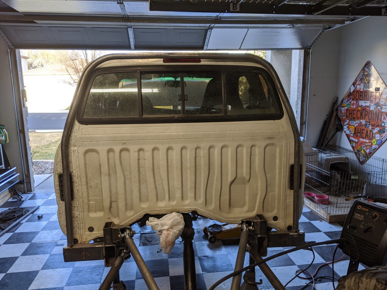

  14. Apr 18, 2020 at 2:48 PM
    #134
    esxcli
    Jun 25, 2018
    #257452
    1,040
    Sean
    Reno NV

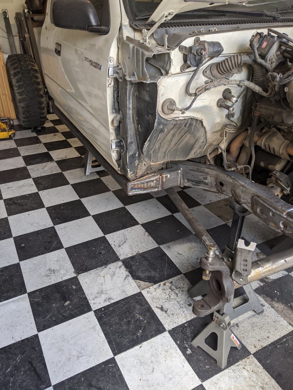

    Just in case I want to go to 44s. Also capped the rear mounts.

  15. Apr 18, 2020 at 2:58 PM
    #135
    avw4x4
    avw4x4 Well-Hung Member
    Oct 20, 2013
    #114886
    2,414
    (M)Andrew
    Rochester, NY
    2003 Yota
    ...loading....
    Rear is coming out really nicely! Definitely a lot of trial and error there but it paid off for sure!
    Running Board Man and esxcli[OP] like this.
  16. Apr 18, 2020 at 10:12 PM
    #136
    esxcli
    Jun 25, 2018
    #257452
    1,040
    Sean
    Reno NV

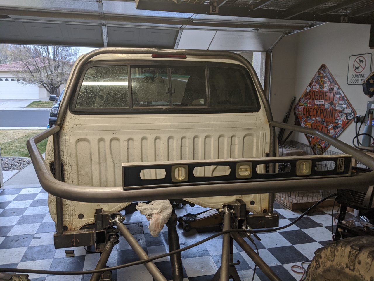

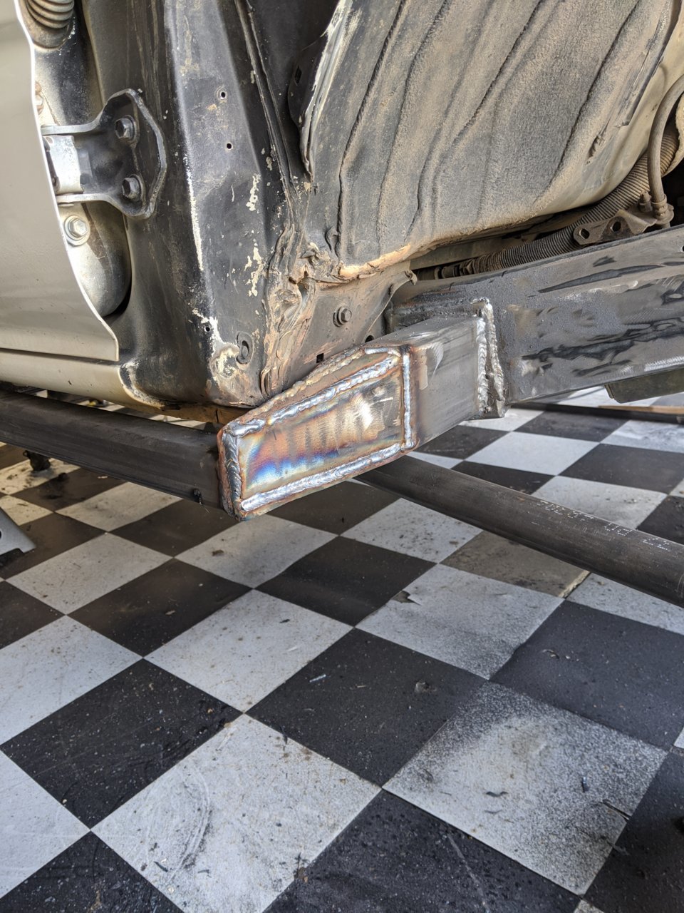

    Fuckin hell, it was one of the days to find all the things that need capping or some sledge adjustments. I was concerned about rubbing on my slider ends in the front... Not anymore.
    • Bent those in and welded solid.
    • Capped the rear slider ends.
    • Capped the rear link mount towers.
    • Trimmed the rear frame for lower link clearance.
    • Capped that fucker too.
    • Got a crossmember burnt in
    • Cleaned up some welds from my first few weeks
    • Bent up tube for lower bed cage
    I would kill for a jd² right now. This little bender works out to one degree per pump of the little 8 ton bottle jack, but the 7 inch bend radius makes shit way hard to measure. We'll see how well I did tomorrow when I cut.
    Felt like I'd be moving faster than I did. I got texts all day for invites to Moonrocks. Sigh...
    cruiserguy and slander like this.
