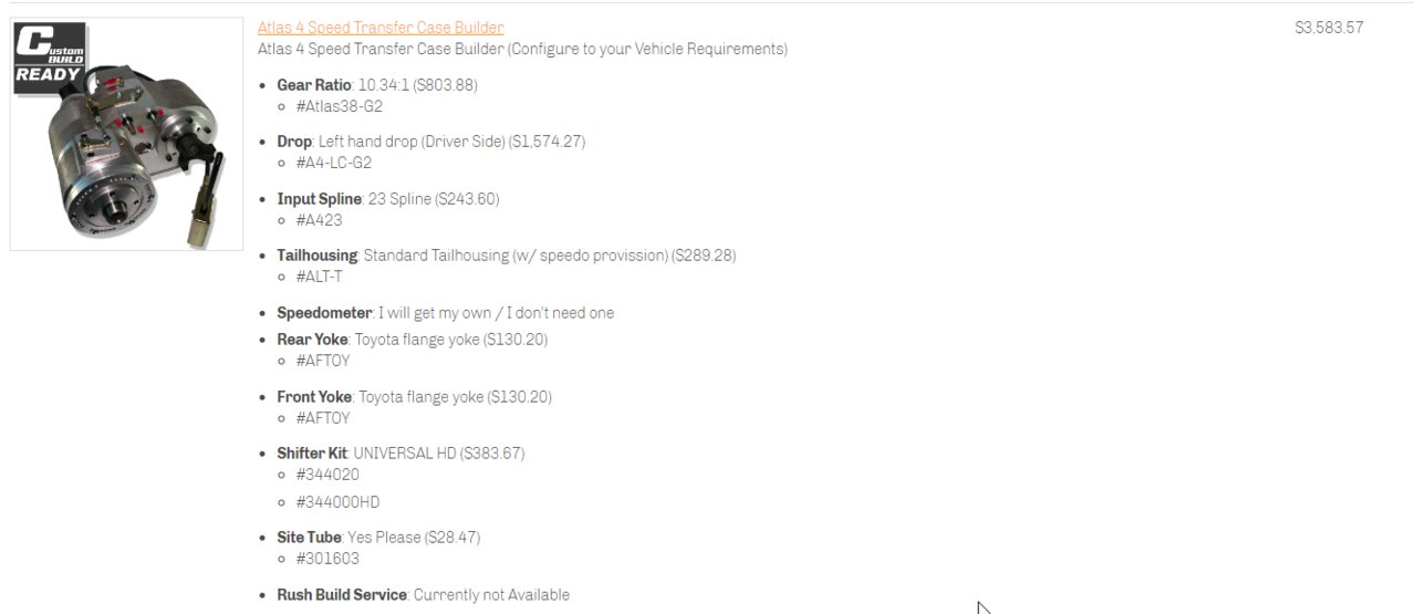

    This look about right? Plus 365 for adapter 23 spline.
    Annnnnnd another 300ish for the cable shifters. lol

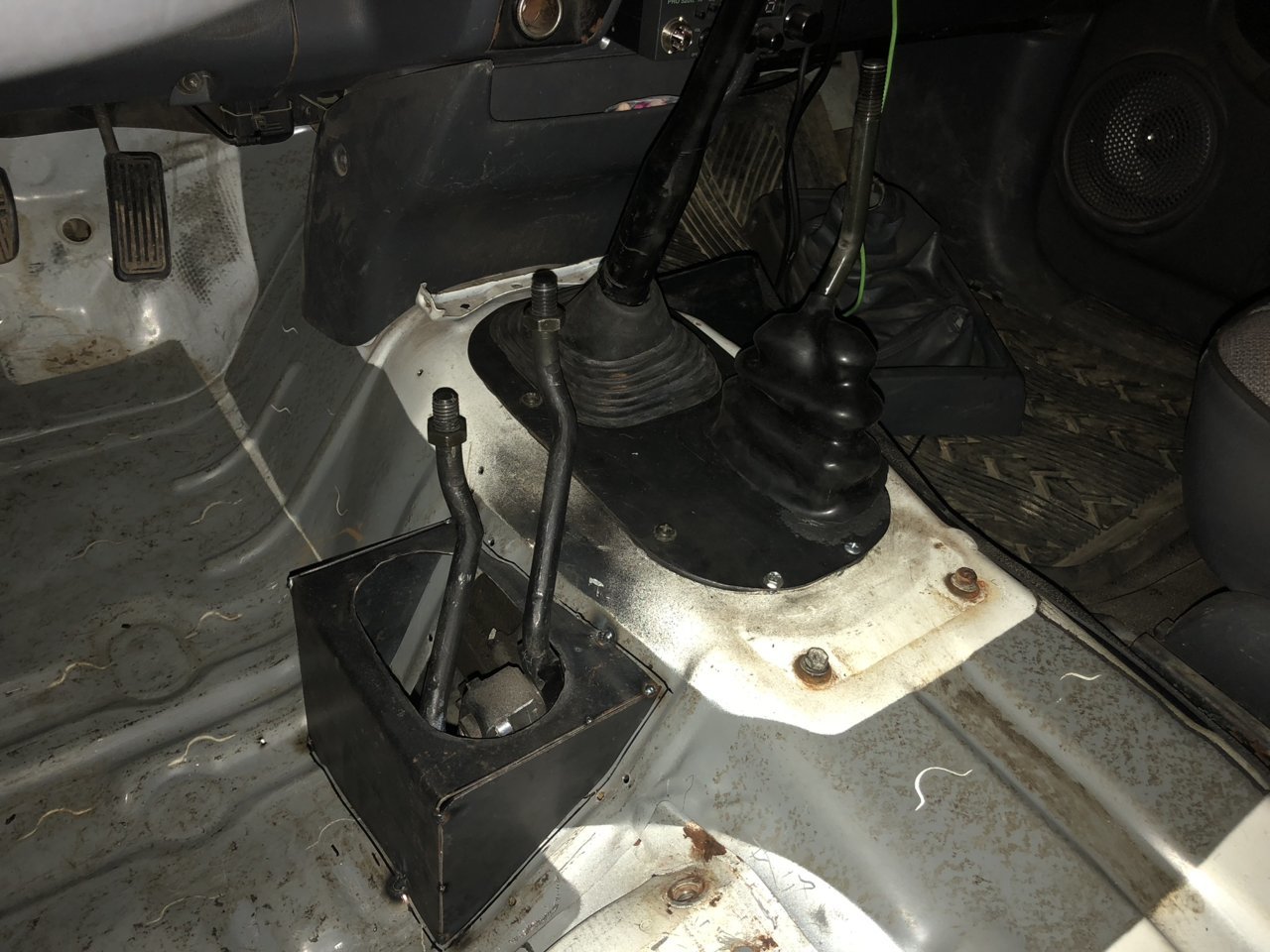

    Yeah, you will likely need the cable shifter. Also be sure to verify the flange pattern with your driveshaft, their triple toy flange didn't fit mine. You can cut the site tube too, 2.5 qts out, 2.5 in.

    Since it's a trail rig, dont mess around with TOY bullshit cases and crawlers. Get the atlas and do it right the first time. My friend got his 4 SPD through jess at high angle driveline and got a nice discount, this was also 10yrs ago.

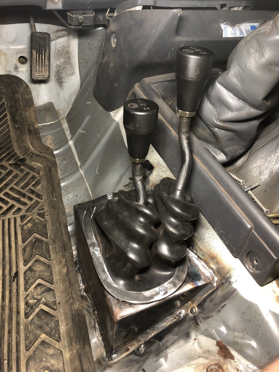

    You don't *need* cable shifters with the atlas 4-speed IMO. I went with the mechanical linkage on mine, and was able to bring them up right next to the factory shifters. My leg barely rubs the far left one, but that can be fixed... I'm just lazy and haven't done it.
    Reason I mention this is I've heard quite a few stories of how much of a pain it is to get cable shifters to work correctly.
    FFF77F51-07AF-4625-98D4-C880810118BB.jpg DD2466FE-41D3-4BF9-BDD8-080096ABBBB0.jpg

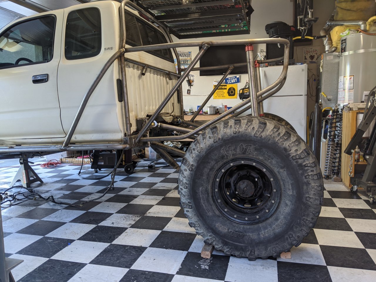

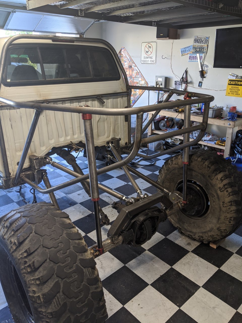

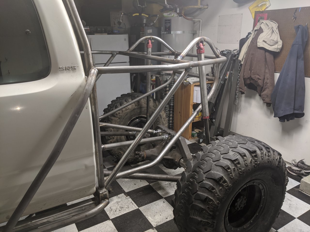

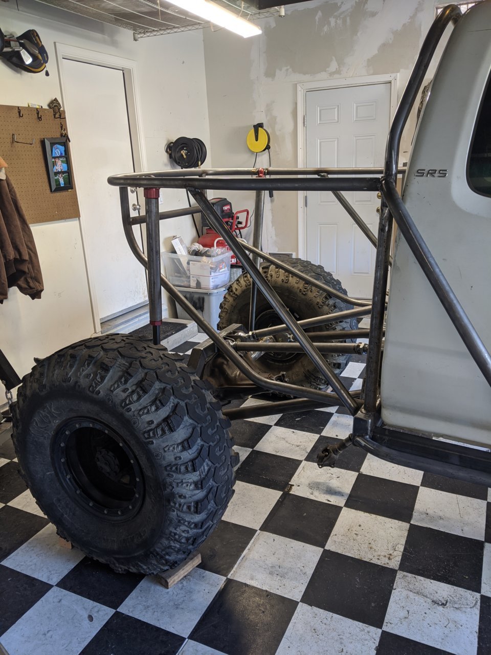

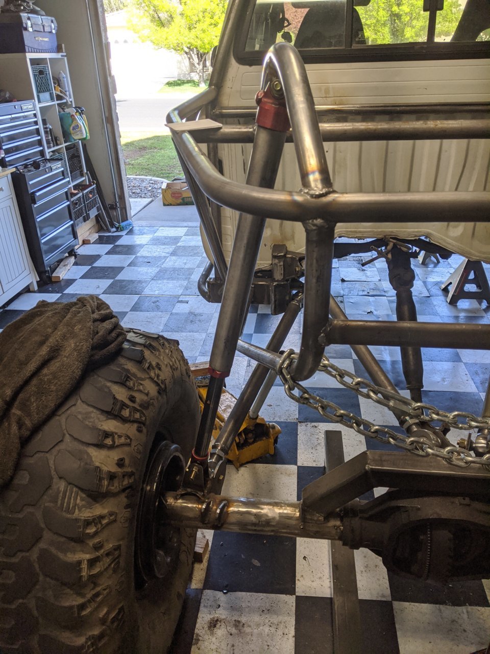

    Hated the shock angles. So...I redid all of it
    razhick4x4, jubei, POOLGUY and 5 others like this.

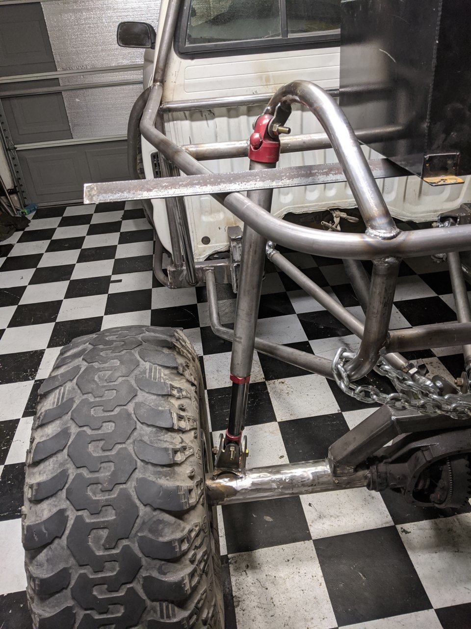

    Lower shock mounts changed. I need to drop the tops by 1.5 inch.
    Orders shock tabs because I'm tired of the plasma. :)

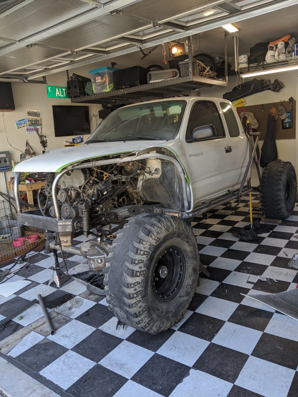

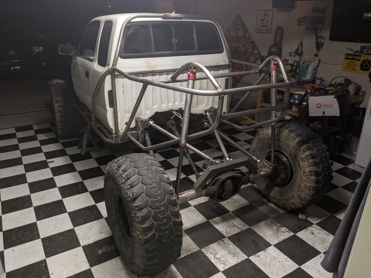

    Last rear shock mount change for front. Everything clears at all angles.

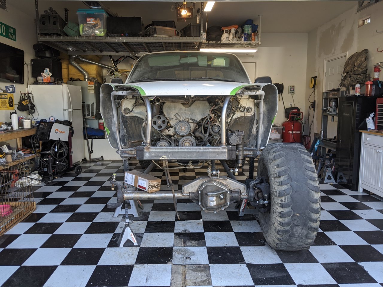

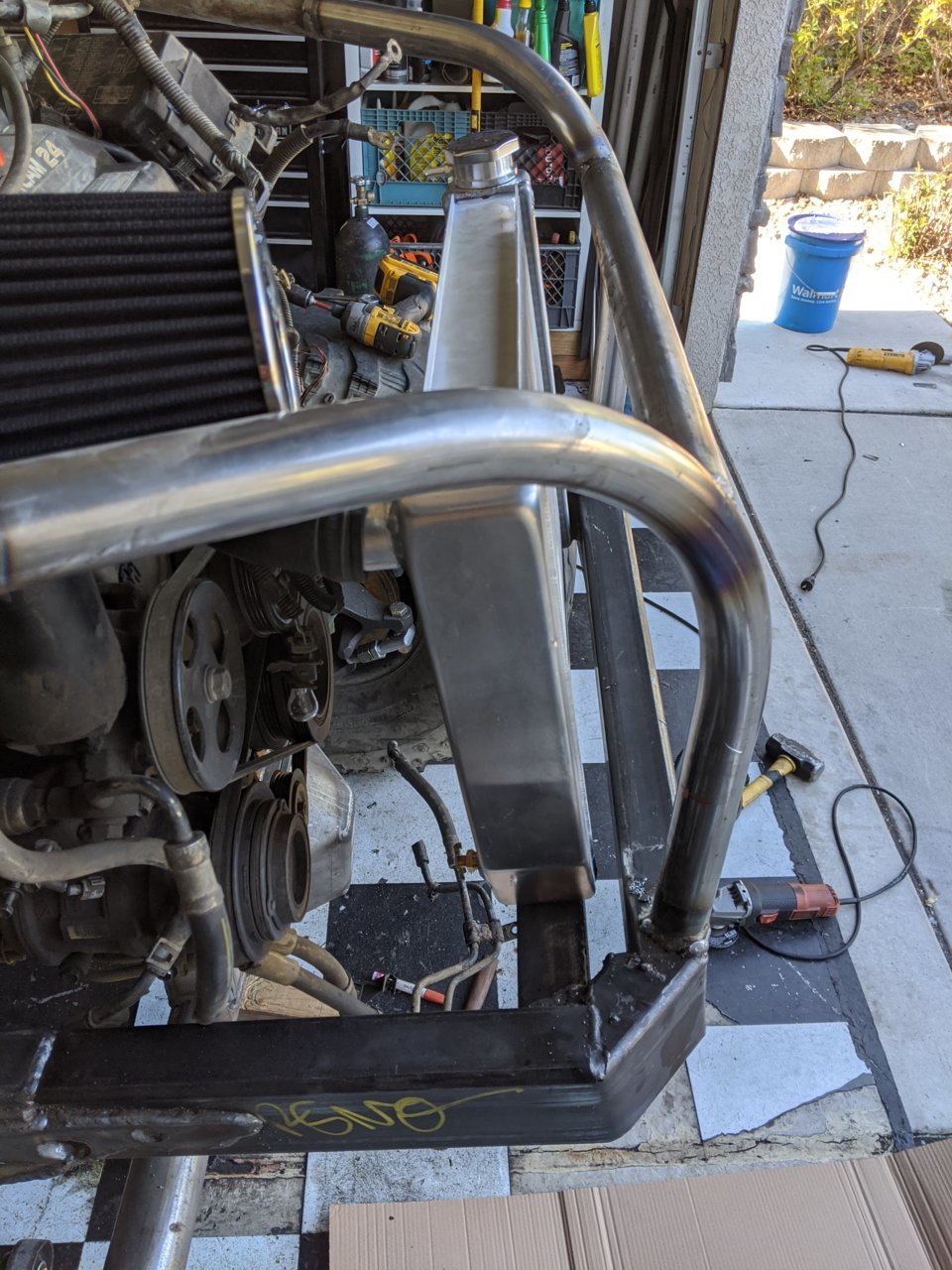

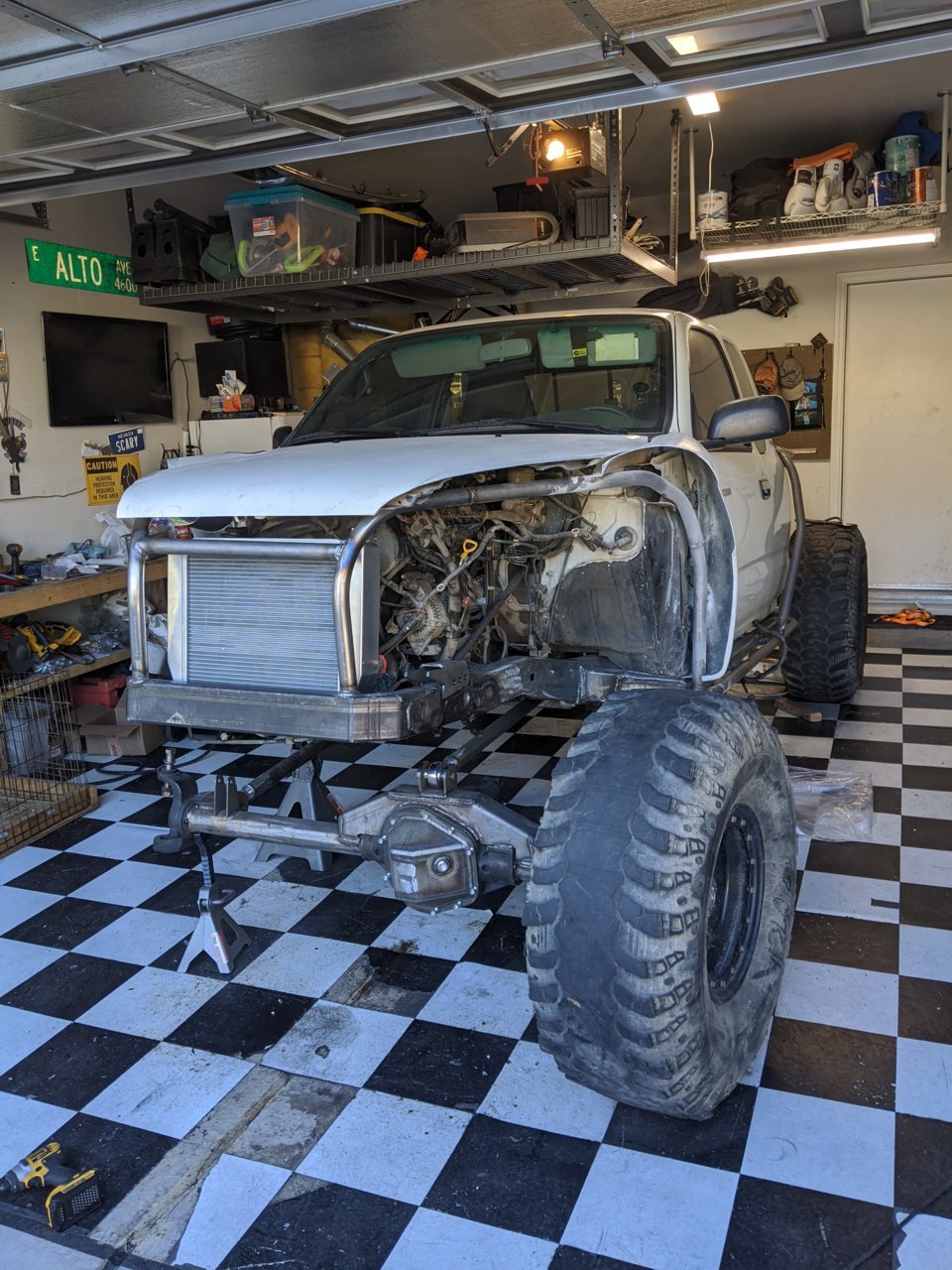

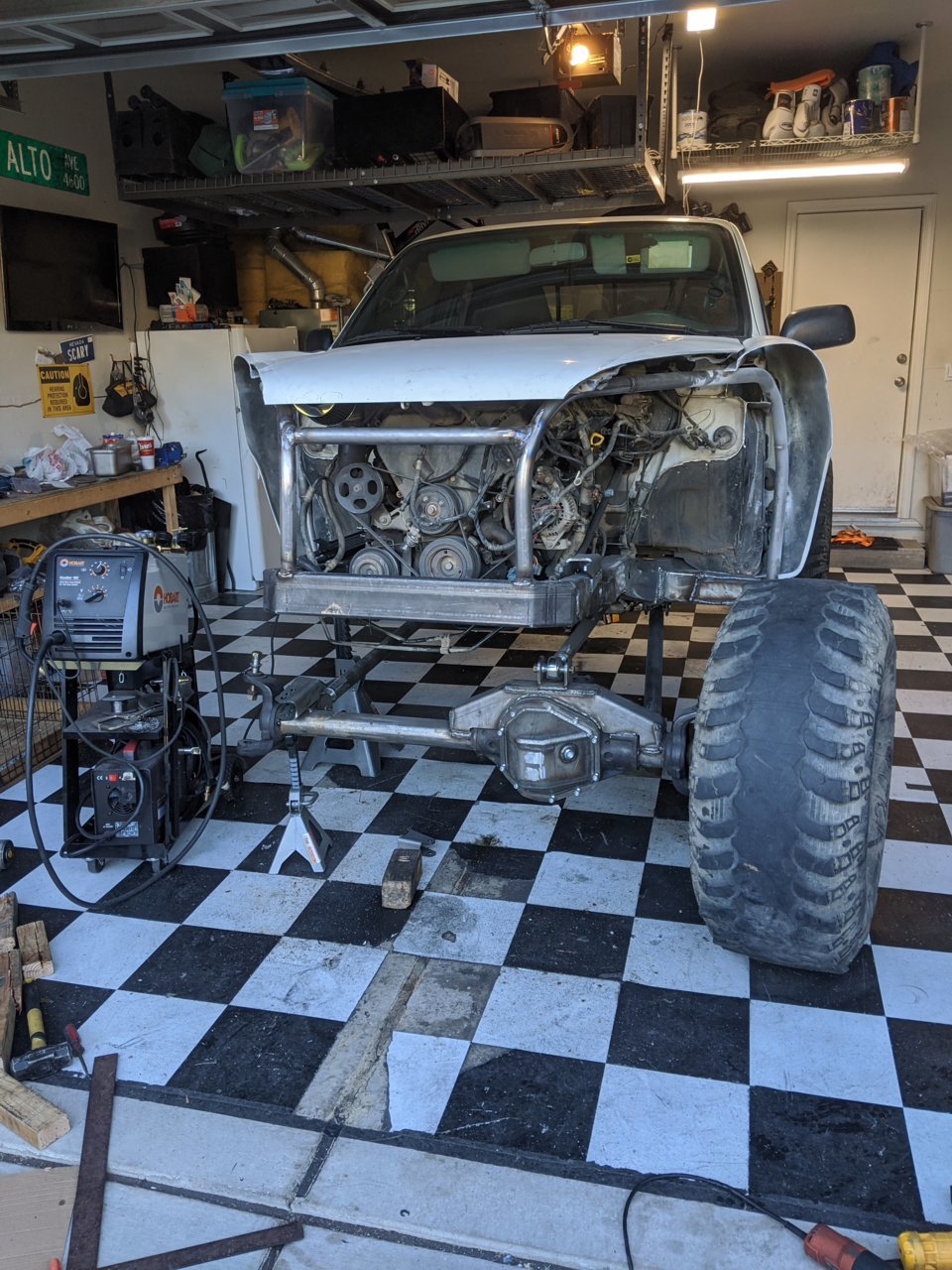

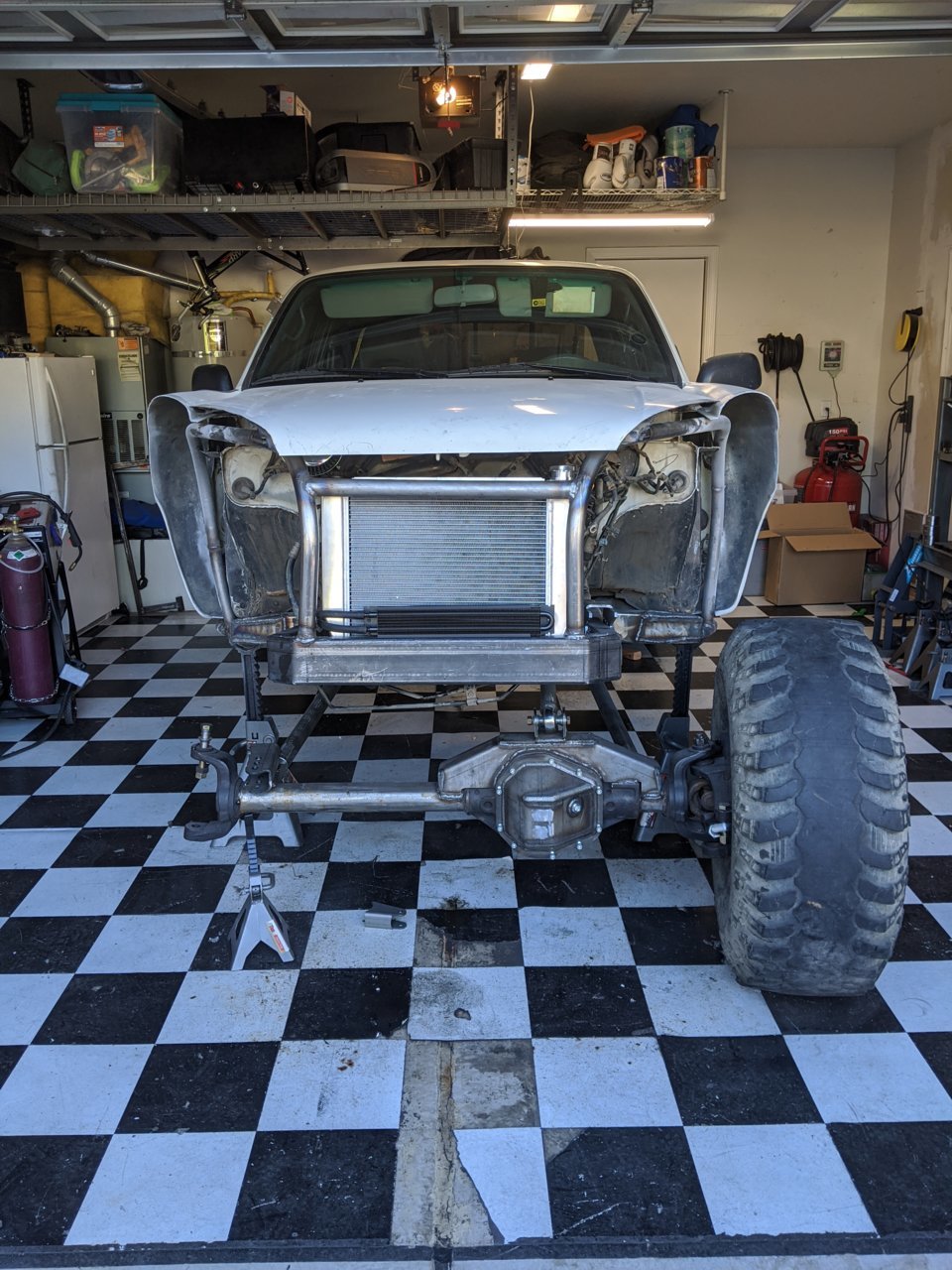

    My crossmember came out crooked. Fucking thermodynamics. I'm not changing it. Also got the new radiator and trans cooler installed.

    Radiator looks beefy, what’d you go with? Does it have an internal trans cooler like the stock ones or is the external taking all of the brunt?
    I’ve been eye balling the champion one myself even before attempting this business. Can’t have too much cooling when crawling.
    esxcli[OP] likes this.

    If you dont paint fangs on that radiator and paint the wheel wells to look like eyeballs this entire build will be deemed a complete failure :D. This front end shot makes your truck look like a cobra or a menacing looking monster.
    Physics is a bitch!! Its amazing watching the parts pull themselves in different directions based on the weld patterns.

    Griffin racing radiator, was the only place I could choose by dimensions instead of fitment. Went with the 15x22.5x3" and then got that little trans cooler. I might use that with my power steering and go a little bigger on the trans cooler.
    Sigh, wait until I sheet the inner fenders lol.
    I was mad as fuck about that crossmember, so I fixed it.
    Grrrrrr.

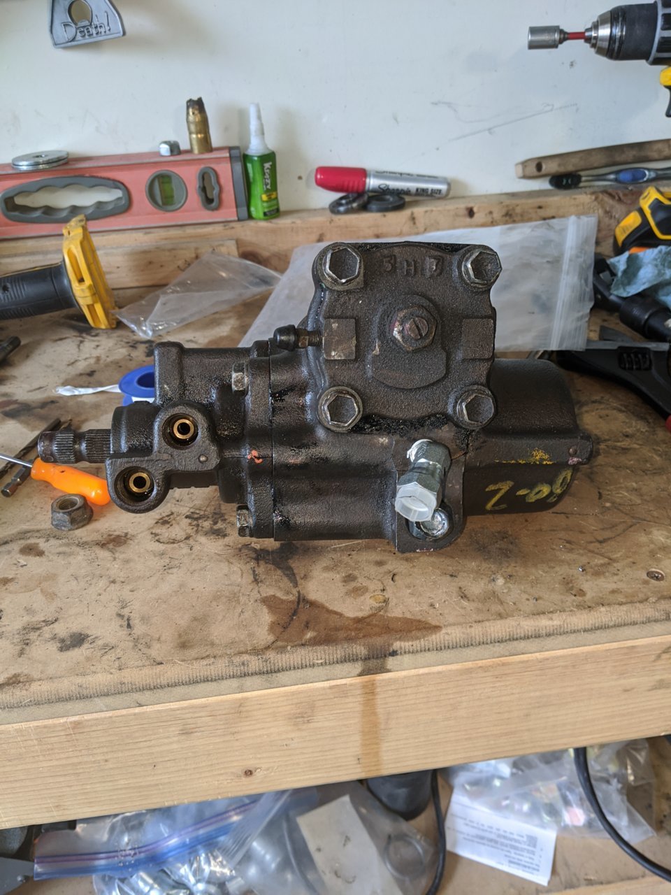

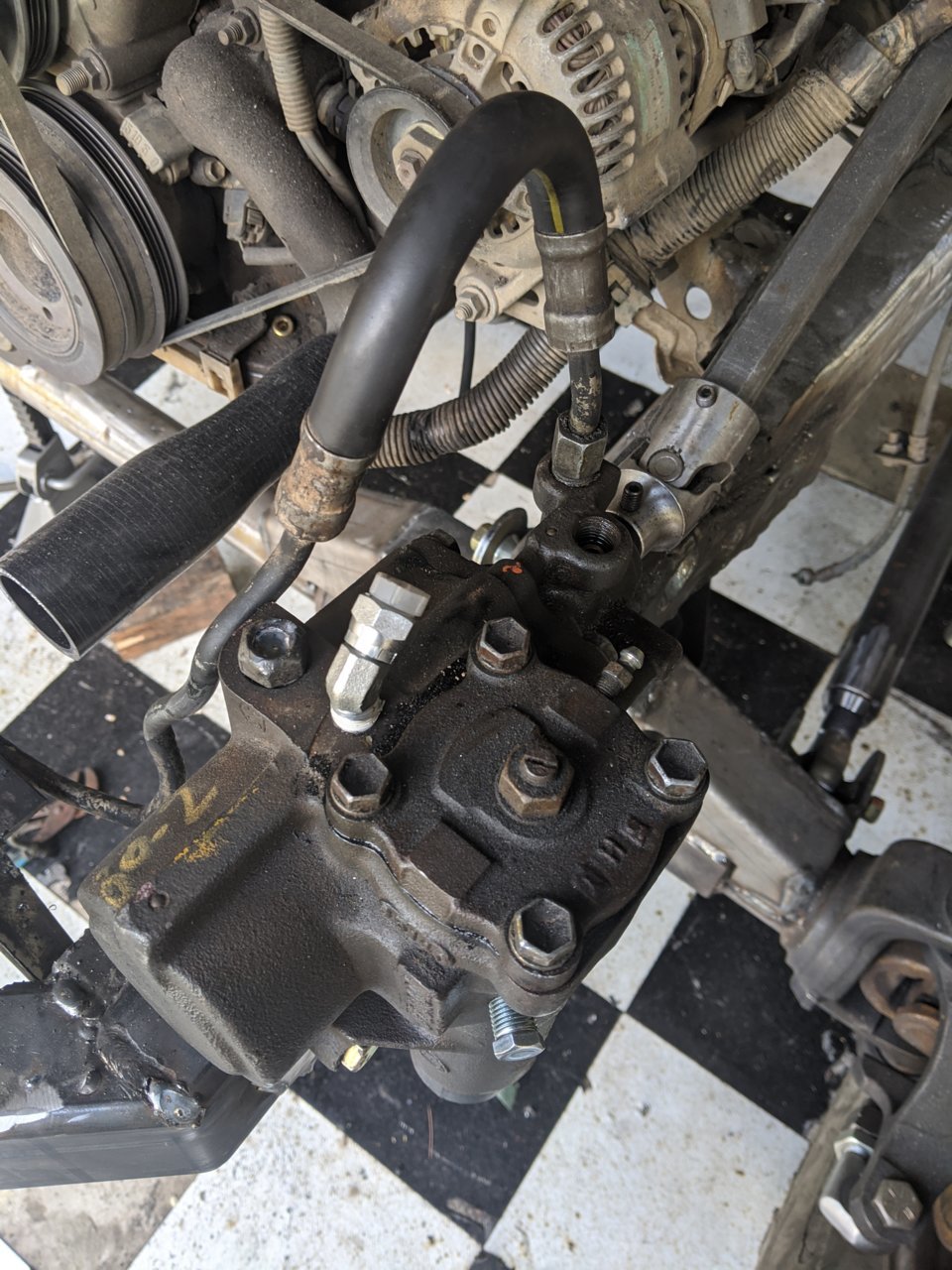

    Light day of tapping for hydro assist.

    Oooooo you got one of the boxes with a bleeder, nice!

    Yep, however fuck that 10mm hex centering valve nut.

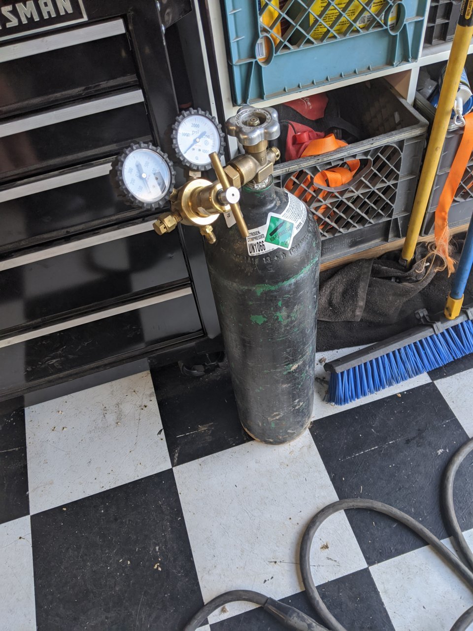

    Got the box installed-ish. You can see my 10mm hex to 19mm conversion. Waiting on fittings and trying to sort out brake lines this weekend. Got the nitrogen tank and regulator.... But waiting on fill tool for shocks. Notice a theme?
