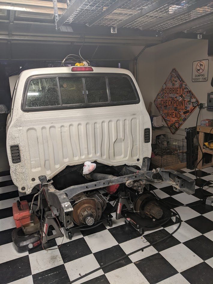

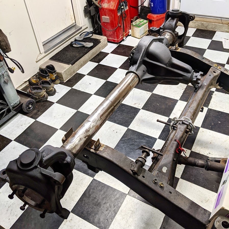

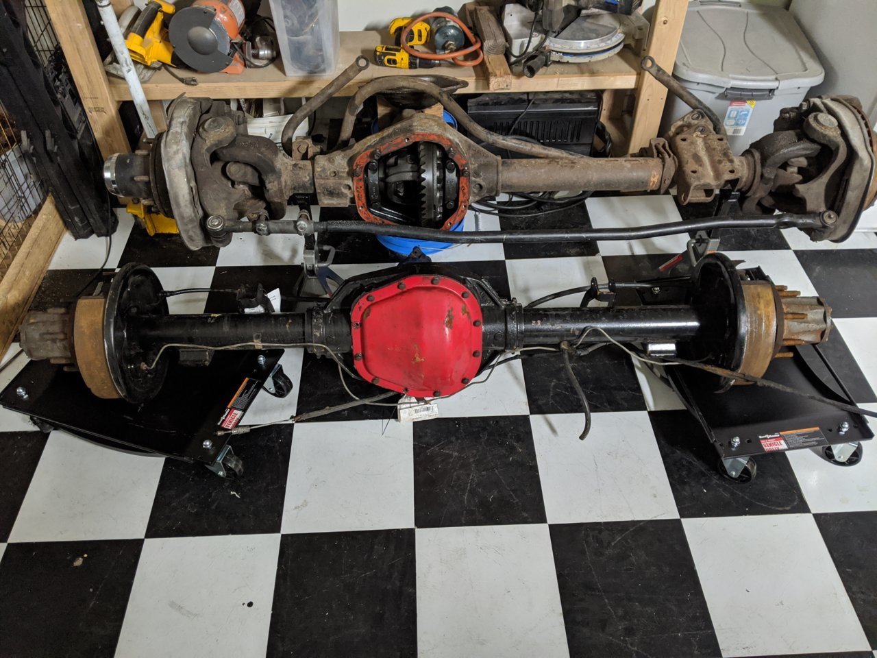

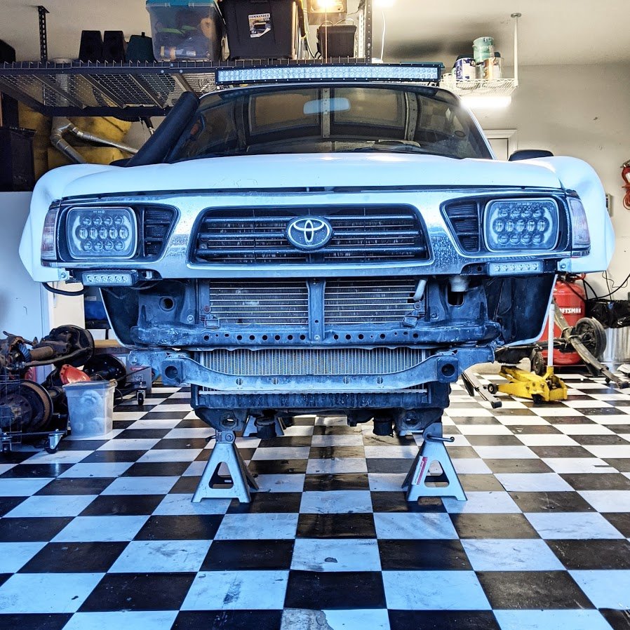

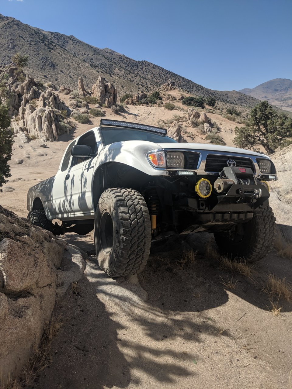

    So... Umm, had too much fun wheeling this summer, but really hate IFS. Here's some shots from this summer into winter.
    So it's Dana 60 one ton time! I suppose I'll pick up this thread again, since I'm doing more than wheeling every weekend now. :)

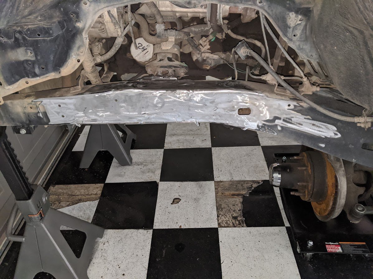

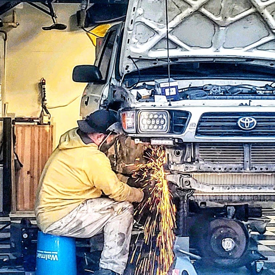

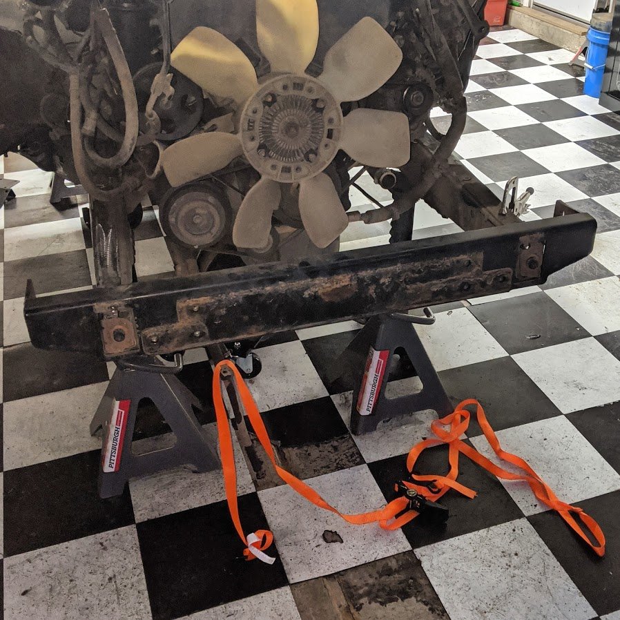

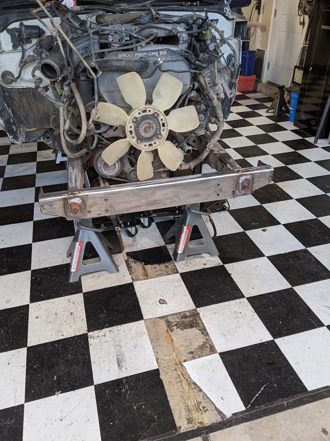

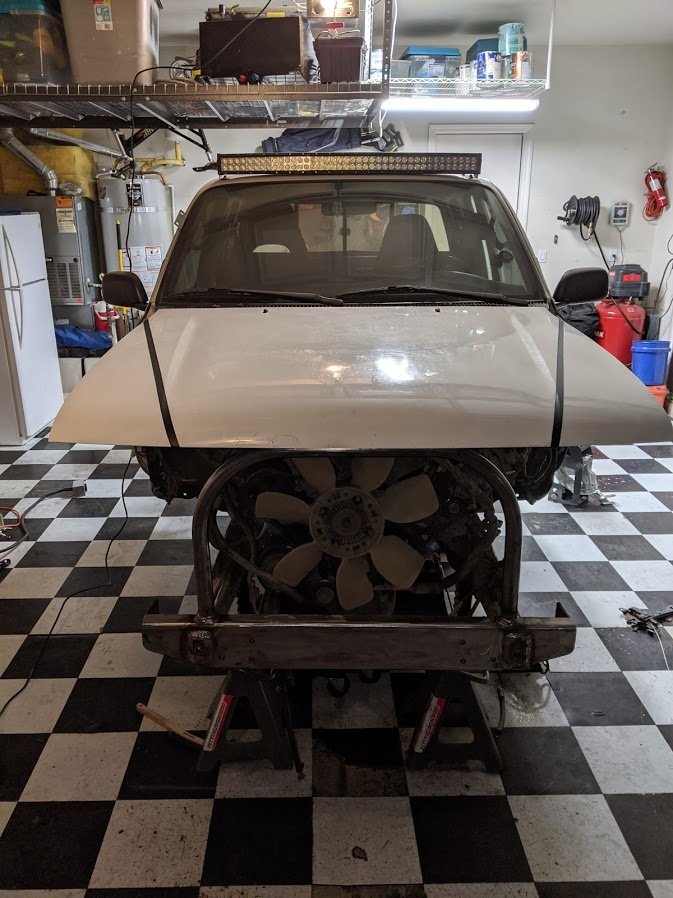

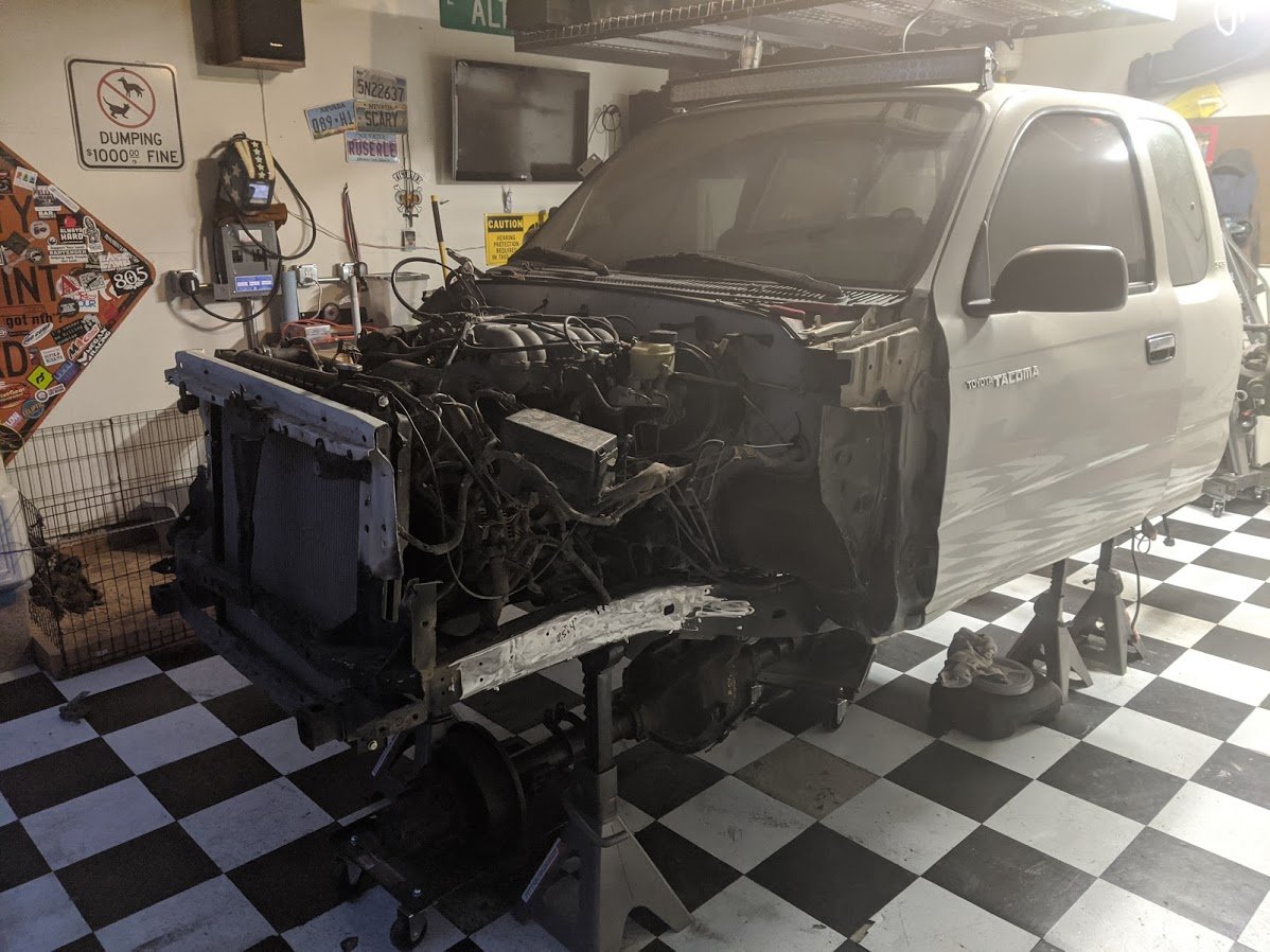

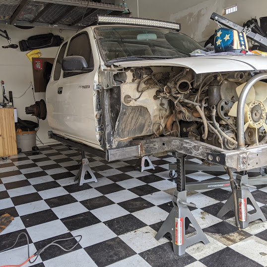

    -Yoinked all the front IFS bullshit out.
    -Cut the rear so it's easier to walk around in my tiny garage, left enough to put axle on (frame = redneck workbench)

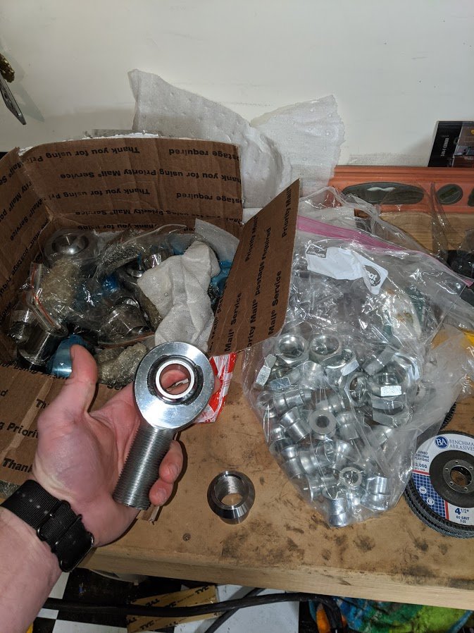

    -Got a killer deal on 1.25 Heims for links (3 link front, 4 link rear)
    -Got gears delivered for the dana60/sterling 10.25 (5.38 Yukons)
    -Cut out the inner fenders, removed the radiator, going to use electric fan for cooling and find a shorter radiator (2wd Auto is 18.5" tall)
    -Repurposed my old winch mount from TrailGear for front crossmember, burned in (lots of gap fill welding)
    -Bent up tubing for radiator core mount
    -Pulled apart the D60 for regear and truss weld
    -Got the steering shaft yanked out
    -Waiting for rear sump oil pan
    -Found set of 16" beadlock steel wheels with roller 40s (bald) for $150
    -Grabbed metal to fab up sliders (2" x 0.25" wall square tube)
    -Picked up 16" 2.0 FOA dual rate coilovers and 16" Racerunner Nitro shocks
    Need to:
    Strip the Sterling, regear both axles weld spiders and plate, manual hubs on d60, fab up axle trusses + link brackets, come up with a solution for rear linkmount/crossmember/transmission mount all-in-one, motor tube with fender mounts, shock towers for both, tube rear, mount fuel cell and wire up external pump, wire up battery relocation (next to fuel cell) and cover with plastic boat battery box, change oil pickup and dipstick to rear sump, re-run brakelines (maybe change out master), sort out IFS steering box mount and tack the wheel side steering shaft (spline shaft size is wrong), remove my air bag before I get a black eye, and buy 2" x 0.25" wall DOM for suspension links, get 150/200 springs for front FOAs, fill 200psi on the RR Nitros. Rewire lights (since I'll no longer have headlights I'll be using the 4" LED pods).
    Lastly, I'll need to get an effin trailer. :)

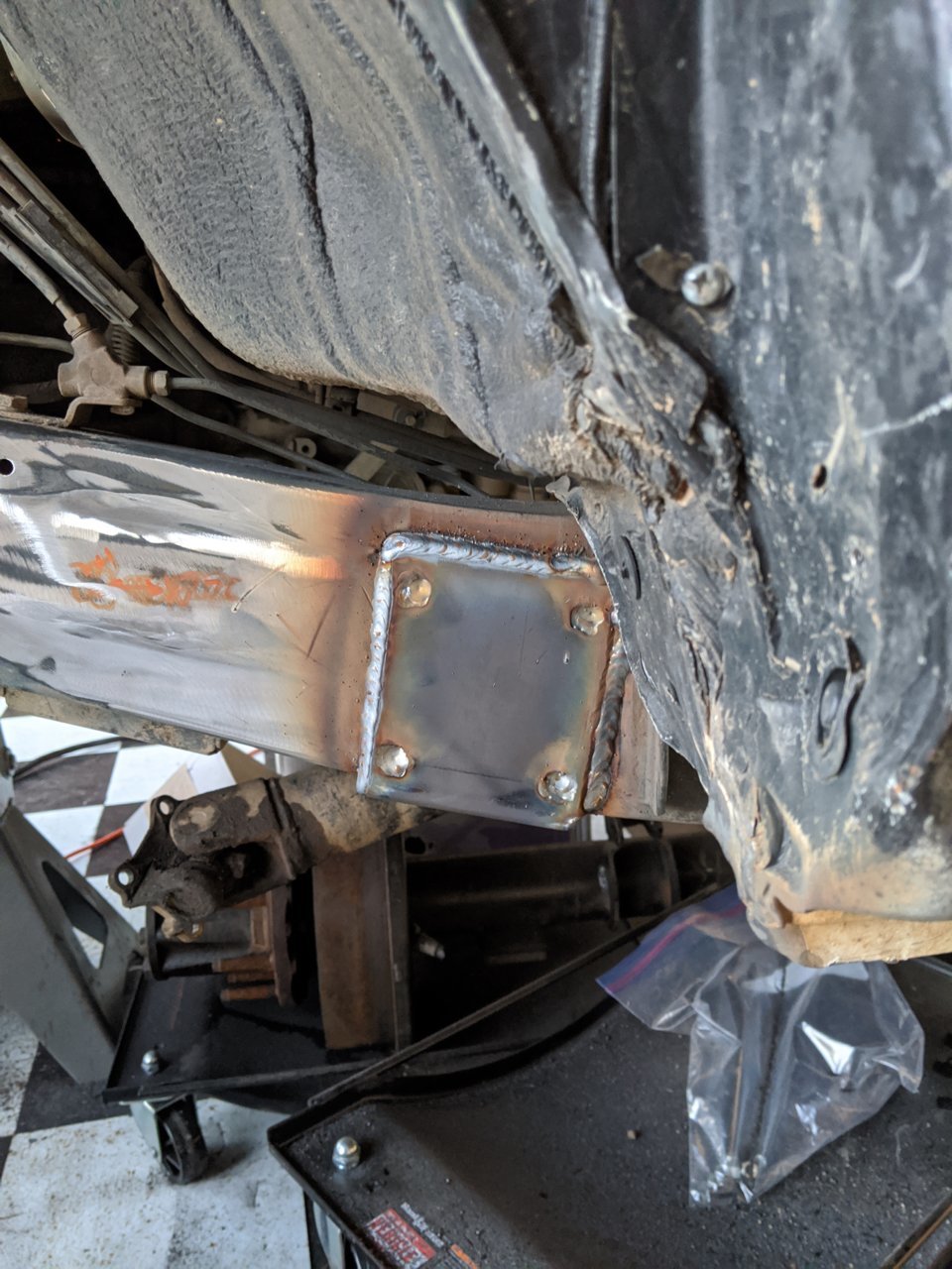

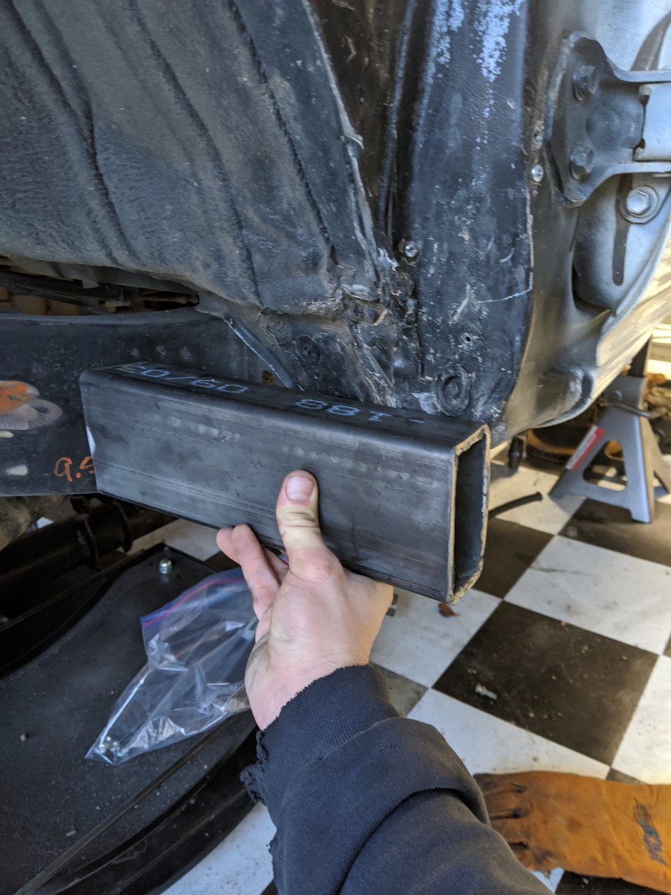

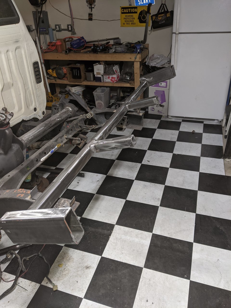

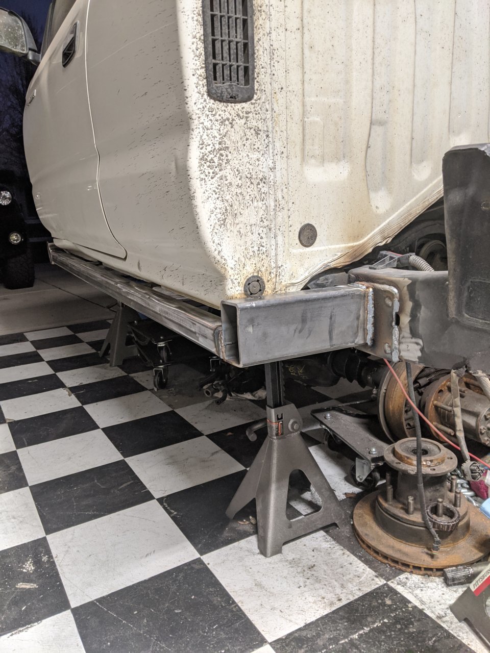

    Hard to get things done with a 3, 5 and 11 year old constantly getting into stuff. Going with 2x4" 3/16" wall for the base of my sliders, welded to 90° plates so I don't peel back the thin ass frame.
    Got the sliders mocked up, but I didn't like the fit, so I'll flush mount across the bottom and build the engine and bed cages off that.
    There angle on the plate was kind of off, so there's some undercut, but nothing some clean up work can't solve. Gears go into axles tomorrow. 5.38 of deliciousness. :)
    VirusCage likes this.
  7. Feb 9, 2020 at 9:10 PM
    #27
    esxcli
    esxcli [OP] Keyboard Warrior
    Jun 25, 2018
    #257452
    1,040
    Sean
    Reno NV

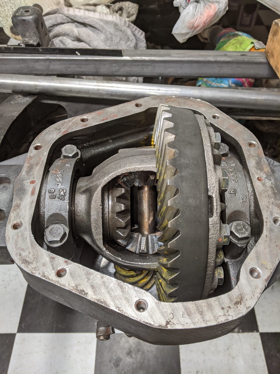

    Got the 5.38s installed in the D60, now I need to drain the 10.25 and install gears back there. Backlash was a bitch. Welded the 4 corners of each side of the spider, gonna throw in some plate and finish the carrier.
    Got some more work done on the sliders. Prepped to paint and weld on to the frame plates.

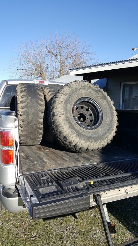

    My wonderful mother picked up my wheels/tires (39.5/13.5/16x10) for me locally down in CA Central Valley. Not too shabby for $150. They will require some cleanup, but not too bad to roll around on until proper meats have been purchased.

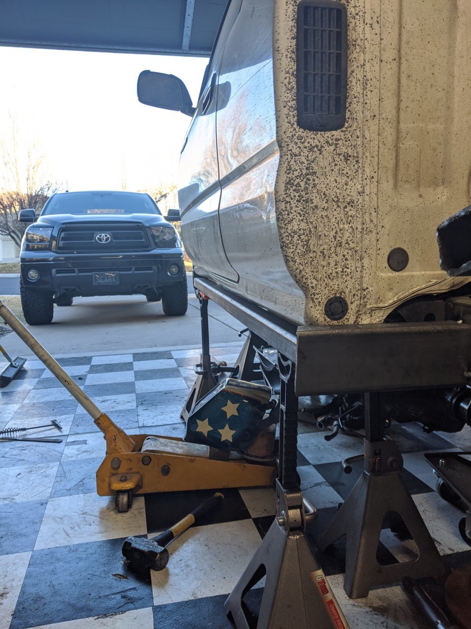

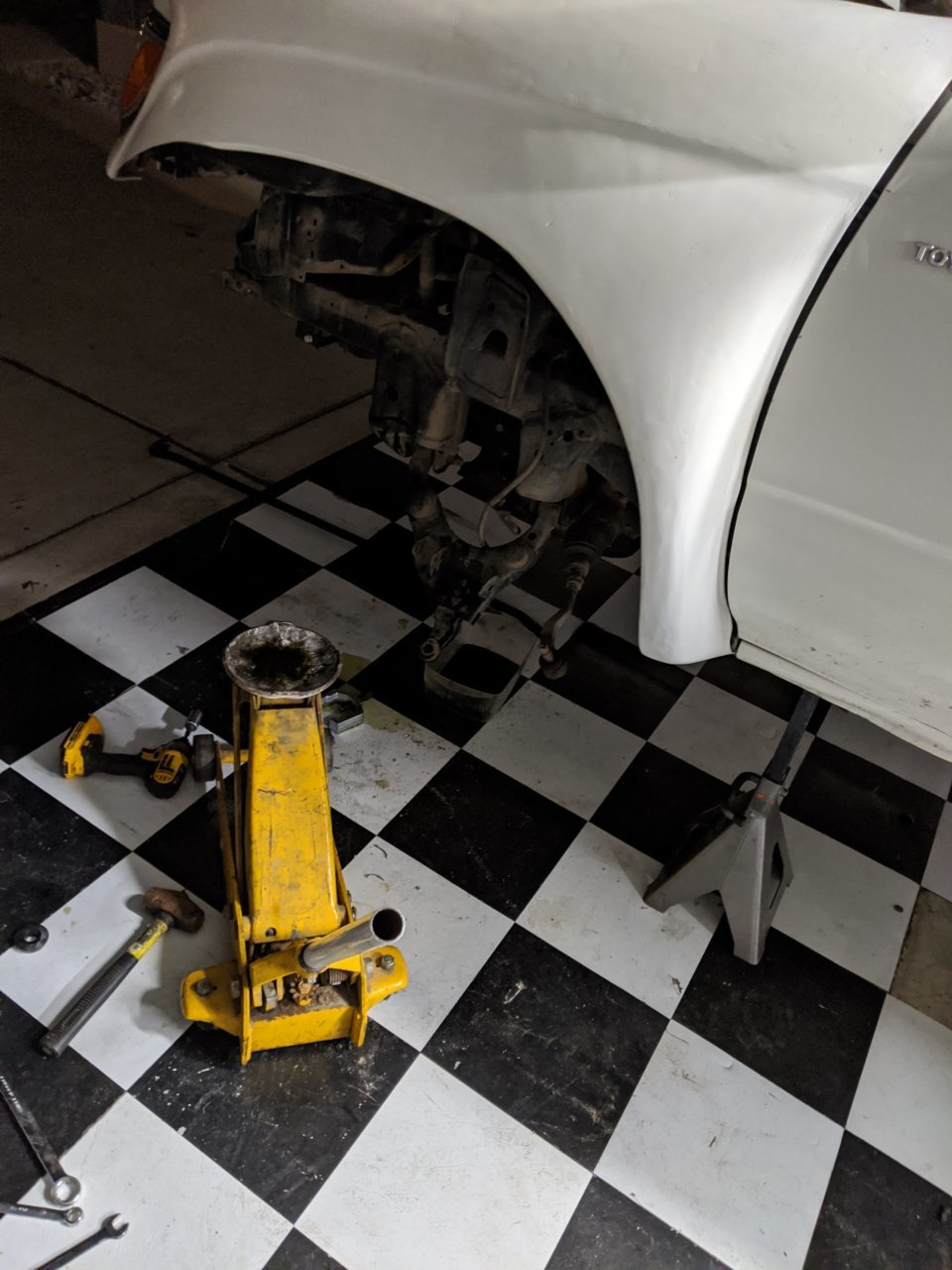

    Finished up the passenger side sliders. I think I was welding too much in one spot and warped the rear mount because it kicked in a hair on the front, either that or I was trying to go too fast and mis-measured. It's off by about 1/4 in at the front... bummer. I'll go back and fix soon.
    Then I bought some 1.5" DOM from a dude on FB market. 3 lengths at 18' a piece. Now just how the fuck am I gonna get this home?!?
    So I took a piece of angle iron, some track lighting nuts, and a piece of tube kinked by me playing around with the tube bender. Sho nuff, made a little bracket/rack that hangs over the side of the bed. I then hung the tube on that and my front passenger mirror (stuffed some rags to make sure I didn't destroy my truck), and headed home.
    Gonna try to regear the Sterling to 5.38 this weekend and get the steering box mounted. Reusing the TG crossmember worked out, but it would appear I need to hack it up a bit to push the steering box as far forward as I can. I'm hoping to bend it down using leverage and hulk strength and build a skid for the box at the same time. Once that's mounted, I can get my axle location set, then calculate my link lengths...

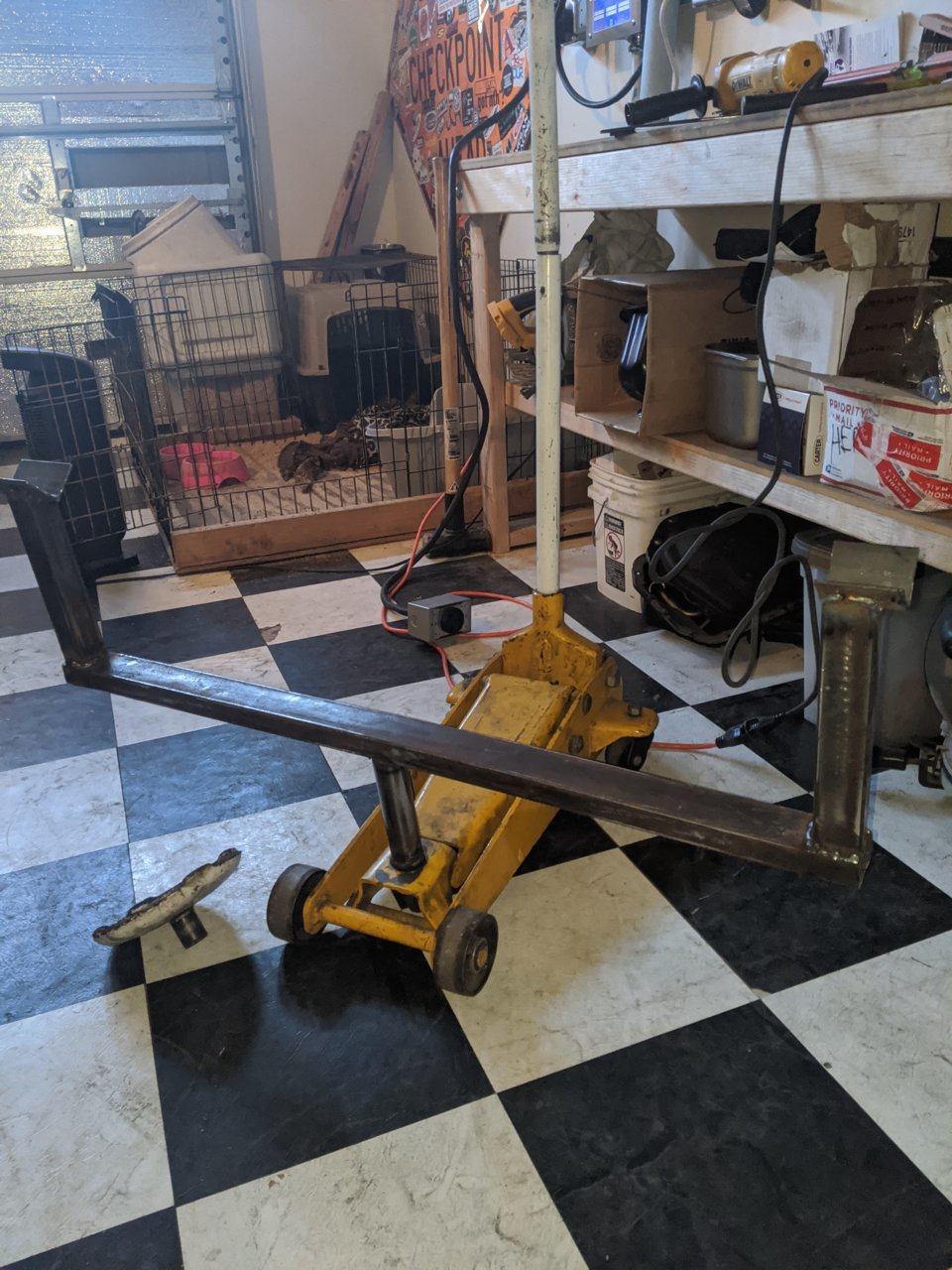

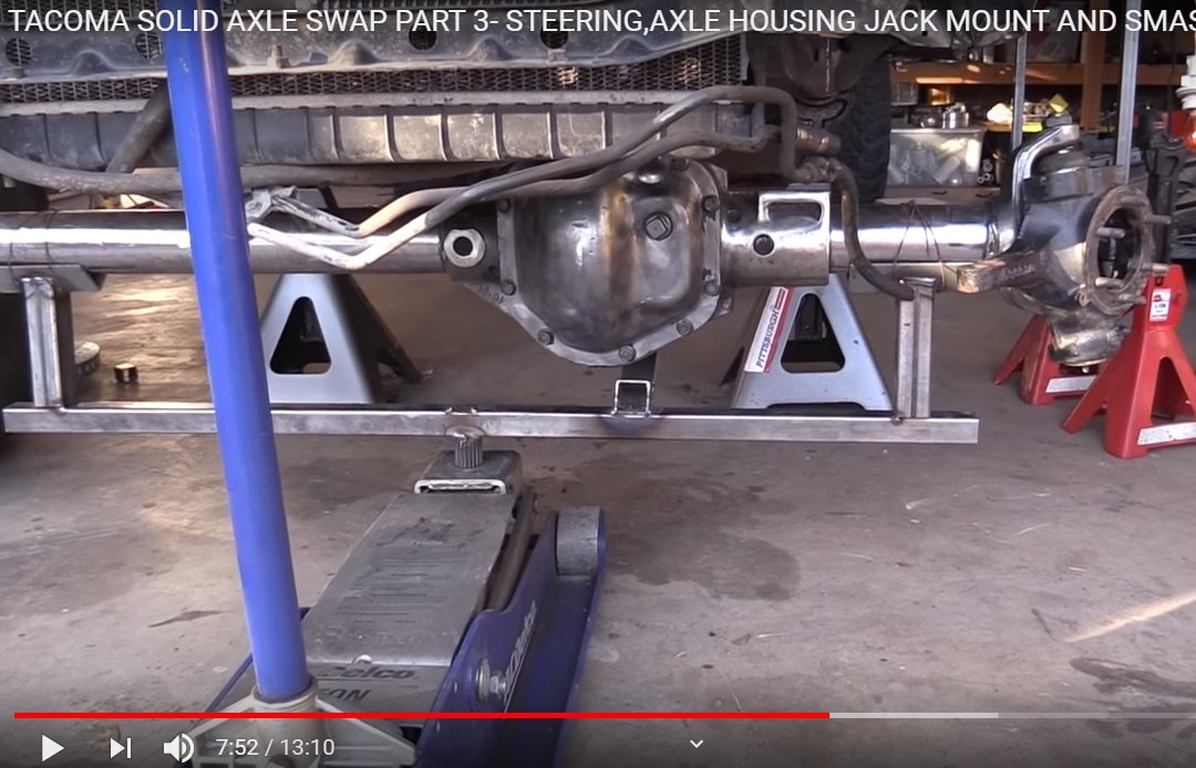

    Additionally, there is an awesome axle mover thing some dude on YouTube built which I'm gonna replicate. Should make it easier to move the axle around with minimal effort.
    POSTacoMike, jubei, MY50cal and 2 others like this.

    That axle jack adapter is sweet! I almost lost my fingers and hand a few times and fucked up the spindle threads on my fj 80 axle with it falling off the jack stands evreytime I went near it trying to locate it under the truck. Post some pics when you are done so I can copy it LOL!!

    Also, I got started on the axle attachment for the jack. Need to find some tube that fits tighter in the jack hole. (Giggity)

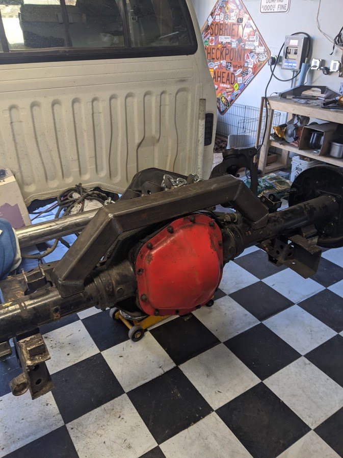

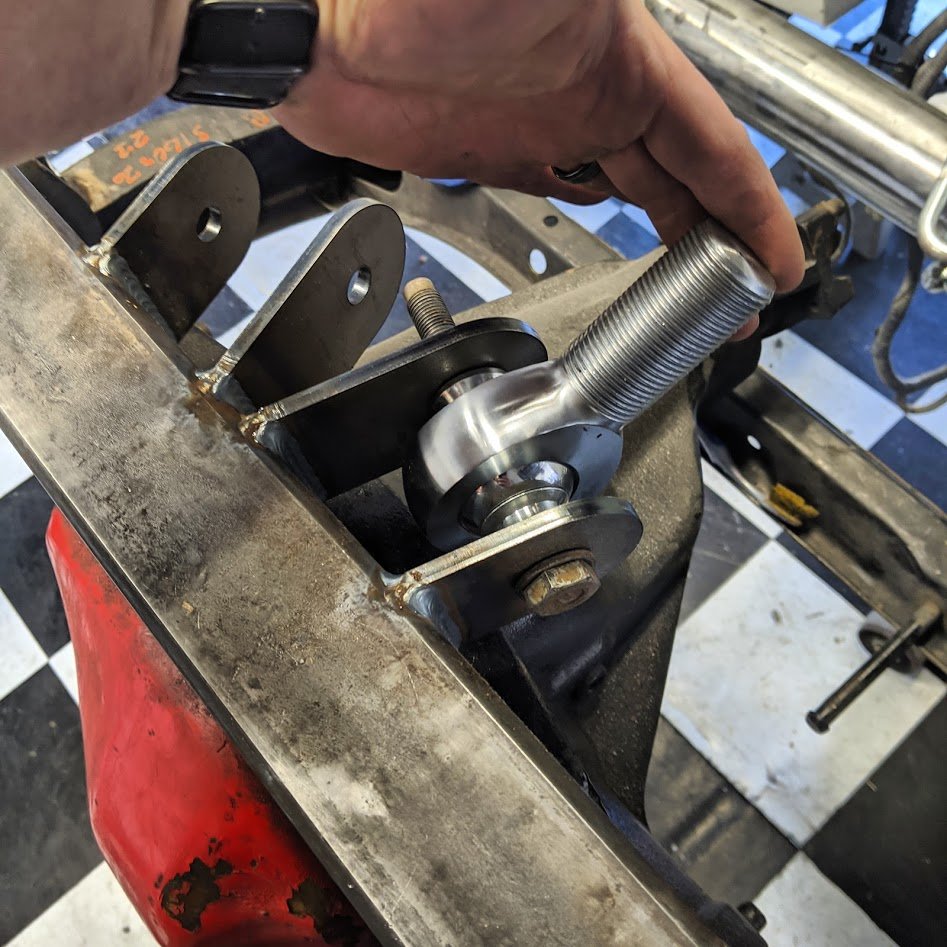

    Trusses came in for the 60 and 10.25. Heims fit perfectly.
