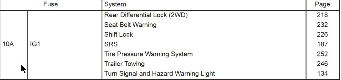

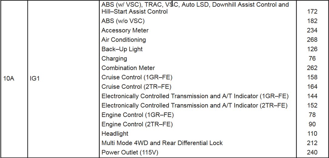

    My IG1 10a fuse has been blowing and I think I've nailed it down to when I put my truck in reverse. All those things are connected to the IG1 fuse... Speedo, turn signals, air bag light, a/c, and reverse lights.

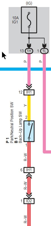

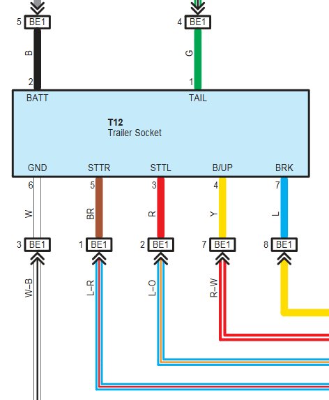

    The first and most suspect item would be the Trailer Towing circuit in my opinion. Specifically the backup lamp circuit coming from the Park Neutral Safety Switch ( Automatic ) or the Backup Lamp Switch ( manual ).
    Inspect the Tow Harness and connector for damage and corrosion.
    See this schematic, page 2 from the top of the PDF:
    https://www.customtacos.com/tech.ol...toyewd/06toypdf/ewd/2006/tacoma/h/em01d40.pdf
    The red wire with a white stripe goes to the 7 pin trailer harness and at connector BE1 it is turned to Yellow Wire.
