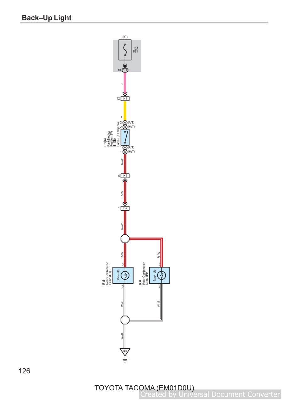

    I finally broke down and made an account since I have been on here so much over the years. The issue is I keep blowing the IG1 fuse and losing AC, blinkers, and the shifter locks. I have a brand new NSS from Toyota and no reverse or tail accessories. I have replaced the fuse 3 or 4 times now and every-time I throw the truck in reverse with a new fuse it blows and I lose all the things stated previously again. Any help is very much appreciated!

    If it only blows when you put the truck in reverse then you have a short to ground somewhere in the reverse circuit (Pin 1 Red/White wire), that wire also runs to the Combination Meter (Instrument Panel) and PCM.

    Ever solve this? Having the same issue. IG1 10 amp fuse pops every time I go into reverse.

    Well I think I fixed it. Long story short, a rough road I've been commuting on seems to have caused one of the reverse bulbs to rattle slightly out of place. I removed both bulbs, started the truck, selected reverse, and the fuse didn't pop...re-seated the bulbs and all seems to be good. Weird that the fuse also controls the AC, turn signals, and shifter lock-out. Had me worried it was a major electrical issue.
