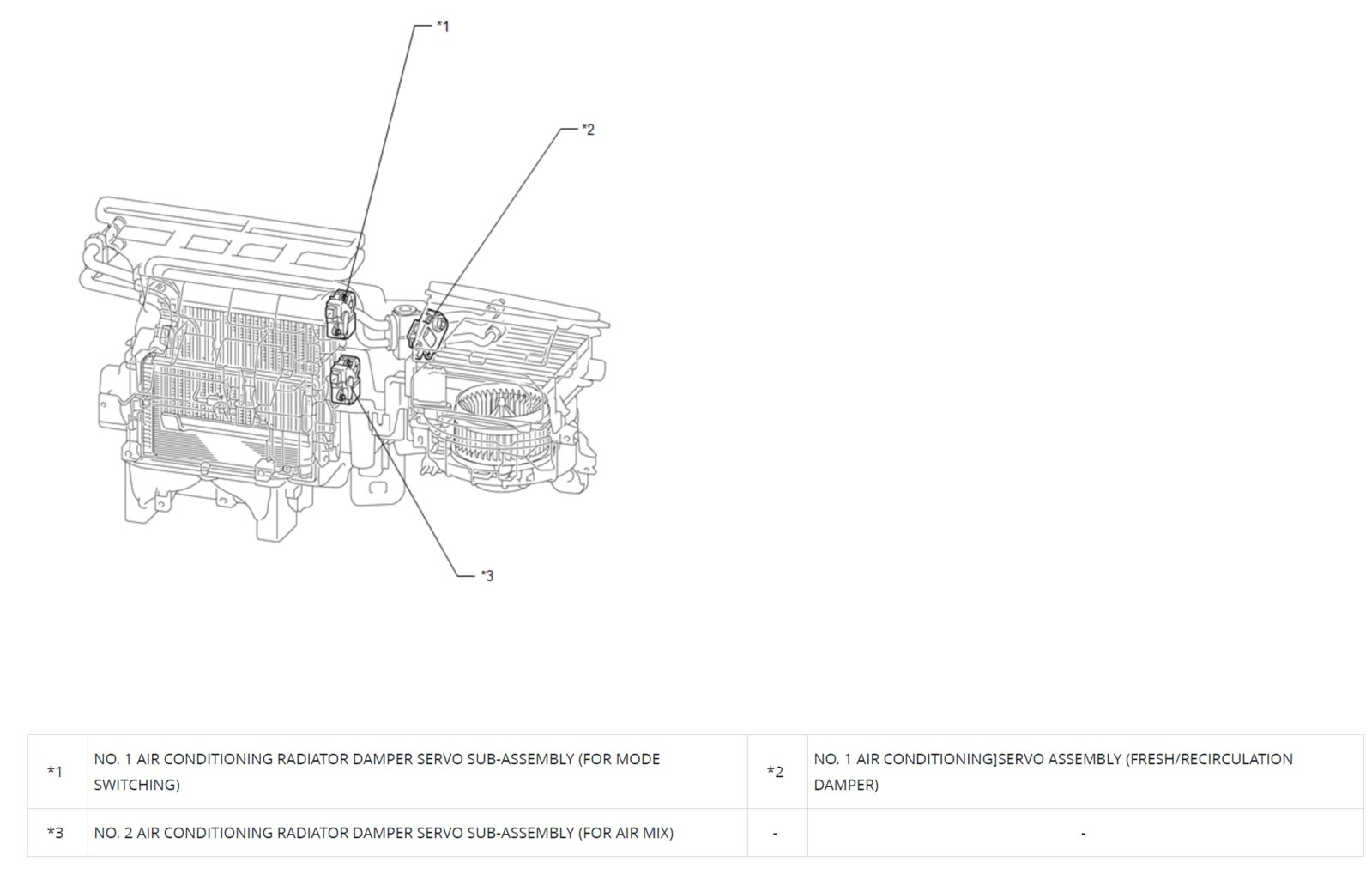

    Yeah. The AC is a bit different. The fuse also goes to the Air Mix and Air Vent sevos.

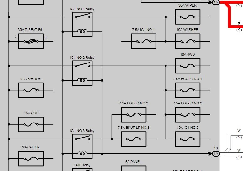

    Predator tube steps, Ranch Hand grill guard, Magnaflow CatBack exhaust, Toyota tool box & bed mat, 2LO Module by @Up2NoGood, Rearview Compass/Temp Mirror, Tune by @JustDSM.
    The fuse get's power from the IG1 No 2 Relay, Ignition Switch isn't involved other than turning the relay on.
