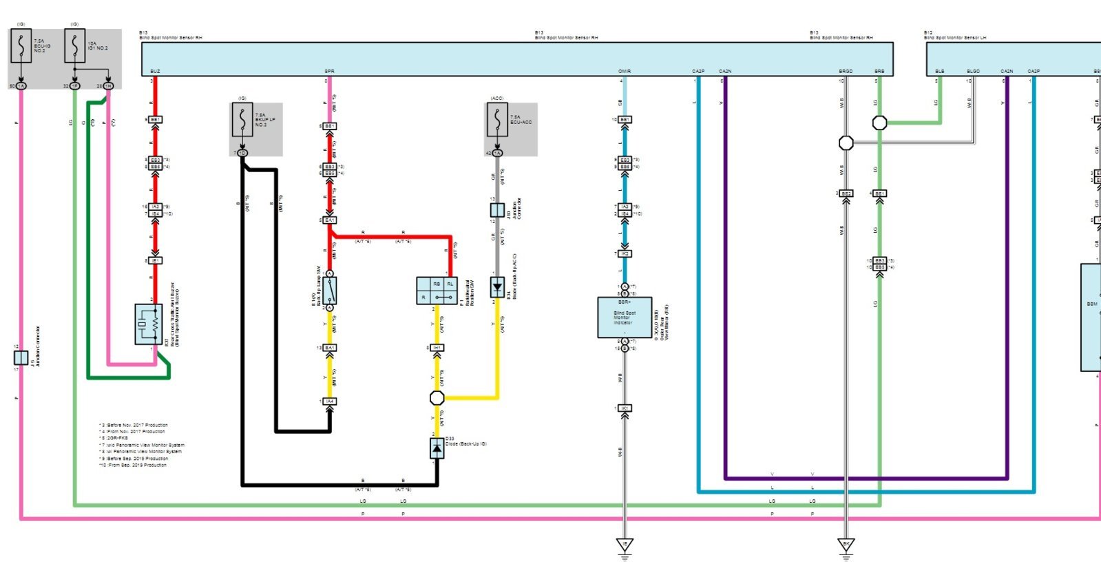

    It does feed the Blind Spot Monitor units in the rear though.
