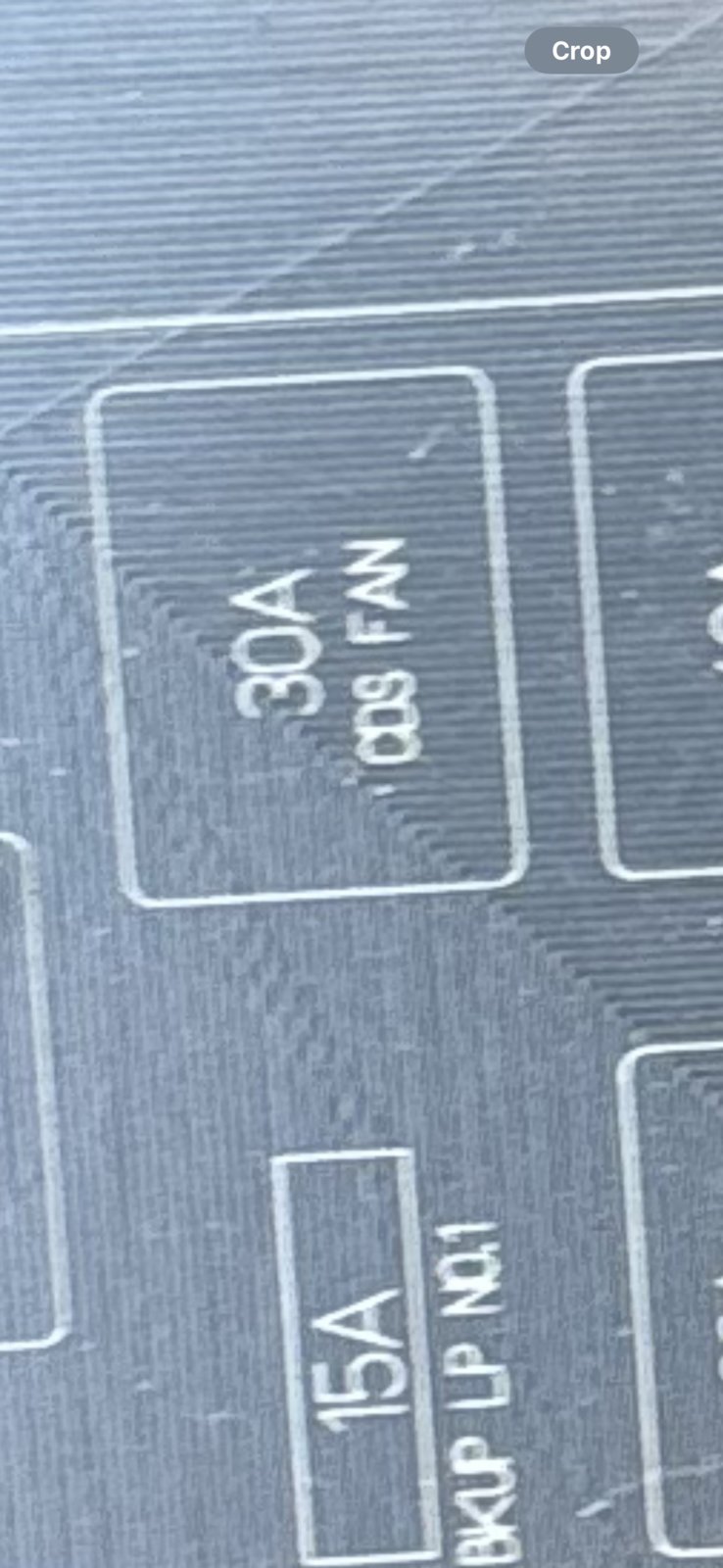

    2023 black Tacoma TRD Pro
    @TnShooter thw IGN fuse is back in and hasnt blown, and the HTR relay passed both the multimeter test and the 9V test and is back, how do i test the CDS fuse?

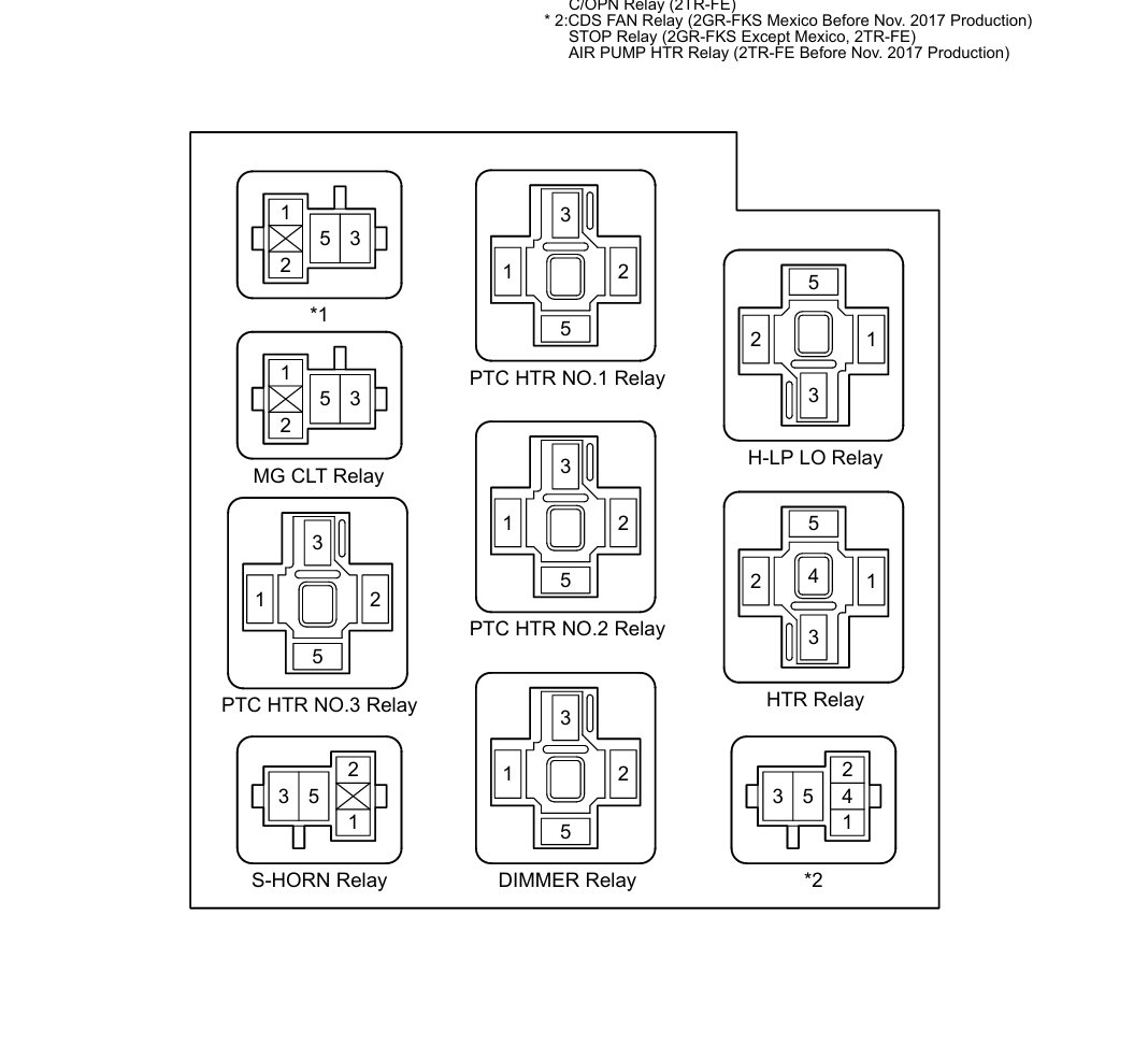

    Let's check the blower motor relay pins in the fuse box.
    We need to know what's missing.

    Pull the HTR relay.
    Turn the ignition switch ON, and the Blower (air) ON.
    Check pins 5 and 1 for 12v (battery voltage)
    And pin 2 for Ground

    @TnShooter so some how we are back to square one, i realized i never re put in the 30A CDS FAN relay so i put that one in and the fans worked for about 1 minutes then the 1GI blew so there is sowmthing else besides the radar that it shorting.
