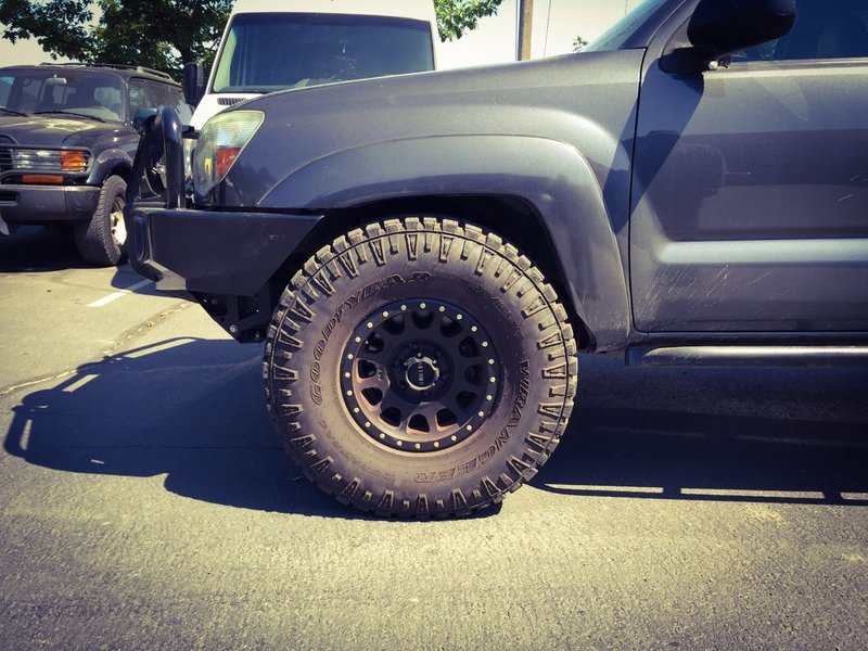

    Switched back to OME 885's. The 886's gave me too much lift and there was noticeable wear on the CV boots.
    I rode around with the stock TRD suspension for a day looking like a pavement sniffer.

    How's the ride with the 885's and arb bumper?
  18. Jun 26, 2015 at 5:34 PM
    #198
    Iggy
    Iggy [OP] Well-Known Member
    Feb 2, 2012
    #71971
    4,016
    Northern CA
    09 4x4 Off-Road Access Cab
    Check out the build
    @Acerwin it runs much nicer. I don't have a winch or skids so it's not enough weight to get the 886 to settle. The height it a little less than what I would like, but the CVs are good, and that's a headache id rather avoid.
