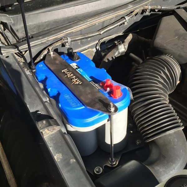

    Looks awesome. I like that it clears the hood strut. I was wondering if there was any concern about your tie down coming in contact with the battery terminals? It makes me a littler nervous looking at how that tie down is oriented.
    Do you have a source for a strong non conductive material you could use?

    That is a concern I had which is why I changed the design so that it's offset a bit. I hadn't thought about using something like delin, I'll see how well that will do.
    It's defiantly close but I'm not super worried. The top bar is 3/16" steel and I have to be careful not to tighten it down too much or I can crack the plastic of the battery.

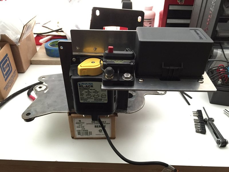

    Are you going to have to relocate the contactor/controller?
    Everything is looking REALLY good man! Love the dual battery setup. Can't wait to see what's next. Also, how are you liking the hard top? Would you have gone with any different features if you could?

    I relocated the controller to the driver side area where the relay box was. It was really tight fitting it all in and I had to make a bracket.
    The dual battery setup is going to be redone soon as well. It's been an obsession lately, but I'm going to offer them for sale once the design get's streamlined.
