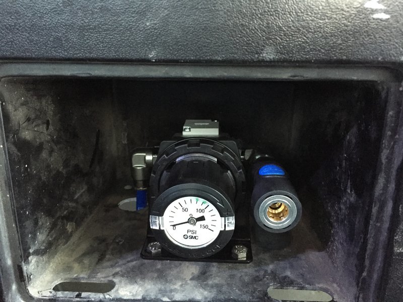

    Here's a quick write up for the compressor box.
    My initial intent was to have the compressor be under the truck bed, but considering the conditions it may be exposed to, I decided to have it concealed and out of the weather.
    My dimensions were very specific, it had to be no wider than my fridge slide, and no taller than the side grooves on the side of the bed. I did that to fill the dead space behind the slide and I can put a board across the top and the lid will be flush with that.
    Inside I have a blue sea fuse panel for wiring up accessories in or around the bed area, there's an exhaust fan with a speed controller to make sure things don't get too hot. Mini relays for the compressor and custom wired locker solonoid. All the air is plumbed to the outside.
    Lastly on the outside I bed lined the lid, added a 12v socket and power for the fridge.

    This is changing. I'm going to add a regulator.
    Changed to this:

    Nice job on the box! Clean execution. What gauge wire are you running to the 12v plug/ARB plug?
  20. Feb 12, 2016 at 3:30 PM
    #300
    Iggy
    Iggy [OP] Well-Known Member
    Feb 2, 2012
    #71971
    4,016
    Northern CA
    09 4x4 Off-Road Access Cab
    Check out the build
    Thanks!!
    It goes 4g from the battery, then 6g to the fuses and 10g to the compressor.
