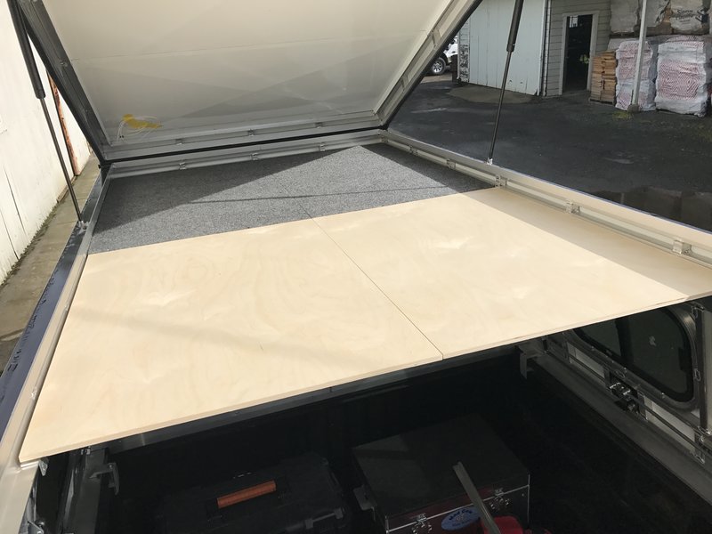

    We got a break in the rain. Here are pics so far of the bed platform they still need to be secured and carpeted. It measures 78" long and 54" wide. There's enough room to put the second platform onto of the other, but I like the idea of just leaving it out. There's still plenty of room in the bed, but if you need more you can stack the sleeping platforms.

    Nothing solid yet. Still working out the detail on the outside fabric. As soon as you see me post up about, it should be a few weeks at most for taking orders.
    I did make one small mistake on the bed width, it's 50".

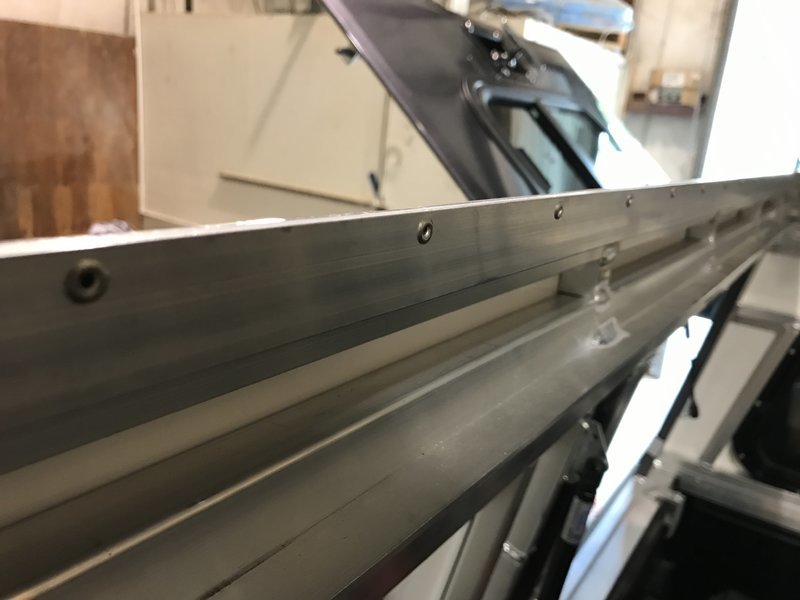

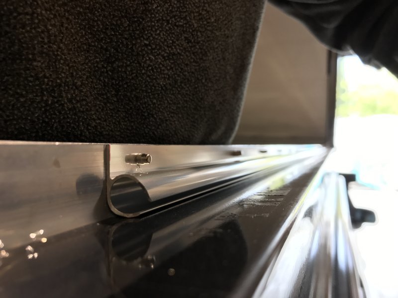

    Got a chance today to add the awning track to attach the fabric. It's kind of an experiment, but I think this is going to work really well!
    I managed to put all the lower track in today, I just need to do the same to the roof and the fabric shouldn't be too far behind. Rivits for days...
