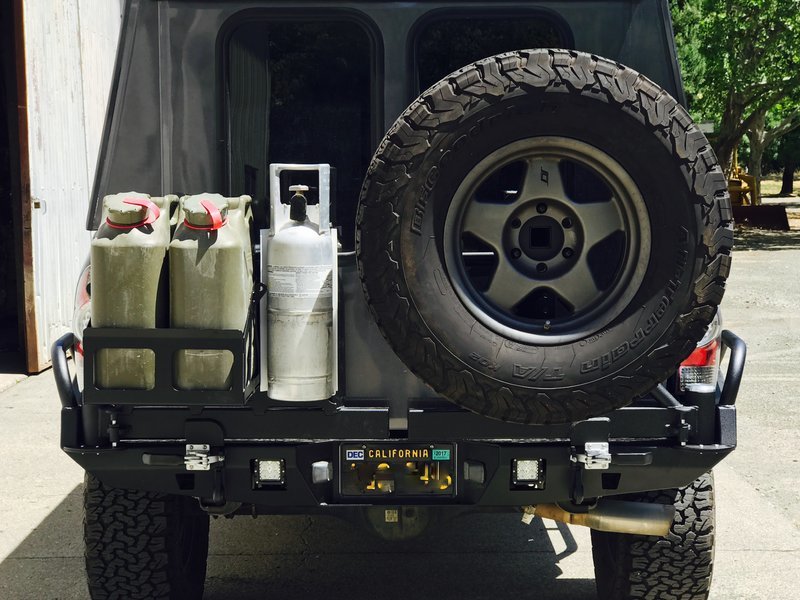

    son...the reason I pulled you over is your tail lights are obstructed from view, I'm gonna write you a Fix-it and I expect to see a stock bumper on here next time....

    haha! It looks that way, but nothing is actually obstructing them. It's just the angle of the pic.

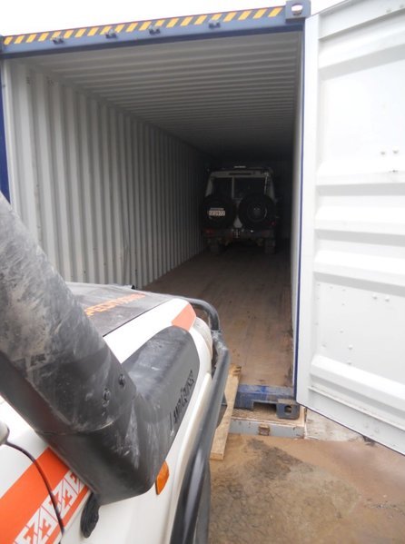

    Many reasons to keep it low.
    Branches.
    Parking garages.
    And more ambitious reasons.
    We should go in halfsies on 40 footer bound for Ecuador some time.
    #goals

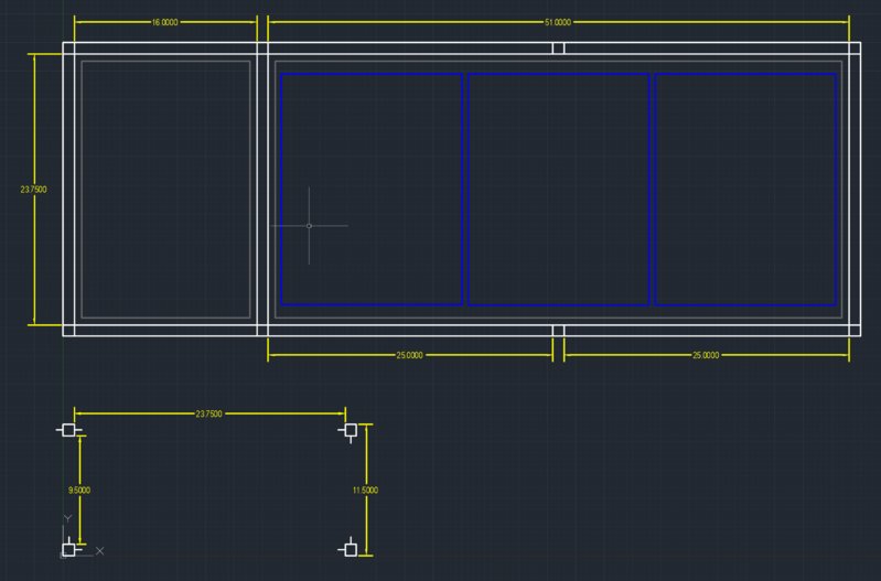

    Ordered the material to make a small cabinet. The idea is to have storage for my 3 Front Runner Wolf Packs, with a bit more storage in the front. I didn't add any drawers to pull towards the outside because it would hit the rear hatch door. So this will have two pop up doors on the top. the front runners will be accessible from the inside and the little hatch will be accessible from the outside through a side camper door.
    This all came about to have room for another single sleeping area, or stealth camping as @Overlanerd calls it. He's actually the reason I am doing this after talking about his setup.
    Here's the CAD to get general dimensions as an idea for how much boltless framing I will need. The blue squares are the frontrunner packs.

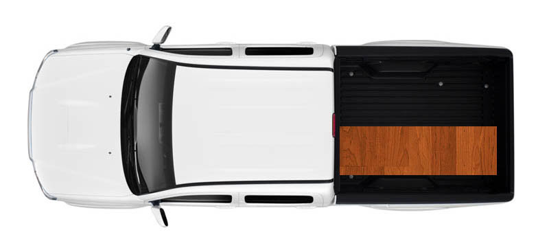

    Heres the concept in a rough drawing. I'll have another strip of wood going over the wheel well area.
