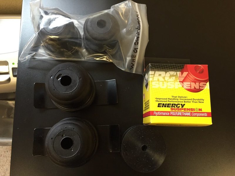

    Ordered Parts:
    Wheelers bump stops and spacer
    Steering rack bushings
    Not pictured:
    Napa greaseable cam bolts
    Dirt King LCA's
    Method Race NV's 16x8
    Goodyear Duratracs 315/75r16

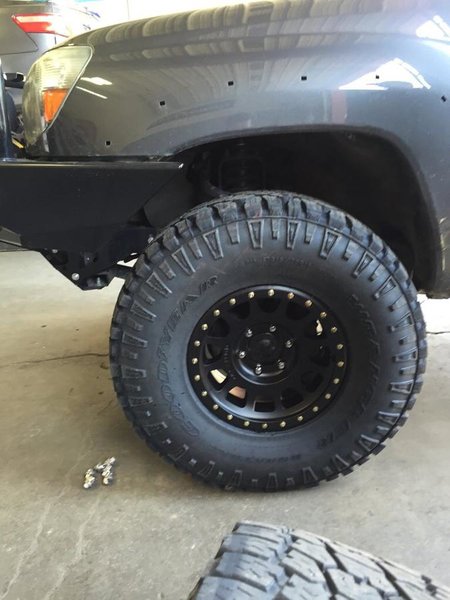

    Chopped and played with the new shoes.

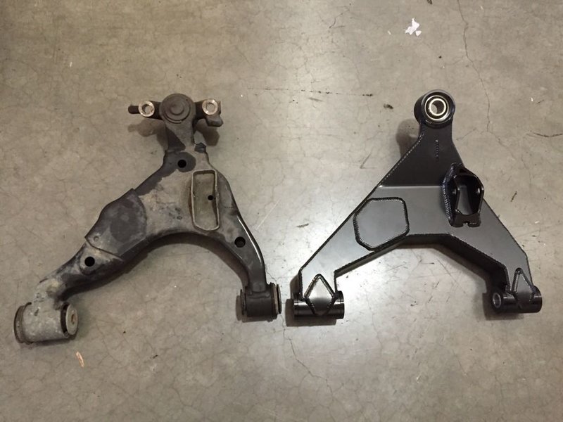

    Yeah Nate! I'll be installing those tomorrow. My LCA bushings went out so the cost of new factory LCA's plus uni ball conversion of the ball joint came really close to the cost of these so I went for it.
    I was going to get the TC arms, but I couldn't get them in time and these were available. I'm glad I did! These don't require spacers and I don't plan on running dual shocks.

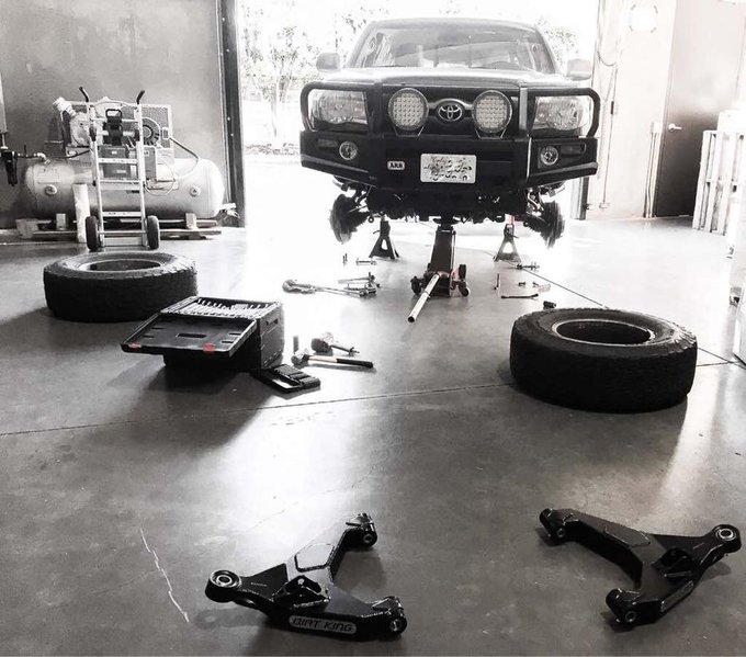

    In process.
    Pure beef

    I don't recommend doing this alone. It took me forever! More pics after alignment tomorrow.

    I've got that same tool kit. Great kit! Lol. What made it take so long?

    Trying to torque down the uni ball bolts alone was a pain. They need to be 180ft/lbs before you install the LCA. It took some effort to get everything to line up.

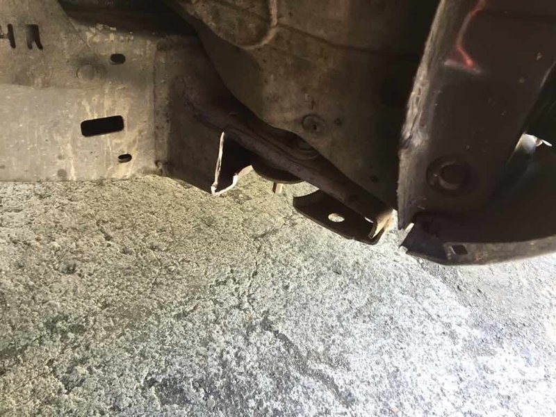

    AHH! I went to check in on my truck at the tire shop and the alignment tabs broke. They're getting welded now with some bar stock. It's been one thing or another with this truck the last couple of weeks.
    How I feel about my 35 situation.

    Yeah man! It's been a crazy couple of weeks at work and the truck drama didn't help. But she's home now! With your MTR's do have some soft side walls? On the Duratrac's I get a "floaty" feeling from the give the sidewalls have.

    Initial impressions on the Dirtking LCA's are great. They firm up the steering and it feels more responsive since a lot of the play is removed. I think the combo of delrin bushings and the uni ball really help out. Also, I think I may be getting .5"-1" of extra droop from them. When I had everything button up I had to jack up the truck more to be able to mount the tires.
    It's going to take some getting used to! The steering doesn't return as fast as stock and the gearing is sluggish but not horrible. I'll take a good pic tomorrow!
