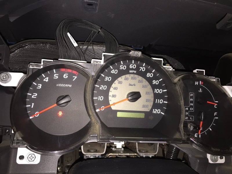

    The speedo is easy. It takes about 10min to remove all the panels to access the speedo. The only thing holing everything in place is two bolts and two screws.
    In the pic you can see the black wire loom which plugs into the speedo on one end and the other interfaces with the stock plug and a programable box. On the box I zip tied the USB cord and ran it out out of the coin pocked to the left so I don't have to tear apart the dash again if I want to reprogram.

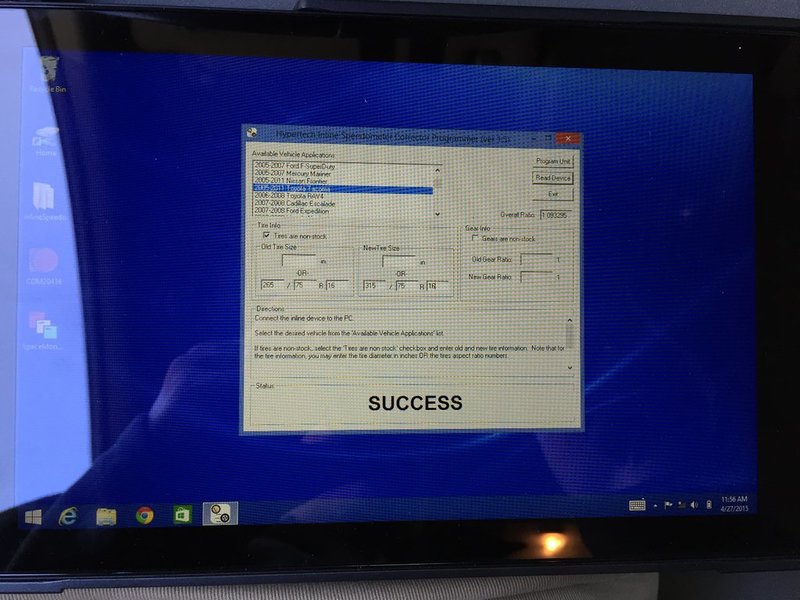

    The software is easy, here's a shot of when I programed it a second time in the truck.

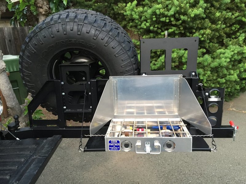

    @Nate87 heres a pic of how my stove setup works.
    The hose comes out of the right side of the stove and hooks straight into the propane tank. I can use the tail gate for prep. I may add a 4' awning off the back for shade.

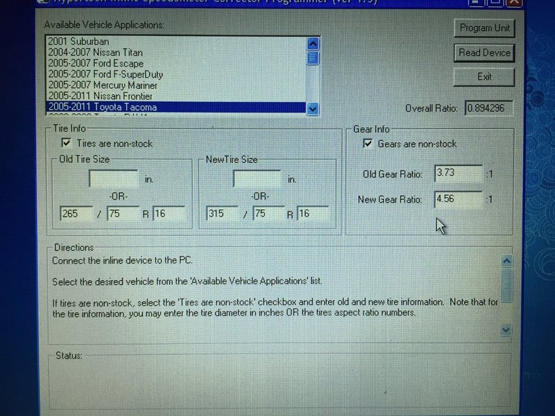

    I also ran what the Hypertech would calculate for you if you changed tires and gears. It looks like a little less than 1% change, but you're saying it's more?

    You're right. Here's he calcs again with the correct numbers.

    Right on! That seems more like what it's off. Thanks for that.
