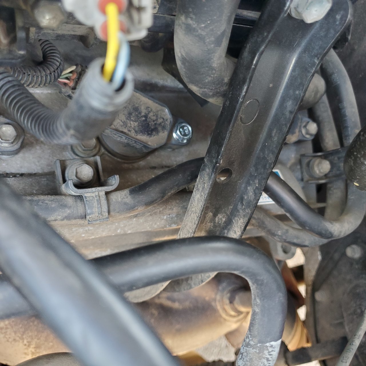

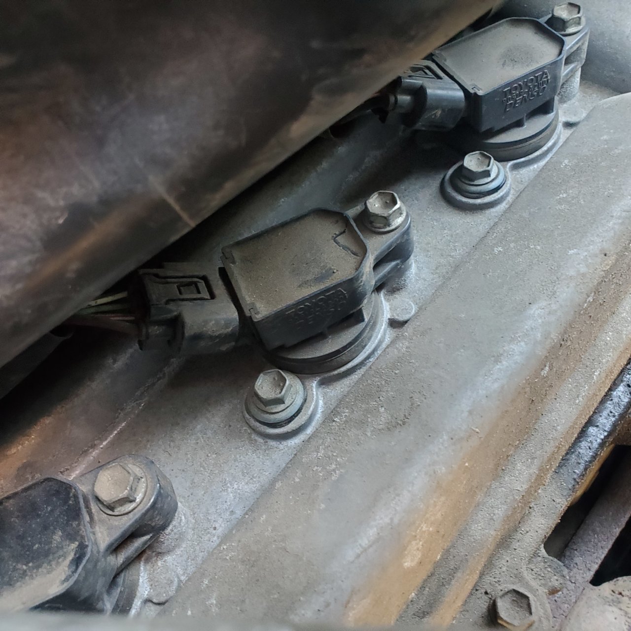

    Photos of both sides of the engine. Easy side looks all original. Hard side one new bolt.

    I’ve had a few pull threads out when loosening, but they’re always due to a previous tune up and someone having overtightened them. If it’s first time, they should come out flawlessly.

    Personally, if your handy, I would just try to helicoil the valve cover threads.

    If chasing it with a tap isn’t gonna do then yes.
    If you can operate a drill, a tap, and read instructions it’s not that difficult. A spring style insert would work fine for bolts that small. I have a 16mm kit that uses a tube type insert.

    Need to be extra careful with a drill, there’s not much meat on the cover. Pretty easy to go too far
