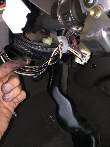

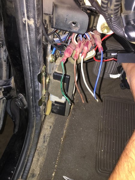

    So I'm removing my piece of shit dealer alarm and installing a viper system. Along the way of removing my system I touched nothing other than the harness going to the aftermarket alarm, and cut the tap in wires so all the factory wires remain untouched. Bottom line there is a BLACK wire wow the steering column that was split and used (I believe as an ignition kill), so Im assuming I need to just connect that back together. Aside from that I'm to the point where 4 wires (green/blue/black/white w black stripe) are tapped into a harness by the driver door/clutch area. If anyone knows how to hook this back up please let me know, the car turns on and tries to turn over, but still stops as if the ignition kill is still blocking it. ANY INPUT IS MUCH APPRECIATED!!

    EDIT: the colors are:
    WHITE
    BLUE
    BLUE w/ BLACK stripe
    BLUE w/ WHITE stripe

    Just ripped my after market alarm out by the roots,,, got tired of it giving me grief,, didn't know for sure when I went into it if that was the problem, just my suspision from past dealings.
    On mine the black was cut in half also. I just soldered it back together and shrink wrapped, the other wires were just tapped into harness.
    Cranked right up and has been good since,,, mine was a "no crank issue".

    Thanks for the input, turns out it was the clutch start cancel being unplugged that was killing the ignition:facepalm:
