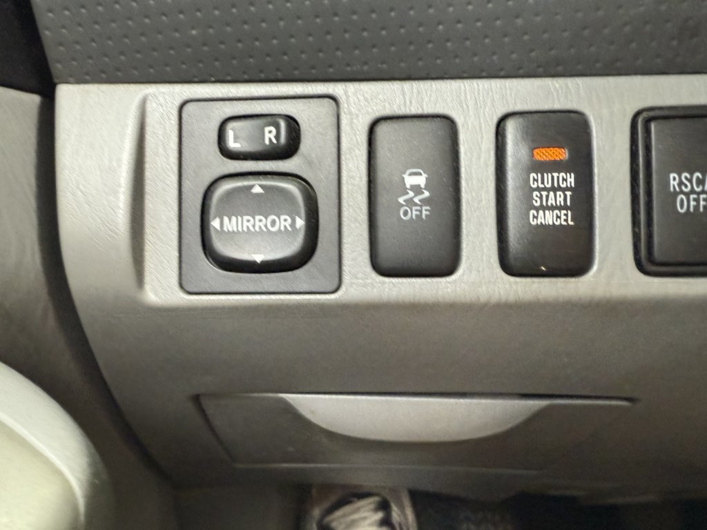

    it is a four-cylinder with a five speed. I tried all kinds of things, but then I found this, and I’m leaving the picture here. Now when I just put the key in the ignition and turn the accessory on and push this button and it starts right up! So somehow this just bypasses it. Thank you all for your help, but I think this is going to be all I need

    Sounds like you need a clutch safety switch
    That button bypasses it

    Or it may just simply need to be adjusted.
