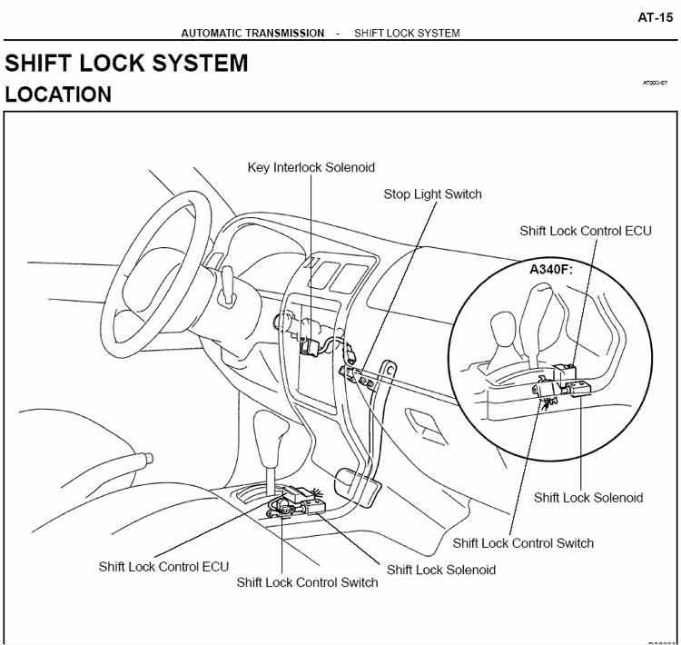

    I found out, not 100% sure, the problem is the key interlock solenoid.

    I had the same problem and found the shift lock control switch was bad. The transmission didn't know it was in park and wouldn't let the key turn to the off position. I umounted the console at the base of the gear shift and bypassed the switch; remounted the console and the ignition switch works fine now.
    The only side effect is: you can shift out of park without having to depress the brake pedal and you can turn off (and remove) the key from the switch while the gear shift is in any position. Not necessarily a bad thing, just mentioning it.

    I removed the front cover (under the steering wheel) and unbolted the Key Interlock Solenoid for several days now and it works fine. In this case, can I just leave it unbolt and put the front cover back in? Is it safe?

    It shouldn't hurt anything. If the connector has any exposed contacts, tape them to prevent a short circuit and it shouldn't be a problem.
    Lol, you and I operated on opposite ends of the same circuit: shiftlock control ecu sends impulse signal to the key interlock solenoid.
