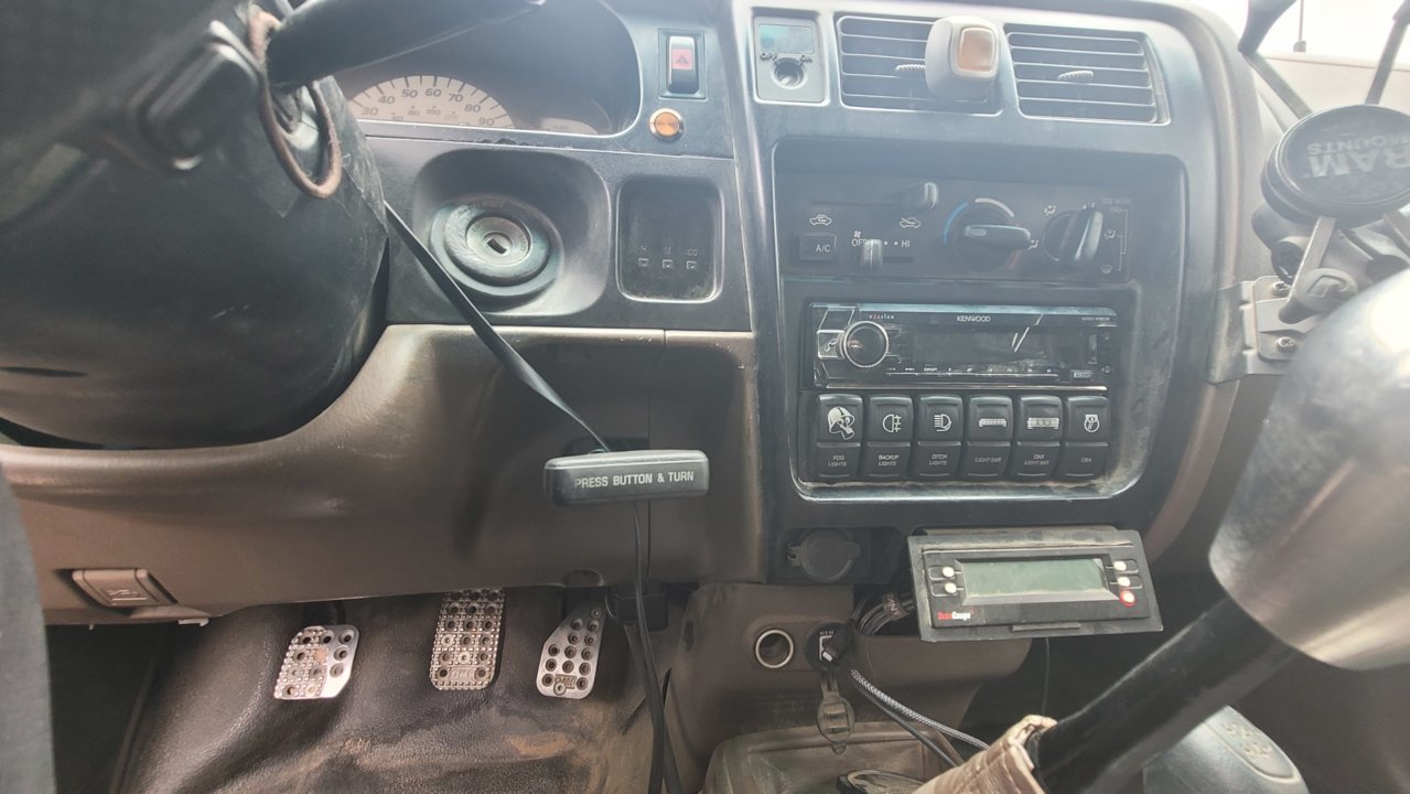

    In lieu of a recent vehicle theft super close to home i've been trying to determine and create a means to interrupt either the fuel pump or the ignition.
    Aside from having a manual trans (will likely only deter some) as a first means of theft deterrent i want to have a way to eliminate anyone from being able to start the truck.
    A relay and accessory interrupting either the pump or ignition is what i've been considering.
    The ignition will likely be easier. Using a relay and an accessory is my more favored route at this point.

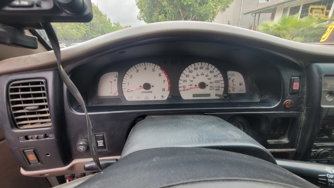

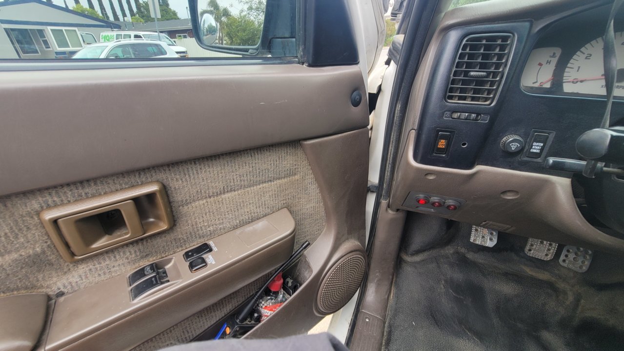

    1. Since i don't have power mirrors i was thinking of using that space to install that switch panel so it won't look out of place but am un sure if that is a good way to go since there are more wires involved on the back to get it to work correctly. However the switches are abundant and it would look clean.
    Schematics thread
    2. Move the clutch switch on the pedal to a bank i've made on my fuse panel.
    I've got a good amount of aux switches so just adding another likely wouldn't give its use away.
    3. the traditional route to tap into maybe the AC or highbeams
    4. maybe a 12v remote trigger to have an additional key on myself and use RF to trigger it.
    all ideas and advise appreciated
    Seems like there likely won't be an easy route but i would rather make it complicated and work than come out to finding someone liked my truck so much they took it to mexico for themselves.

    The fuel pump wire is right under the driver seat FYI. All that would take is splicing a high amp switch you could reach behind you for

    Good to know. I would likely wire it to my panel so it looks like just another accessory. I want to give the potential thief the benefit of the doubt on being intelligent.
    How many amps are we talking?

    Love the idea of wiring this in to a power mirror switch. Sub’d.

    The mirror switch would work great with a relay.

    Does the truck have a clutch interlock switch?
    If so, I'd think breaking one leg of that to a simple toggle squirreled away somewhere hard to see, easy (for you) to touch should do it.
