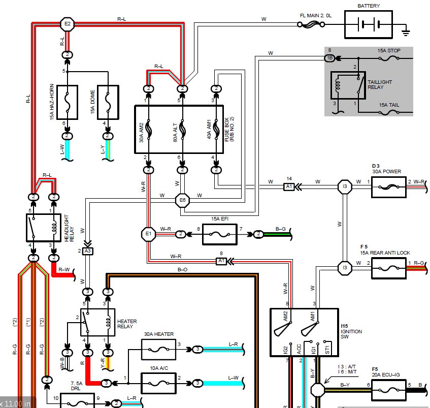

    The alarm that was in my truck broke the connection for the AM2 feed going into the ignition switch...
    the white wire....by far the easiest wire to get to ...for total no start..

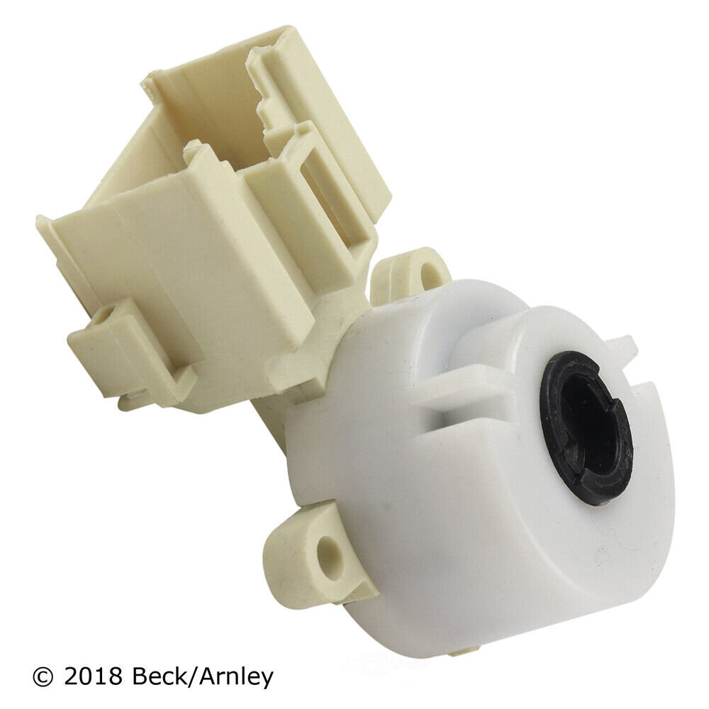

    Its super easy to steel any tacoma/4runner without an immobilizer key...
    all you need is one of these.....takes about 20secs....
    just one plug....and a screwdriver....or anything flat....
    'Look ma, no key....'
    The thief wont even have to break anything....just have to drill out the exsisting key switch when they get it back to the chop shop.....and then pop in a new cylinder....piece of cake....
    Ignition Switch-Starter Switch Beck/Arnley 201-1792 49797781303 | eBay
    I carry a spare in my glovebox in case mine goes out....

    More like....if you pull that plug out the back of your ignition in your dash...
    and plug it into an extra one of these......AND ITS THE ONLY KEY(screwdriver)...that'll start the truck....
    Knowing this, a seasoned thief can drive the truck offf......in 20 sec.....no damage to the truck......easy peasy....
    actually this flaw makes them way easier to steal than the kia or hyundi's......no breakage neeeded...
    just have to drill out the ignition later on ..to install the new key cylinder in......so it dont look like a stolen truck.....
    The toyota alarms tap right into those wires coming out of the back of the ignition.....
    so the thieves are very familiar with those because of the value of toyota....
    their chopped salvage parts fetch top dollar.......
