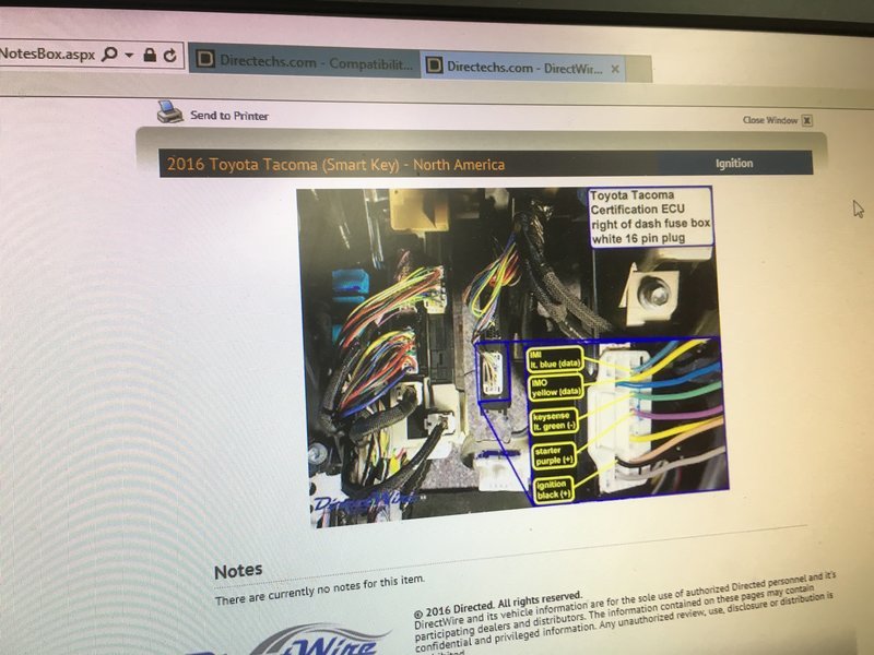

    This is what I found out for myself but that wire is 24 gauge aka data wire. There must be another wire that carries the actual power. Still looking for help. Thanks in advance.

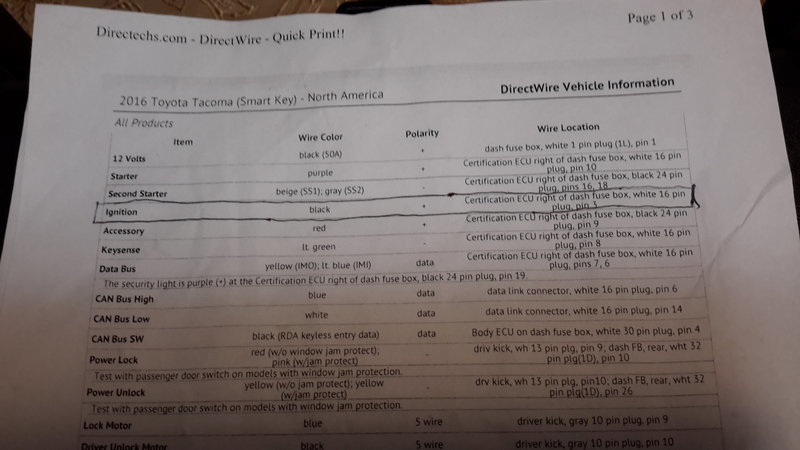

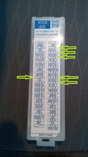

    What about the fuses that are IGN sources?
