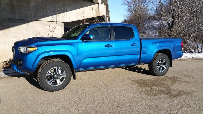

    Looking for a rim to fit 265 70 17 bfg k2o's (better known as k2bro's). All i really want is a matte black,17 inch wheel that "sticks out" another inch without adding spacers. I have been reading about plus 1 size, 4.5 something other, offset, I'm overwhelmed.
    Any one have this setup with stock trd sport suspension? Not looking to lift, but if leveling is necessary I wouldn't be against it.
    Help me out and give me a shit from the front.

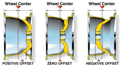

    Your wheels have a +30mm offset, so if you get the same width rim with zero offset you should push your tires out about 1"offsetdiagram11.jpg

    It looks like 0 offset would be centered. Why wouldn't it come stock like that

    Because the design team at toyota wanted the face of the rim to be flat with the sidewall of the tire. It's all subjective and appearance based. It is nice from an aftermarket standpoint because most wheels are 0 offset.

    You're looking for a 17x8" with 0mm offset / 4.5" back spacing.
    You could also do 17x8.5" with -6mm or 0mm offset and be in good shape :thumbsup:
    17x9" won't work well with your tire size.

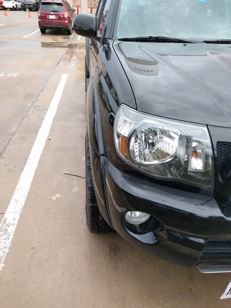

    This is my post from another thread that shows how far out that setup will put you

    I have an 8.5" wheel with 10mm offset and it sticks out ~1" from fenders.
