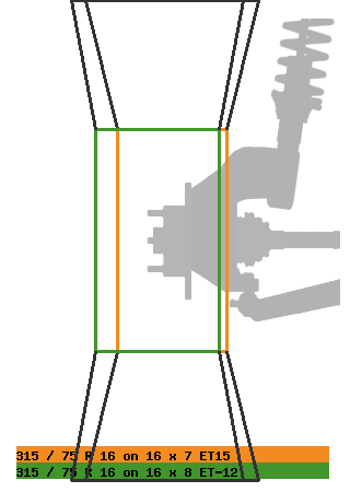

    So this helped me a ton. Went on "willtheyfit.com" and got this as my result.
    Stock compared (yellow) to 16" SCS Ray 10's(green). + a 1.25" spacer. I think I will be perfect.

    Mike, FWIW, I'm running 16x8, 3.5BS, and a 1" spacer, and my 315/75/16 ST Maxx just barely swipe the frame. And that's only when I'm turning at full lock. I'm really happy running 2.5 total BS on my truck.
    I'm no expert, but this was my understanding as well.
    BS is independent of the wheel width because it's simply the distance from the mounting surface to the edge of the wheel. At least, that's what I thought.
