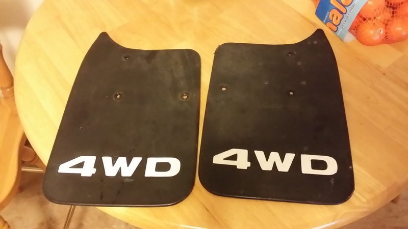

    In other news. Bought some new mudflaps. Used off here. Seem brand new practically.
