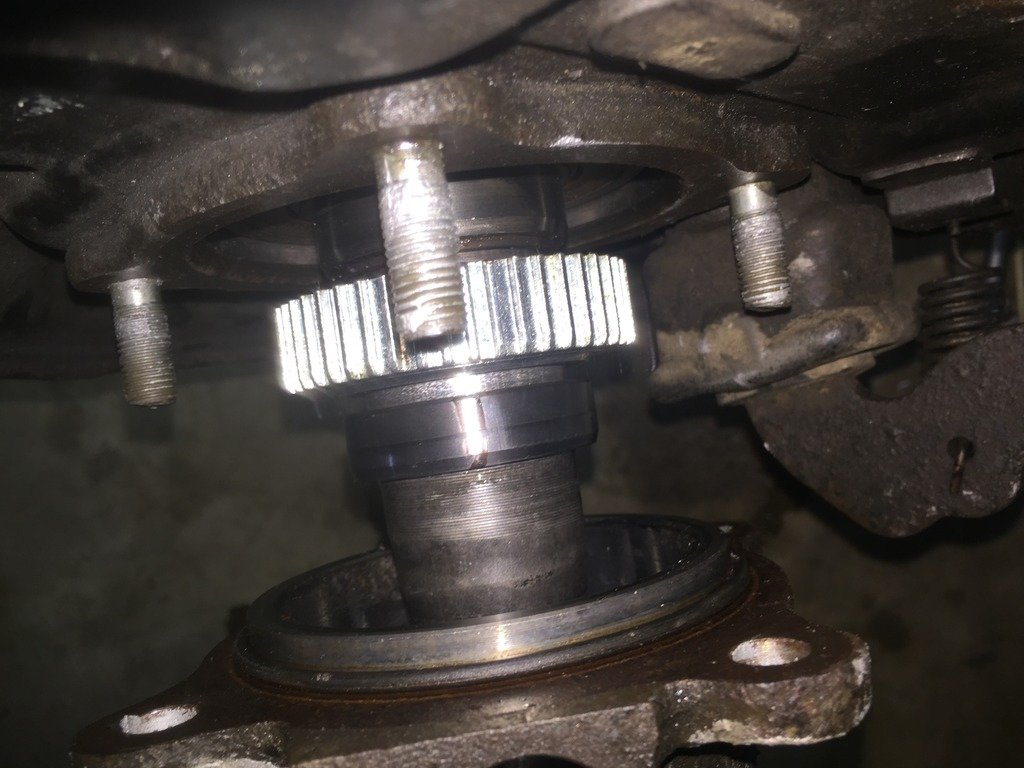

    I know you've been kicking around the idea of doing your own axle seals and bearings when the time comes. I sure wish I had fully understood all of the potential pitfalls when I first started having problems and was looking for solutions.
    I came across this ttora thread recently and it highlighted the exact issues I had for ultimately ( :fingerscrossed: ) getting the issues resolved. I guess I don't want you or anyone else to end up having to redo the work like I had to.

    That same thread came up when I was doing mine.
    FWIW, I think the way you press on the retainer won't make a bit of difference, it's really only dependent on how far you press it down. There's lots of room for the retainer to move up and down, are only the small width of the retainer to ride against the seal. That width doesn't change based on which way the retainer is installed.

    Nice. interesting.
    i agree though, it would appear how far the retainer is pressed on is the main point. still i wonder if this makes it easier to line up.

    No, makes no difference. Just means you press it in farther by the depth of the sholder (3mm based on his diagram) to get the seal to ride in the middle of the retainer.

    Yup, exactly this. When I did mine last time I had the shop press on the retainer and tone ring. I should have just had them press the bearing and then setup the rings myself. I did that the second time and ended up with a much better and accurate setup. I also had a slight issue where the retainer wasn't on far enough and would contact the inside of the axle housing too. So it was a very fine line of being down far enough to not contact the inside of the housing but still ride in the center of the retainer. Such a PITA.
    This would be the best I could get. Now that I think about it, running it flipped would make it much easier to achieve without running into the issues I was running into. I know the bevel is there for the ease of not destroying the seal when you put it in, but it also makes lining everything up perfectly much more difficult.

    I think this is where most people and shops get into trouble when doing this job. There seems to be a lot of redos because of this.
