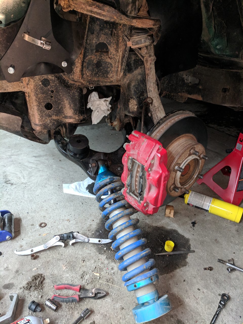

    Bolt might be trashed. Idk. The passenger side one was "in tact" so bolt was good. This side...does not look good

    What about control arm press and a big breaker bar

    Can you get a ball joint separator on it?

    Hmm could try a pitman puller. But that might bend the stock tabs.

    Put a little pressure then hit the socks with some heat.

    Good plan! Will try

    Save your money I've yet to see kroil do well in a side by side comparison to others. Pb blaster isn't much better either.

    Are you advocating using some sort of witches brew like ATF and Acetone or MEK or the like?

    Soak in diesel!!! Always works

    Atf/acetone is near the top. It's what I use. I'm advocating doing research before buying snake oil. Money doesn't make it mo better

    Well this is where I am..
    Hoping I can cut the bolt off this way and pray I can find one in the morning.
    Should be able to get a grinder in there. Least im not trying to save the rod ends.
    I bent the rear shock tab trying to hammer it. I then realized the bolt is flatten in the middle and squished out so it was never coming out anyways.
