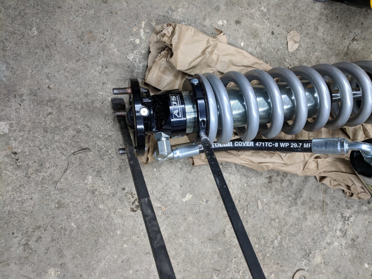

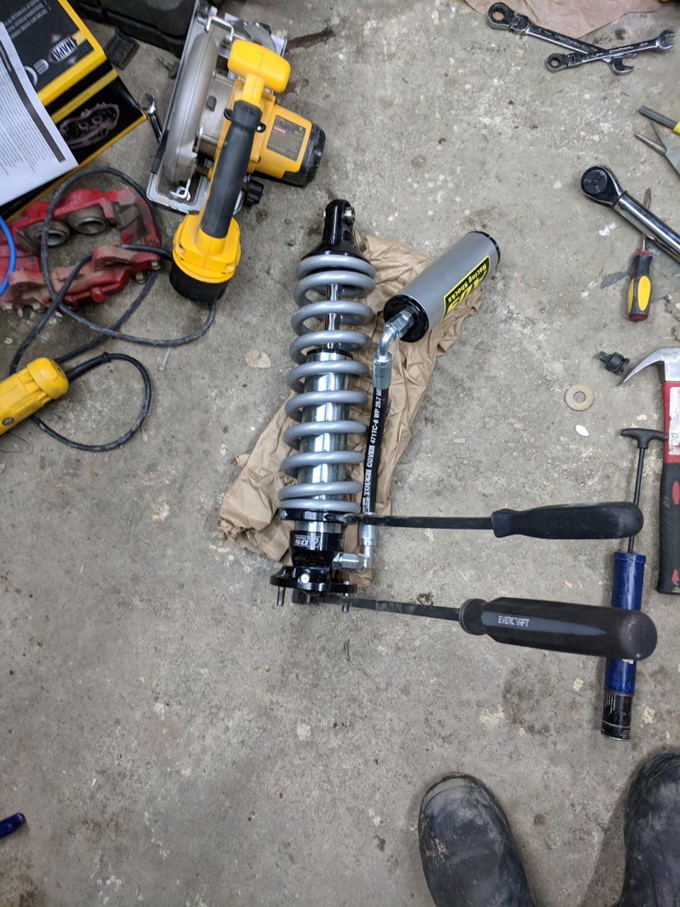

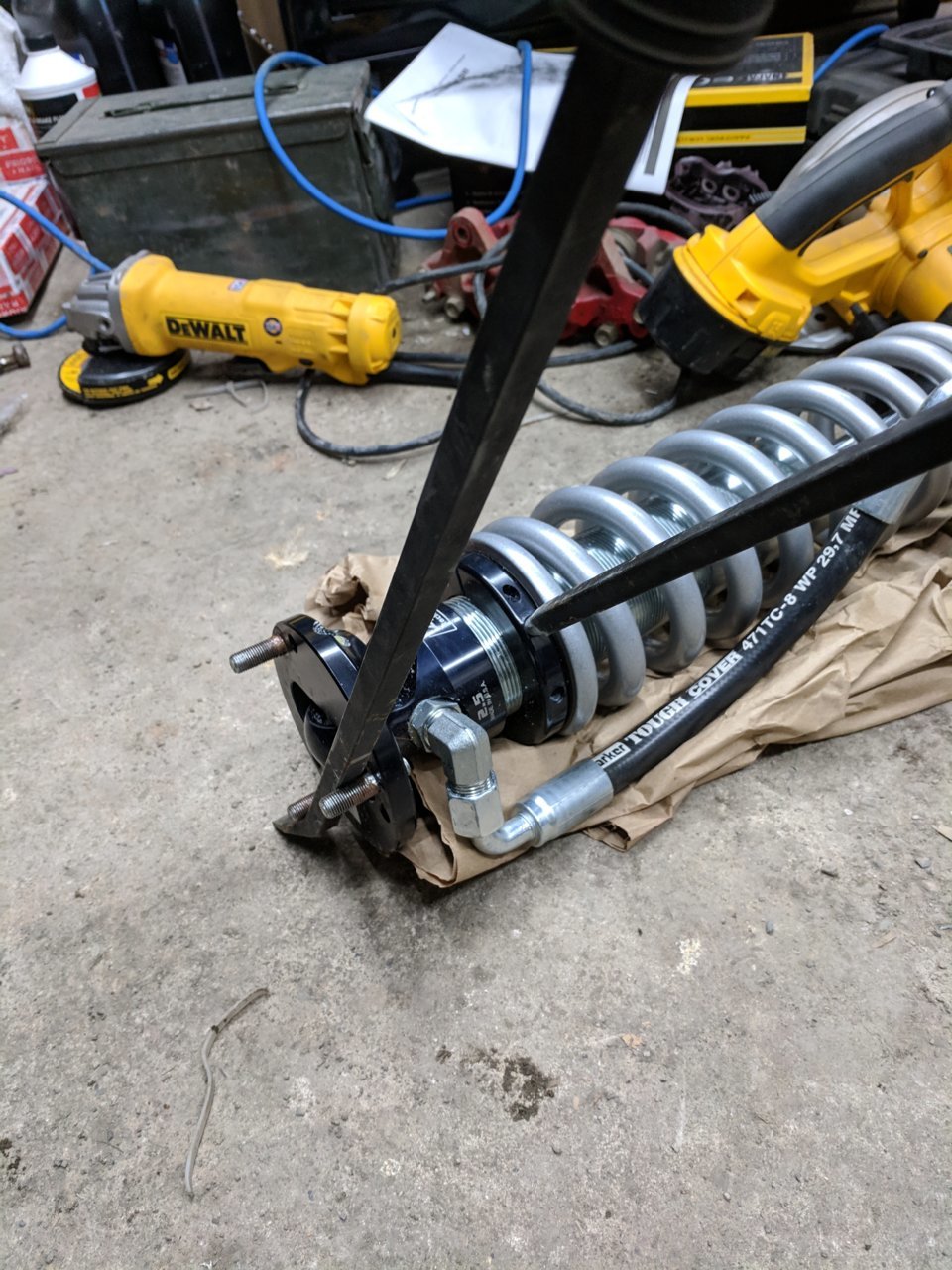

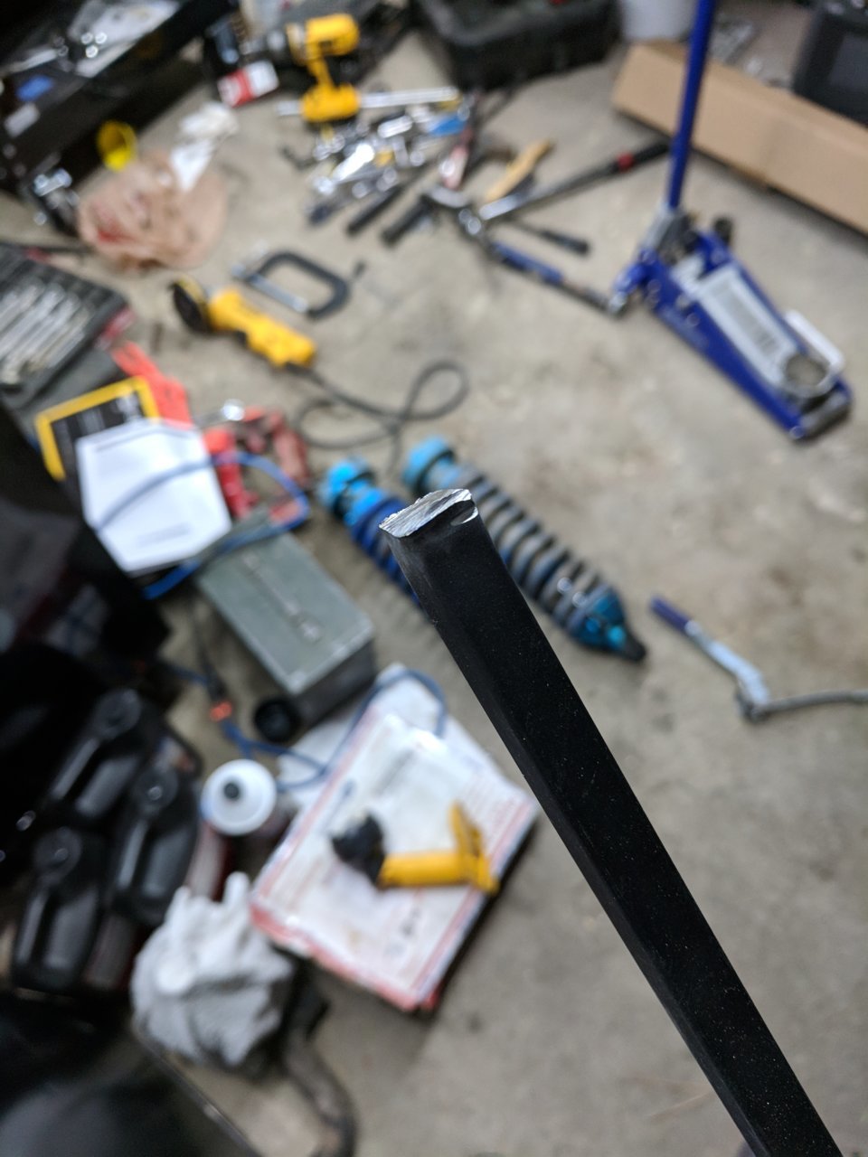

    Decided to lower the shocks. Was too tall and I like rake. Plus CV angles were not good.

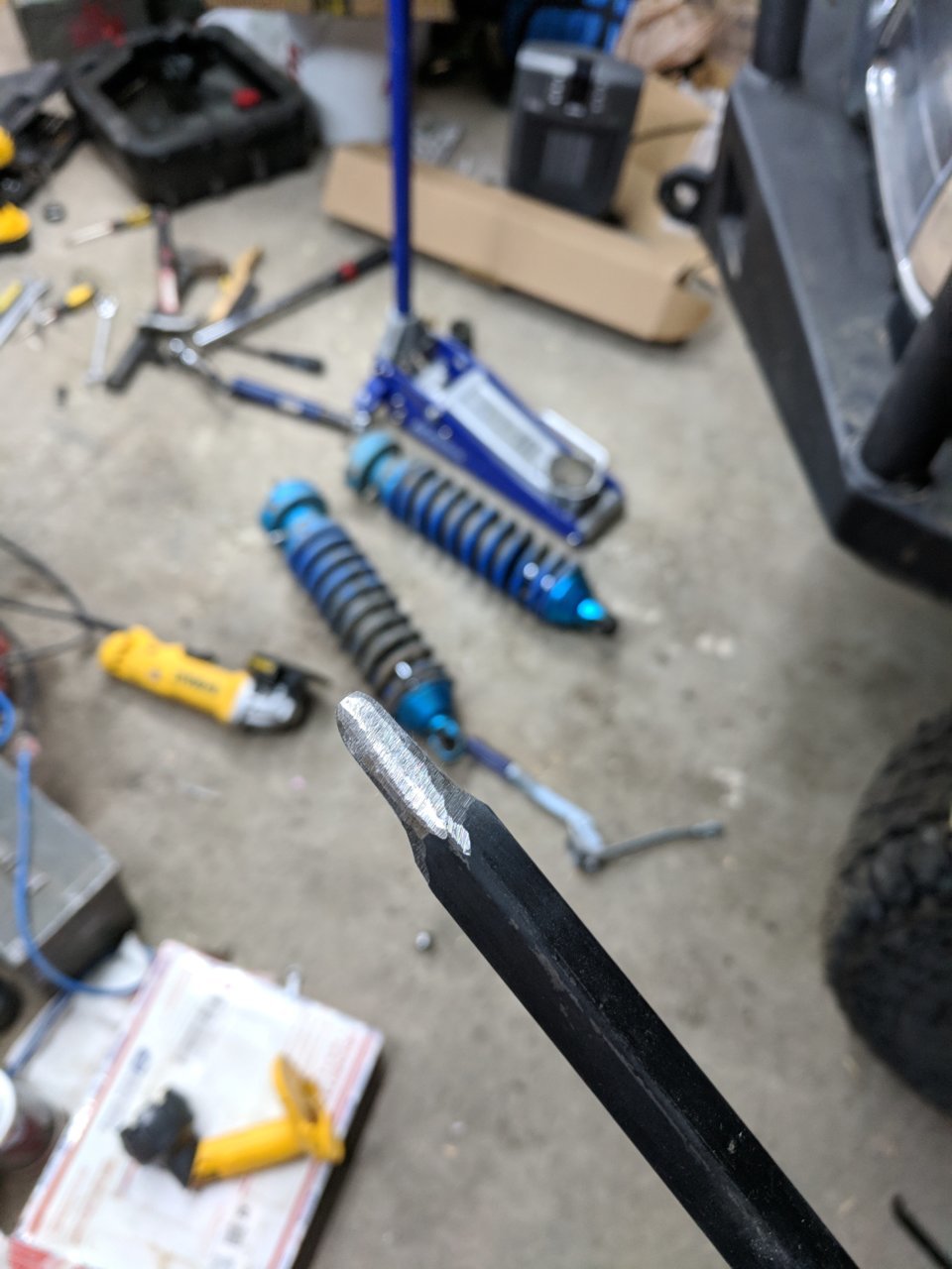

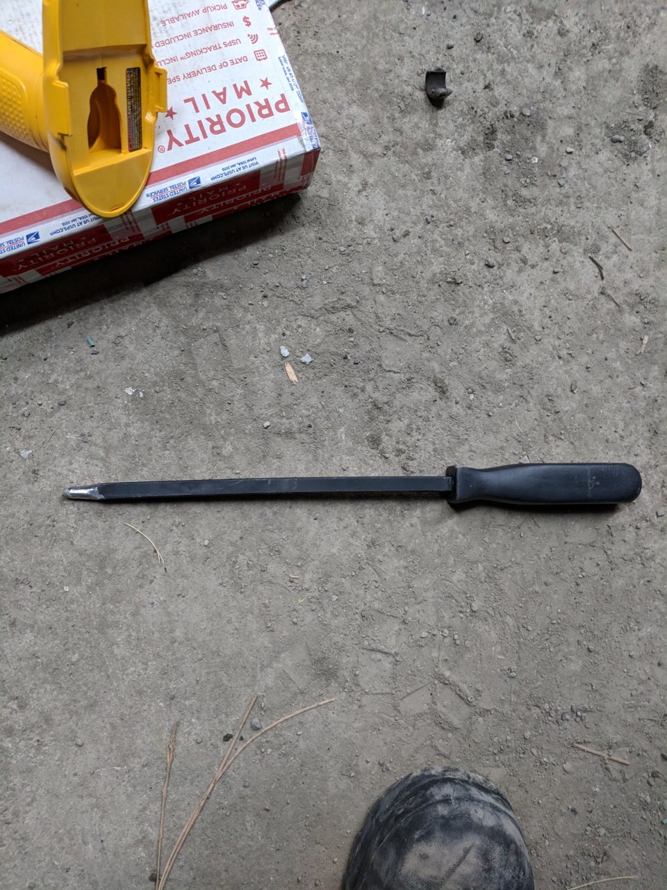

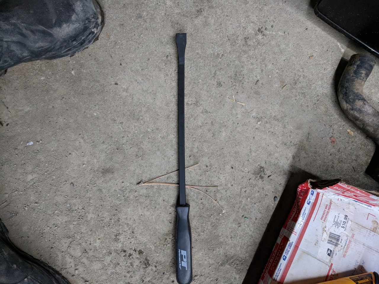

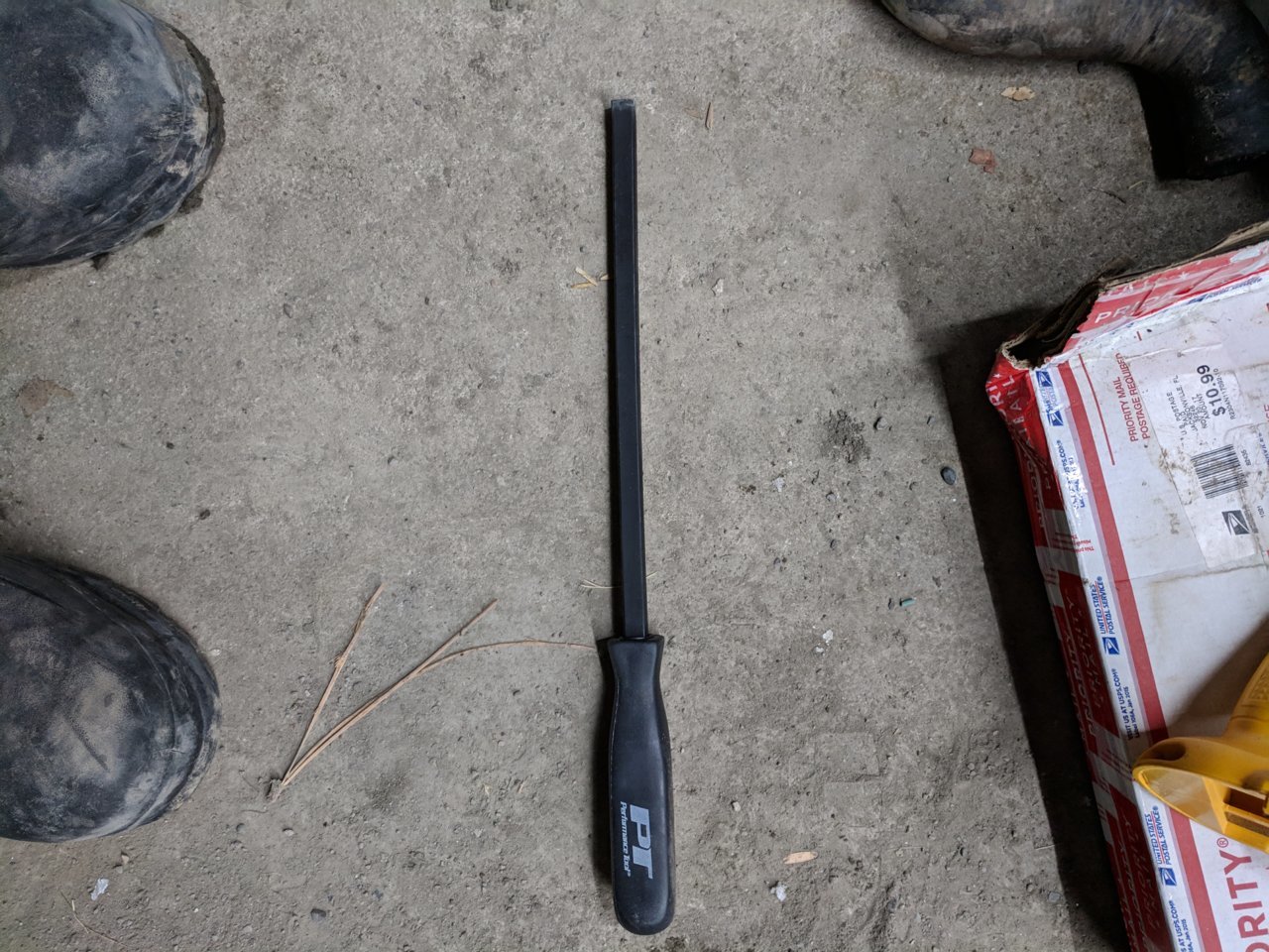

    I don't have a scanner wrench so I made one. I bought a 3 pack or something of some pry bars on a whim the other day. I choose the 14" one or so as I had two and wouldn't miss one.
    Then I cut the bent tip off...which in retrospect I shouldn't have..more on that in a bit.
    Then I started grinding it down to a rounded point. I wished to god I had a bench grinder for this. Would have been quick work. Or at least a vise..I just free handed it though. Used the king's as a template to make sure it fit well.
    Not bad! Plus handy tool for later.

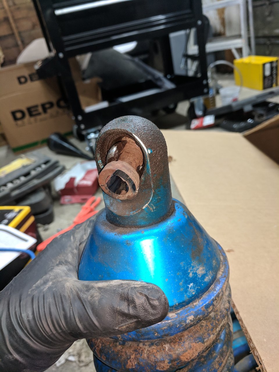

    Then instant regret. Sort of. I had to pull the driver side shock to get to the ring bolt. Then I installed it again so it would be held in place while I twisted the ring. Worked perfect! Suoer easy to turn. Didn't bend at all unlike basically every other tool I've tried to do this with that's supposedly designed to do it. Save your money! Cut up a $6 prybar!
    However. Don't cut off the bent tip. I should have just cut off the flat part and then ground down the bend end to fit the hole. This would allow me to turn the ring further than I could with it straight. Due to the design of the ring I couldn't turn it far enough to get to the next hole past the clamp bolt.
    Damn.
    So out the coilover came and used another longer prybar to leverage it still and easily cranked the coilover.
    Then cranked away.
    Video:
    https://photos.app.goo.gl/TQz6a5qehPNPwCZG8
    Repeated on the other side.
    I think I'll go buy another pry bar and make an angled one as then I could easily do this with the shock in the truck.

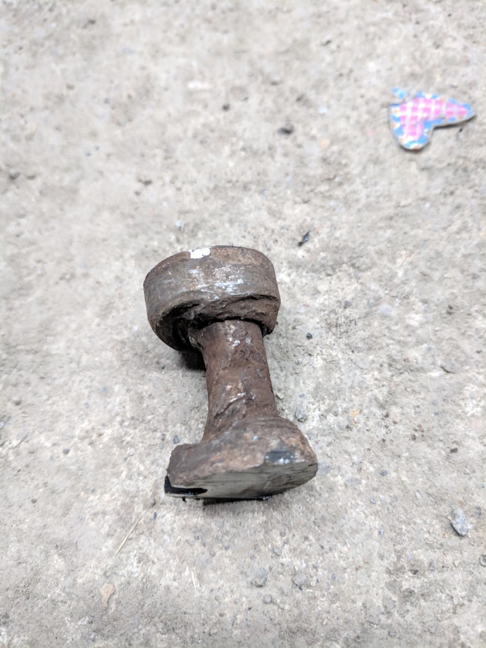

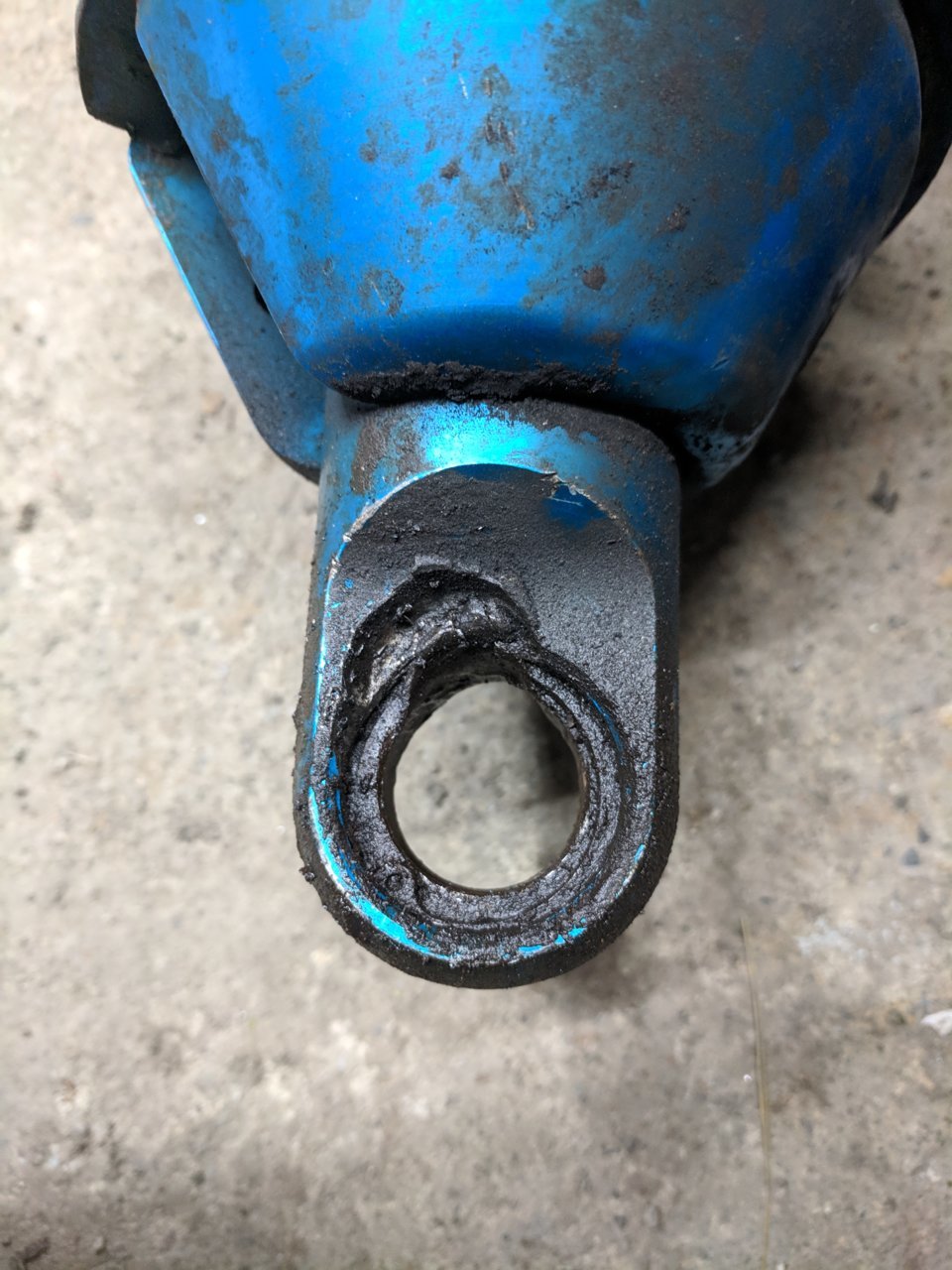

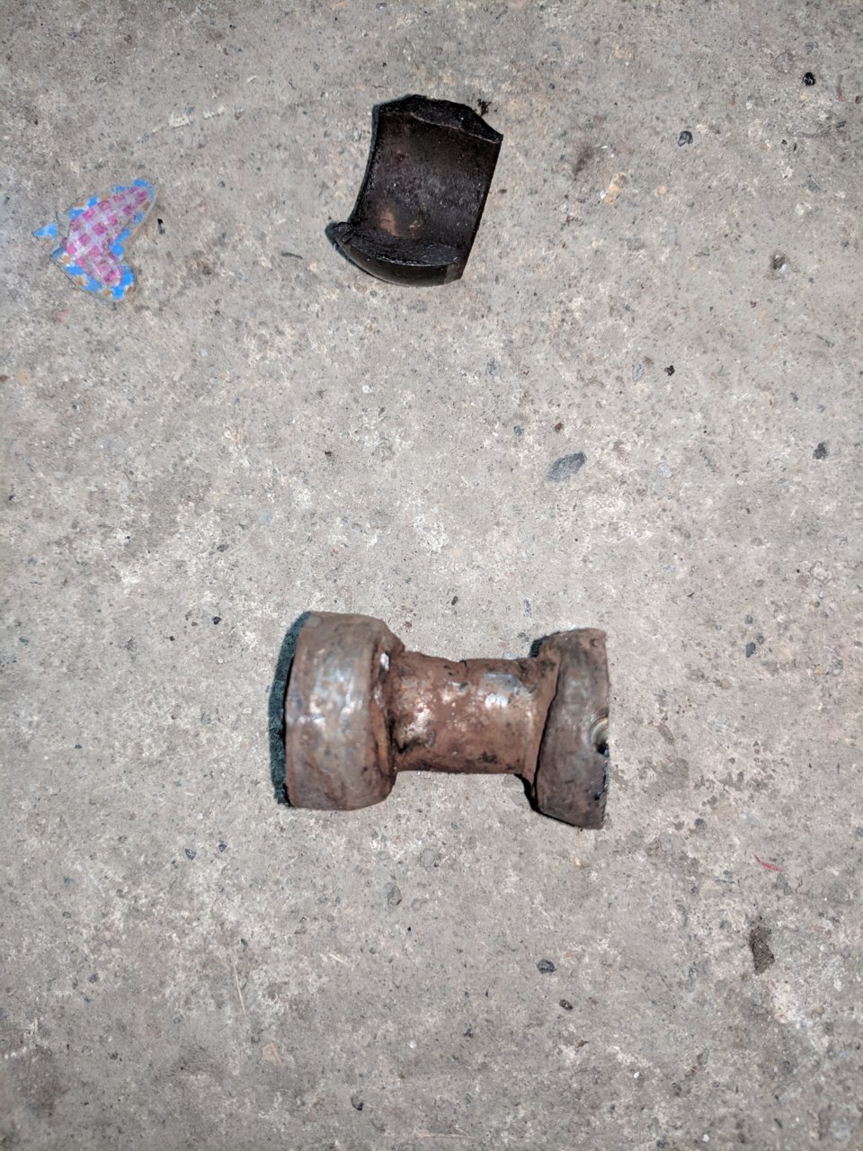

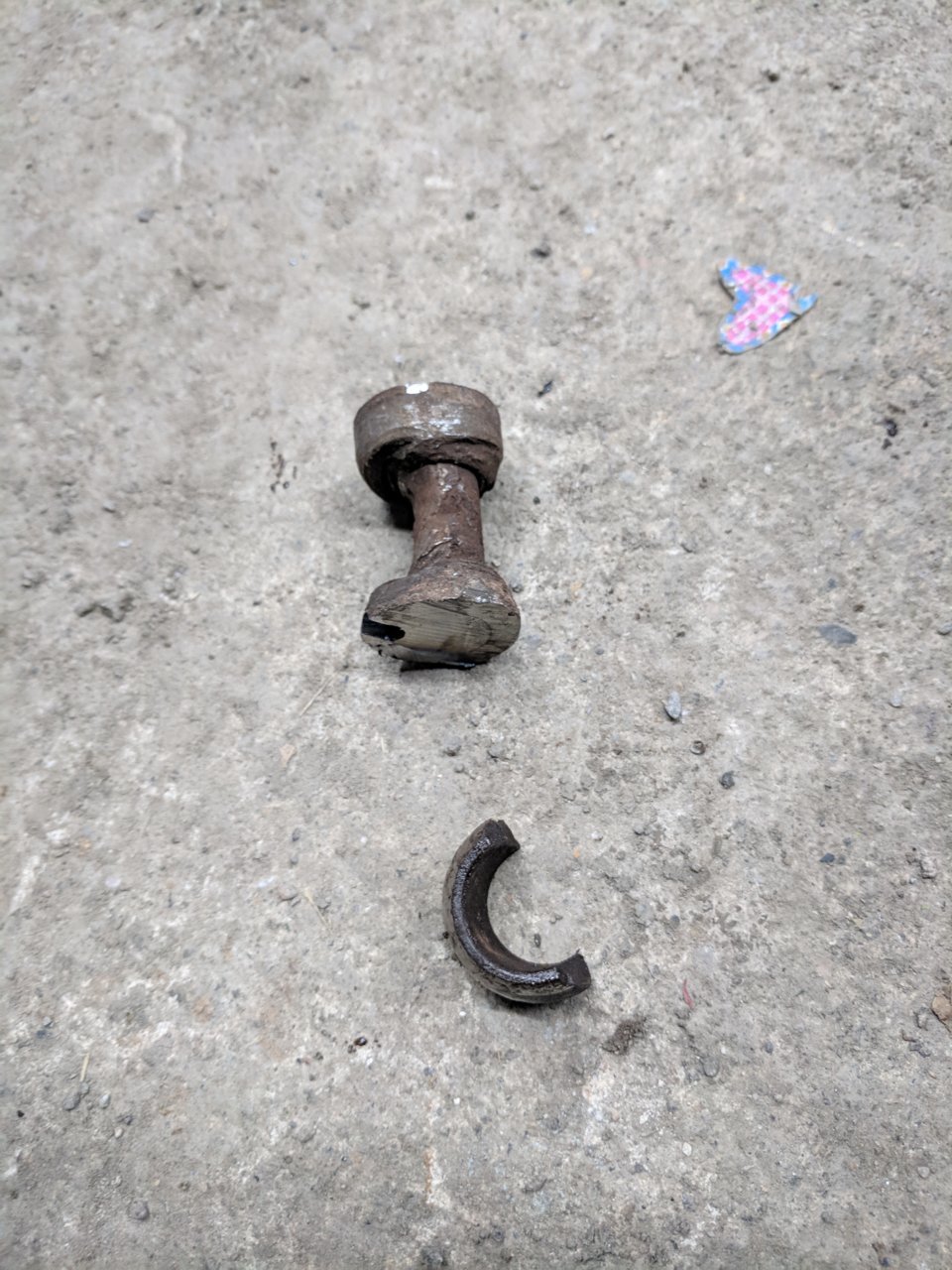

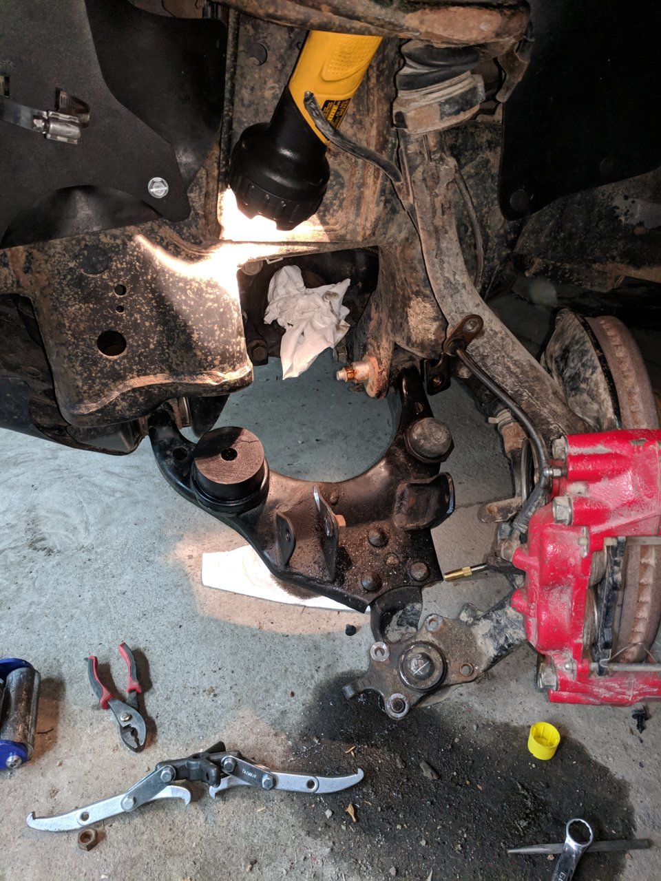

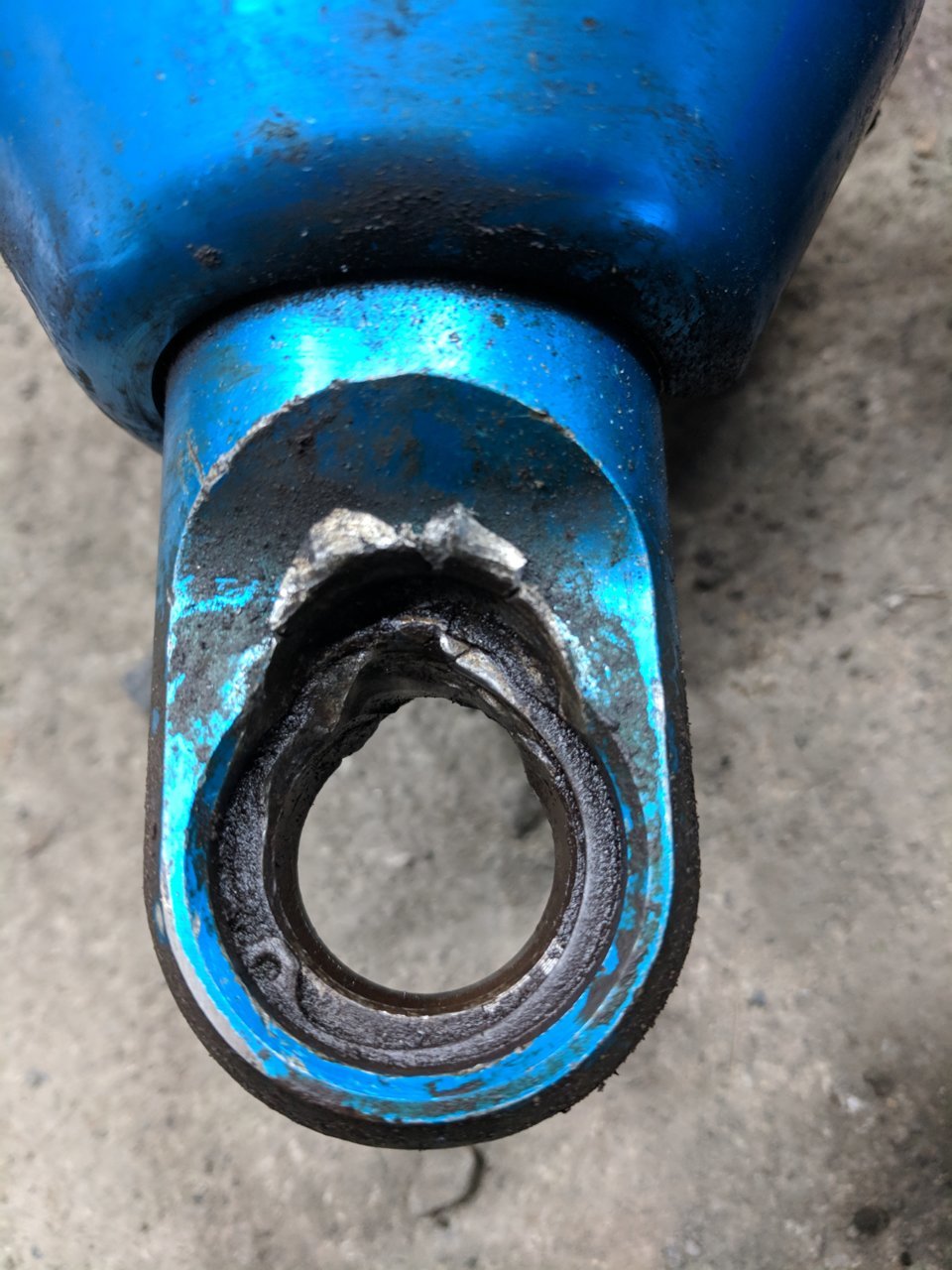

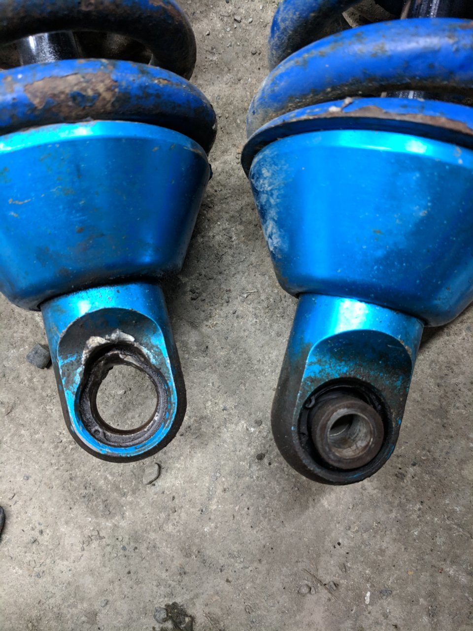

    However. My lca bushings are going out. This one's kind of gone..
    Video: https://photos.app.goo.gl/GWQGqCyFJmKF5k1T7
    So. Now have to do that. Thinking of doing solo lcas purely due to the better bushing design. Likely do cam tabs gussets too.

    Theres nothing left of that bushing. :eek:
    Weren't you having issues with alignments and killing front tires?

    Yeah not good..
    No that's what's odd is it aligned fine haha I killed some tires after hitting the deer and not getting it to the shop soon enough.
    However I have had issues with it wanted to change direction when braking hard. Would pull to the left. I thought it was a leaking caliper which is why I replaced it last weekend which is what started this whole fiasco.
    Story of my life..

    Taking pre-load out is always way easier than dialing it in. Especially on threads that don't have thousands of miles of cred/build-up on them.
    Very kool idea for the tool mod tho.

    Well ordered solo lcas. Hopefully get powder coated early next week and show up at my dad's place before I get back.
    Trying to decide if I should get all new cam bolts too..

    Yes I could have. But I see it as worth it for the ease of the bushing swaps. And better bushings. And better alignment.
    That and I don't have time to do that swap. Hoping to be able to do this all in a day maybe day and a half if that.
    But whatever. Should be worth.

    Lower mount is 1" forward so adds a good amount of castor but doesn't push the tire into the firewall. I haven't been able to get positive castor since the king's went on. So now I will.
    Yeah my short years in Missouri did their toll..
