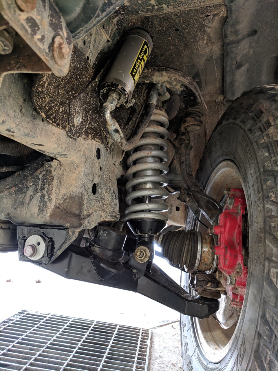

    Pulled an all nighter to finish this project. Man forgetting the lug key really screwed me over.
    Stuff looks good though. Made my alignment appointment right on time.
    The lcas added about 2° castor. Pretty nice. Drives great now and no more hard pulling while braking! I also pets the shocks extend a lot easier. Gonna beat the hell out of the coils as the spindle contacts it pretty good. Ucas will happen sooner than later. Should give me 4° built in castor but the wheel will be centered so that will be nice.
    Few complaints about the lower and the TC gussets but I'll elaborate on that later. Have to drive to work now. Gonna be a long day!

    Photo of the end.
    Front end is looking sweet I'd say. See how it performs over time. Just need ucas next. Then on to the rear..

    Doesn't look like it fits right to me. #toooClean

    That's kind of weird to think about. I know old LCA cams can be frozen and may therefore bushing may be able to bind too. But if that is what was happening on your truck, it would mean they were limiting extention of the coilover and I don't see how that is possible. :notsure:

    Hmm I don't think so. Has rake still right now which is what I wanted. Might be a bit taller possibly. I'll have to look closer at where the uca sits. That's how I generally judge the height vs the tire to wheel well.
    Psh fits great!
    Wow. Did you upgrade to something else? Is the upper joint the original design or the new one?
    man I had to freaking lean on mine to get it off. But worked great. Couldn't get the grinder to the driver side rear one by the rack(didn't fully pull the rack) and it still cut through the welds. So worth it.
    That's possible. Though on the drive to the shop it should have reset the coils a bit. Mike is right though on the bushings more likely binding.
    I know mine now move 100% better than before. With ucas I'll definitely need to add limit straps. Spindle smacks the coil over now
