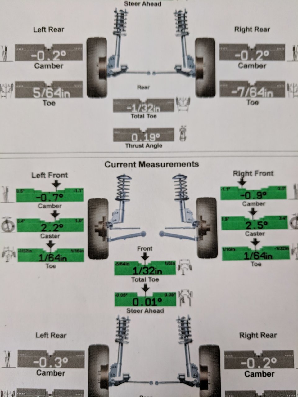

    Do you have a spec sheet from the alignment that you can post?

    The Trifecta of Taco's
    Looks just like Ben's kind of. Think he had a bit more castor but I'm on stock UCAs so that's cool.
    Ben out of curiosity what are your cam tabs turned at?

    2002 XtraCab TRD 4x4 SCv6 AutoTrans With Lots of Mods ADS COs w/Compression Adjusters Camburg Uniball UCAs Whiteline Lower Control Arm Bushings Kartek 7" Limit Straps Plastics Guy Front Bumpstops Total Chaos Sprindle Gussets Custom Alcan Springs +800 lbs +3" ADS 10" Stroke Triple Bypass w/Resi Rear Shocks Custom Rear Shock Relocate All-Pro U-bolt Flip w/Timbren Bumpstops 4.88 Nitro Gears ARB Front Locker ARB Twin Compressor Black 17x8 Konig Countersteer Type X 285/70r17 Falken A/T3w Gunmetal 16x8 SCS Ray10s 255/85r16 Maxxis Bighorns Limited Edition (Relentless) Elite Front Bumper Smittybilt X2O 10K Winch Diode Dynamics SS3 Sport Selective Yellow Fog Lights in the Bumper Diode Dynamics SS3 Pro 4,000 Kelvin SAE Driving Lights with Clear Lenses on the Bumper Morimoto D2S Projectors XB35 Ballasts + 4300K Bulbs Badland Sliders FrankenFab Tire Carrier Swingout bumper w/kitchen BudBuilt Front & Bellypan Skids BAMF Rear Diff Skid Dometic CFX 55im Fridge/Freezer Alpha II Hardshell RTT Badland Custom Bed Rack Denso 210-0461 105 amp alternator Dual Northstar 24F AGM batteries BlueSea 7622 ML-ACR Battery controller Peak DBI Dual Battery Voltage Monitor Haltech IC-7 Display with Mako Dash Insert Haltech Elite 2500 Standalone ECU Magnuson MP62 Supercharger w/URD 2.2" Pulley Doug Thorley Headers Denso 650cc Fuel Injectors Aeromotive Stealth 340 Fuel Pump TransGo A340F Reprogramming Shift Kit OEM ECU Delete Full A340F Trans Control with the Haltech 2500 ECU 2.5" Magnaflow Hi-Flow CAT Magnaflow 18" Muffler w/Vibrant Resonator 13WL Brake Calipers with OEM Rotors & Pads Braided Steel Brake Lines Kenwood TM-71A Dual Band Ham Radio STI-CO Flex Whip VFH/UHF 1/4 Wave Antenna Midland MTX275 GMRS Radio w/Roof Mount Antenna Pioneer DEH-P9400BH HU Alpine Amps & Type R components (F) and coaxials (R) Wet Okole Seat Covers Weathertech Digital Liners Deck Plate Mod 1" Diff Drop Carrier Bearing Drop
    Your caster is similar to his but that much negative camber would bother me. Potential for tire wear on the inside edge. Getting uppers may help to free that up but not sure.
    It is cool the lowers alone gave you 2 degrees of caster. How's it feel at 50+ mph?

    81,616
    Monte
    Wyoming/St. Louis
    good. Then I can get new tires :p though I can't decide wtf I wanna do about that..
    Is a bit much. But not gonna kill me.
    Feels great. Drives nice. In fact today I told Devin I don't think the trucks ever driven better. Mostly with how it cycles and handles bumps. Theres no more dartyness or anything. Just floats through stuff much more solid feeling and plush. Rear still bucks here and there. Deal with that latter hopefully this year.
    Here is my most recent spec sheet.

    very nice! Never had that much castor ever on any rig. Think Frank has a side that goes to 3º but the other is 2.5ish I think(bent frame I think) camber is all fucked too. Towers are tweaked.
    I've never been able to get positive castor out of Igor ever since I lifted him an inch. Crazy...
    Hopefully UCAs help a bit. Probably have 3-4º easy.

    Your front camber is nothing, I wouldn't even give a second thought to tire wear from that, it's a bad toe that really eats the tires away.
