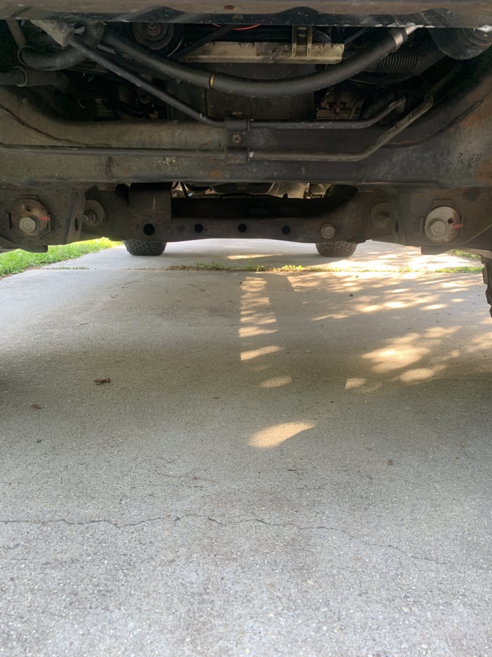

    I’m curious if the whiteline urethane LCA bushings some people have swapped to on the stock control arms have the same effect on ride quality that you have experienced with the new LCAs. I believe the stock rubber bushings allow the LCA to move around too much and negativity effects ride quality.

    Cool. So I guess it’s worth doing then. Hopefully they will also help with alignment a little. I think mine are a little seized up. This is what my cams look like. My alignment is still in spec and almost identical on both sides so I’m not sure why they’re not equal.

    There’s probably a reason solo didn’t include that. Maybe a greasable bolt is weaker since it’s partially drilled out?
