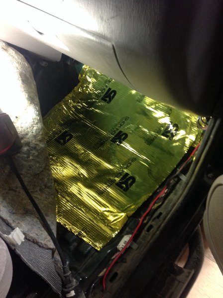

    Slapped some shock industries sound deadener down in the foot wells. New tires are too loud. And my dad had some left over. Plan on getting the ram audio stuff later for the doors and more. Hopefully this will help a bit for now.
    gray223 likes this.

    Love that stuff, maxx's are too loud???

    For me. I'll admit I'm sensitive to noise though being an audio guy. But they aren't as quiet as what Id hoped for. My dads hankook ATMs are what Id hoped for. Those things are quiet. They'd have plenty of noise. Km2 like
