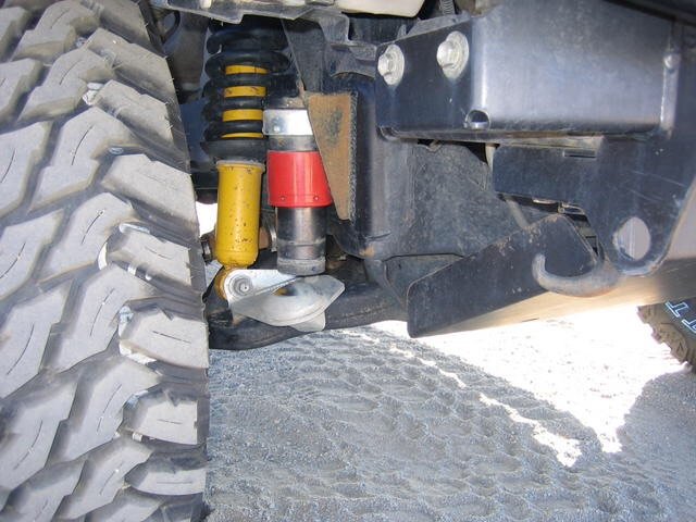

    Build Update: Wheelers Superbumps Front and Rear
    In preparation for my trip to Utah, i wanted to spruce the suspension just a bit in hopes i could romp Igor through the smoother stuff. I already had the Kings up front and Foxes in the back with Alcans. So bump stops seems like a good way to go.
    I really liked what they did to Frankenstein when i installed them on him(here). So i bought the kit again from Wheelers and i bought their front kit.
    The front kit is NOT made for 1st gen Tacomas. Its for 2nd gens. But ive seen a few on here fit them in various ways and had an idea on making them work i wanted to try.
    I started with ideas for the front and grabbed my old stock LCA from Frank for some RND.
    [​IMG]IgorsBumps-2.jpg by Monte Nickles Photos, on Flickr
    The stock ones just un screw pretty easily, just need a wrench that fits, found a pipe wrench works great.
    [​IMG]IgorsBumps-3.jpg by Monte Nickles Photos, on Flickr
    The stock bumps are different sizes, the front ones are larger in diameter and a tad taller too.
    [​IMG]IgorsBumps-4.jpg by Monte Nickles Photos, on Flickr
    The Wheelers bumps are massive in comparison. I also have another bump, an ES Foam one i believe that is another popular option for people to swap in. But you have to drill and tap the LCA or the frame due to different threads.
    [​IMG]IgorsBumps-5.jpg by Monte Nickles Photos, on Flickr
    [​IMG]IgorsBumps-6.jpg by Monte Nickles Photos, on Flickr
    [​IMG]IgorsBumps-7.jpg by Monte Nickles Photos, on Flickr
    This show cases one of the bigger problems with these up front. They are so tall that at ride height you are in the bumps. Granted they are very soft and don't limit down travel but do change the ride a lot. They also don't hit straight on. The biggest problem with using them as seen here.
    [​IMG]IgorsBumps-24.jpg by Monte Nickles Photos, on Flickr
    This is where i decided to try something different then what most had done. Usually people from what i have read had just cut 3/4-1.24'' off the bumps. Which helps but still doesn't make them hit square.
    I found a place to get 1' of UHMW the same diameter(3.25'') as the lower part of the bump on ebay. http://www.ebay.com/itm/221557297720?_trksid=p2057872.m2749.l2649&ssPageName=STRK:MEBIDX:IT
    [​IMG]IgorsBumps-9.jpg by Monte Nickles Photos, on Flickr
    Then I roped my Dad into helping me with is wood shop tools.
    I decided to make shims to angle the bumps more into the truck, I started with 1/4'' on one side with a 1/4'' rise. We sketched it out on a square block to set the angle on the band saw for later.
    [​IMG]IgorsBumps-10.jpg by Monte Nickles Photos, on Flickr
    [​IMG]IgorsBumps-11.jpg by Monte Nickles Photos, on Flickr
    Then we had a problem, getting a perfect 180º cut on a round chunk of material is basically impossible. My dad suggested planning it so it had flat edges. We tested the idea on some wood first.
    [​IMG]IgorsBumps-12.jpg by Monte Nickles Photos, on Flickr
    [​IMG]IgorsBumps-13.jpg by Monte Nickles Photos, on Flickr
    This does a few things. It allows us to use the flats as guides on the band saw and it allowed me to easily find the center for drilling a hole later.
    So we did it to the UHMW
    [​IMG]IgorsBumps-14.jpg by Monte Nickles Photos, on Flickr
    [​IMG]IgorsBumps-15.jpg by Monte Nickles Photos, on Flickr
    [​IMG]IgorsBumps-16.jpg by Monte Nickles Photos, on Flickr
    Then cut the angled shim out and then a second one easily.
    [​IMG]IgorsBumps-17.jpg by Monte Nickles Photos, on Flickr
    [​IMG]IgorsBumps-18.jpg by Monte Nickles Photos, on Flickr
    [​IMG]IgorsBumps-19.jpg by Monte Nickles Photos, on Flickr
    [​IMG]IgorsBumps-20.jpg by Monte Nickles Photos, on Flickr
    Looks promising. So I drilled some holes.
    [​IMG]IgorsBumps-21.jpg by Monte Nickles Photos, on Flickr
    Again, looks promising.
    [​IMG]IgorsBumps-22.jpg by Monte Nickles Photos, on Flickr
    While i was doing this i cranked up the coilovers a bit too as i knew id need to for the bumps and of course the new tires.
    [​IMG]IgorsBumps-23.jpg by Monte Nickles Photos, on Flickr
    [​IMG]IgorsBumps-26.jpg by Monte Nickles Photos, on Flickr
    And here it is mounted
    [​IMG]IgorsBumps-25.jpg by Monte Nickles Photos, on Flickr
    Was a PITA. The wrench is small and not a lot of room. But i sucked it down as hard as i could, the bolt cut threads into the shim and a bit into the spacer itself. Felt very snug and i didn't want to have them rotate.
    I could tell that it needed trimmed still though. So i took them off and cut 3/4'' off.
    [​IMG]IgorsBumps-27.jpg by Monte Nickles Photos, on Flickr
    Looks better..
    [​IMG]IgorsBumps-28.jpg by Monte Nickles Photos, on Flickr
    I ultimately decided to run with it but cut another set of spacers that was only 1/8'' on the short side and 3/8'' on the tall side. At ride height, im not in the bumps, but close. They still hit at a small angle but i think this is a good mix. If i angle them too much then at full stuff they won't compress right.
    This is the front at ride height.
    [​IMG]IgorsBumps-34.jpg by Monte Nickles Photos, on Flickr
    I also got the rear kit and had the 1/4'' WHeelers spacers left over and decided to put them on. Which i regret and will be removing them when i redo the leaf packs.
    [​IMG]IgorsBumps-8.jpg by Monte Nickles Photos, on Flickr
    Also added some Allpro Axle relocation plates. I could tell id have too with the small tires to fit the new 255s on.
    [​IMG]IgorsBumps-29.jpg by Monte Nickles Photos, on Flickr
    Install is pretty straight forward, the Frankenstein link shows some more details, but this install did have some tricks.
    The plates just go on the bottom of the axle, i used the 3/4'' hole.
    [​IMG]IgorsBumps-30.jpg by Monte Nickles Photos, on Flickr
    Using this though, creates and issue with the rear bumps. They use the stock U bolts to hold them down. But since im moving the axle i need to move the bumps.
    Nothing a die grinder can't fix.
    [​IMG]IgorsBumps-32.jpg by Monte Nickles Photos, on Flickr
    [​IMG]IgorsBumps-33.jpg by Monte Nickles Photos, on Flickr
    Since ive come back from my trip before i wrote this i can say they are nice! My rear just needs major help all around and the bumps couldn't fix the problems single handedly. The front though felt great most the time. Was great on high speed and in the rocks. But i can't give a great review on them as i haven't offroaded without them. Thinking of taking them off to see what its like.
    I also left the rear front bump on as the super bumps are so soft it'll go too low. Granted my shim may be enough but i just left it after reading the super bumps would compress too much.
    On to the next mod!

    Deal man. I have tons of UHMW left.
    I have no idea how you will fit hydros on a stock LCA. Though I swear I've seen photos of it done. If I recall correctly it had a strike pad welded on that was extended away from the stock LCA a bit as clearances are so tight.

    Something like this
    That's not a tacoma but you get the idea. @Squeaky Penguin

    I'm envisioning the back of the LCA, where the sway bar mount is. I have grinders and a welder. It'll either work or it won't.

    Hmm Id go off the front id think due to the steering. Why everyone does hydros up front on lt kits.
