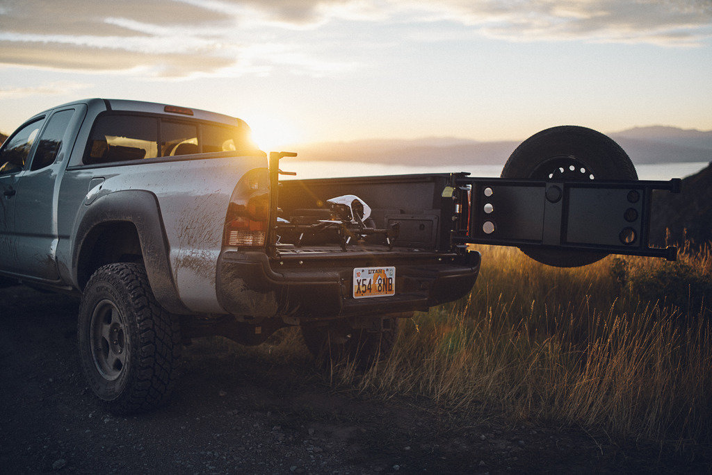

    - a Wilco Offroad Tiregate VT. Super stoked on it. Feels very solid and I'm glad to finally have my spare out from underneath. I have another Cooper ST Maxx and an SCS F5 wheel on the way for next week.

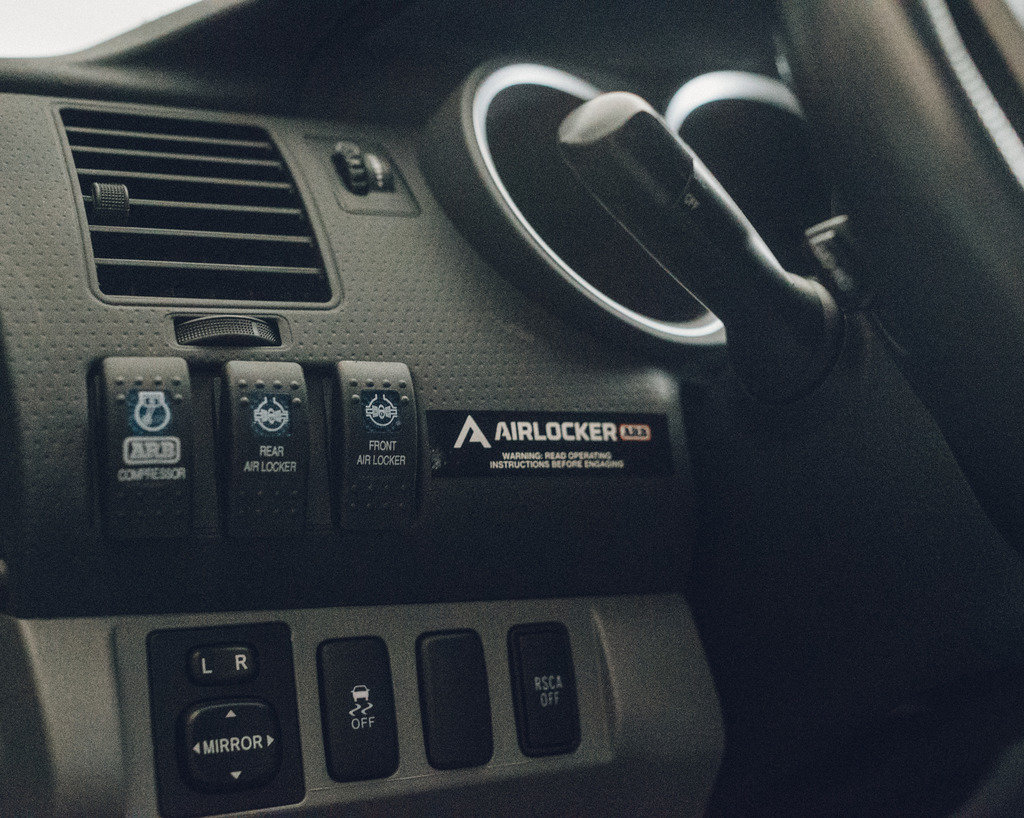

    I've got a ton to get done this next week. I got my compressor mounted and wired up, but I need to install my rear ARB locker and 4.88 gears, plus find some time to add some OME spacers to my front coils to get rid of my rake and get my full size spare put together. Too busy to work, I need to just stay home and work on my truck. haha

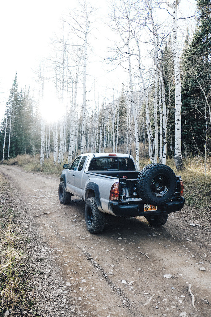

    Got my full size spare mounted on a @SCSPerformance F5 wheel (Thanks Vin!) and installed on the Wilco Offroad Tiregate VT.
    Also took the Tacoma over to spend some time with @cruiseroutfit yesterday... very stoked.
