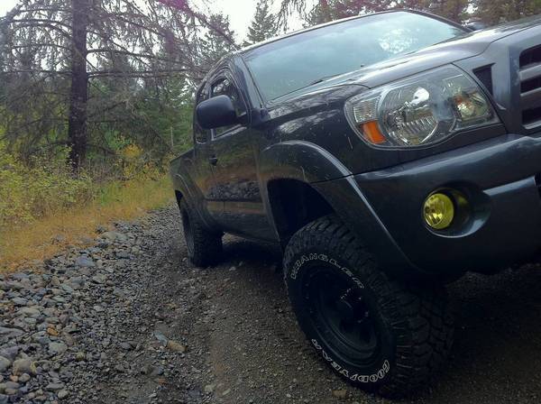

    Well I figured it was about that time, I finally feel I have done enough modifications to my truck to warrant it's own build thread.
    I have also received way to many wheel questions, so I figured it would just be easier to point people here than answer questions every time.
    I still have to gather up the various photos from all the mods and different states, but this should be a good start.

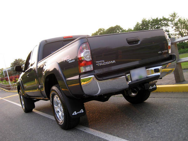

    May 2009
    Just after I picked up the truck.
    [​IMG] [​IMG]

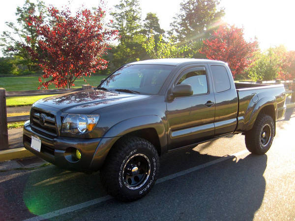

    Summer 2010
    Wheels and Tires
    [​IMG] [​IMG]

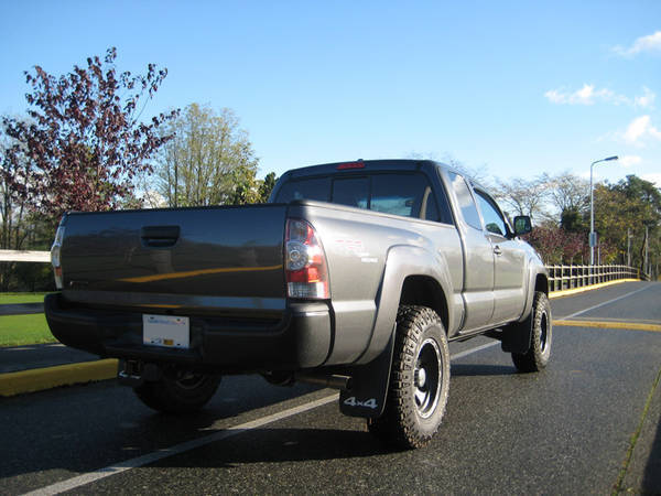

    Fall 2010
    Installed 5100s at 2.5 inches
    [​IMG] [​IMG]

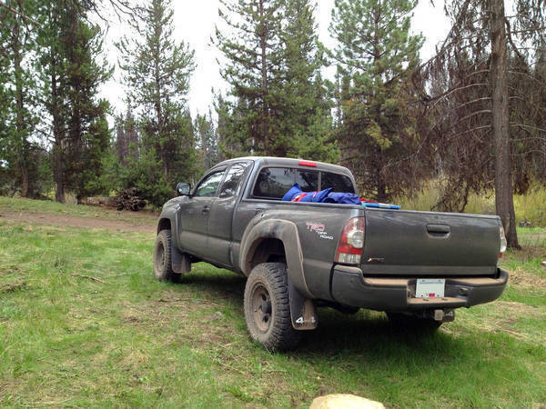

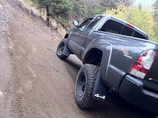

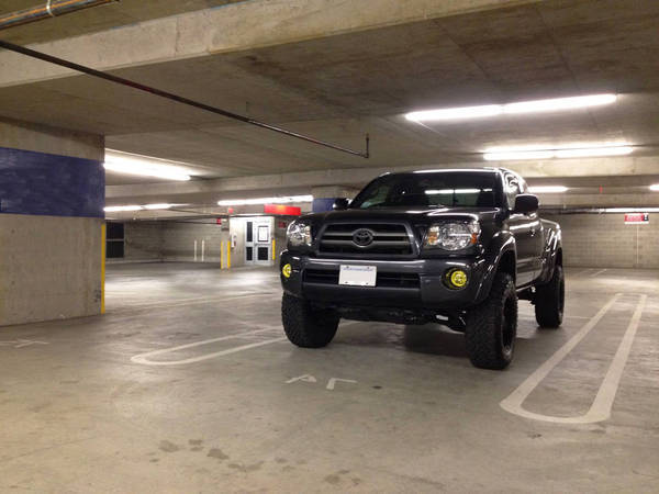

    Summer 2011
    Long after AAL install
    [​IMG] [​IMG] [​IMG]
    Summer 2012
    [​IMG] [​IMG]

    Looking good man! Quick question, did you just set the 5100s to 2.5 without installing an AAL, TSB, or anything else? I like the way your lift looks and I just ordered the billies
  13. May 12, 2011 at 10:20 PM
    ilg
    ilg [OP] VanCity Taco.
    May 5, 2009
    #16835
    646
    BC, Canada
    09 MGM TRD O/R 4x4 6-Spd
    WeatherTechs, Yellow Fogs, Alpine X-100 iPod Stereo, Custom Seat Covers, Debadged, Locking Bed Compartments, Black Front Toyota Emblem, AVS Vent Visors, Colour Matched Grill, TRD Shift Knob, Eagle Alloy 187s in 16x8 wrapped in 265/75/R16 Goodyear Wrangler Duratracs, Black Chrome TRD Badge on Tailgate, Black Rear Bumper, 8 in shorty antenna, 5100s @ 2.5.
    Yeah, the billies are at 2.5. No lift in the rear, although that is coming soon. The truck however is Canadian, so it comes from the factory with the TSB leafs :)

    Love the wheel and tire setup! Any spacers? Trimming?
  16. May 17, 2011 at 7:57 AM
    #16
    ilg
    May 5, 2009
    #16835
    646
    BC, Canada
    I just went to a local art store. It came in 14inch wide rolls and I ordered something like 16 feet (extra in case I messed up). Only cost about 15 bucks. The hard part was putting it on, but with some help and a heat gun (or hair dryer) and it should be fairly easy.
    Nope, no spacers, just the 4.5 backspacing on the wheels. I had to trim a little off the inside of the mudflaps when it was still stock height. But since the raise, it has not rubbed at all :)

    Looks real sharp!!! Any alignment problems with the 5100s at 2.5"?
  20. Sep 15, 2012 at 11:58 AM
    #20
    ilg
    May 5, 2009
    #16835
    646
    BC, Canada
    Nope, none at all!
