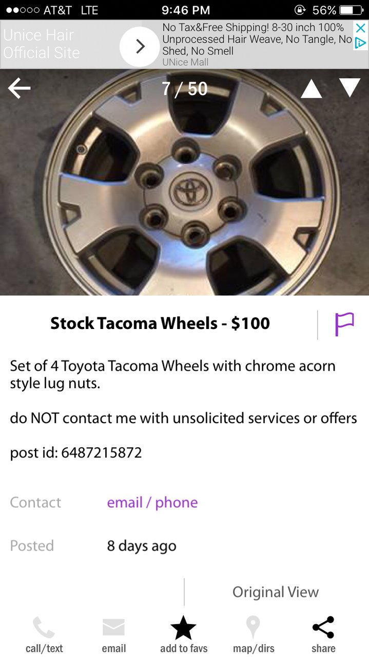

    Those wheels can be had for $100-$200 for all 4 any day of the week.So if the tires are $115 each new,I would say the O.P overpaid.

    There are on my local Craigslist right now

    Yeap.there are 4 sets for sale on the Las Vegas Craigslist for under $200,2 weeks ago they had 2 sets for $100 each set.Like I said any day of the week for $200 or less.You can get new Prerunner/TRD Offroad 2017/18 take offs with the tires for $600
