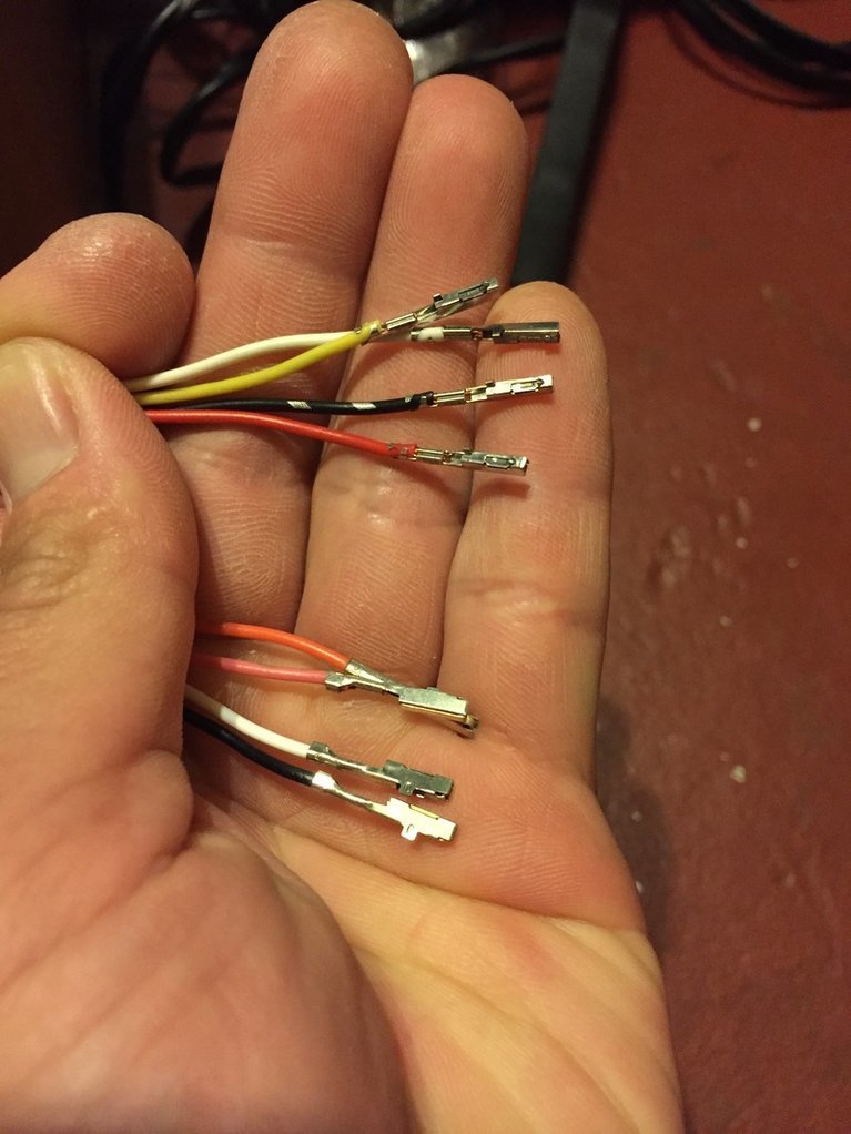

    That's not a bad idea! I've got an old CP I could rob a couple of pins out of, and splice the wire onto it. Putting a soldier gun (heat) on the old plastic harness connector will soften it up. You can then be able to pull the metal pin out without damaging it. Thanks MAcGyver!

    A few
    adio likes this.

    You awesome . Great mod.
    Yea after getting all the info from you and JdevTac its actually pretty easy

    I just hooked up to dome light circuit. Turns off when dome turns off . Got some extra terminals if you want some.
