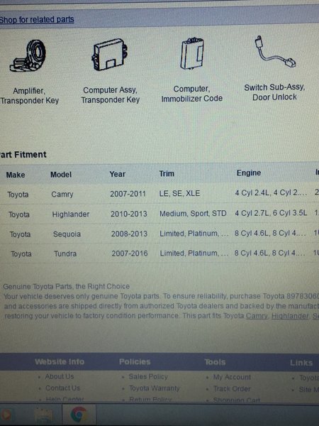

    My contribution to this thread as I try to find myself an amplifier ring. Did a google search and here are the toyota models with years that use the white amplifier part #89783-06021;
    ChadsPride and Old School like this.

    Does anyone know if part #89783-06020 will work? According to the web, 89783-06021 replaced 89783-06020.
