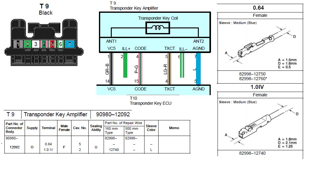

    I may have missed it but where can you get just the terminals without the wire for the pins
  12. Feb 21, 2019 at 9:01 AM
    #372
    caribe makaira
    caribe makaira Well-Known Member
    Feb 13, 2011
    #51121
    11,714
    Caribbean, Puerto Rico
    05 PreRunner TRD Offroad AutoTrans
    Hood Struts, My version Fogs always ON, Map & Overhead Light Mod,
    ..."sourced these from Mouser Electronics and was happily satisfied with their service, and was able to buy the pins in bulk to practice crimping. Part # for Mouser is 571-1123343-1."...

    Anyone have any extra terminals?
  15. Aug 29, 2019 at 1:17 PM
    #375
    Muddinfun
    Muddinfun Well-Known Member
    Apr 17, 2017
    #216500
    7,489
    There are 2 different size terminals in that connector. Make sure you get the correct ones.

    Crazy question I thought maybe one of you guys may be able to help out with...
    For Toyota connector #9098012092 (transponder amplifier connector) is there a female version of that connector that the factory #9098012092 can be plugged into? I've search literally for day. Thanks
